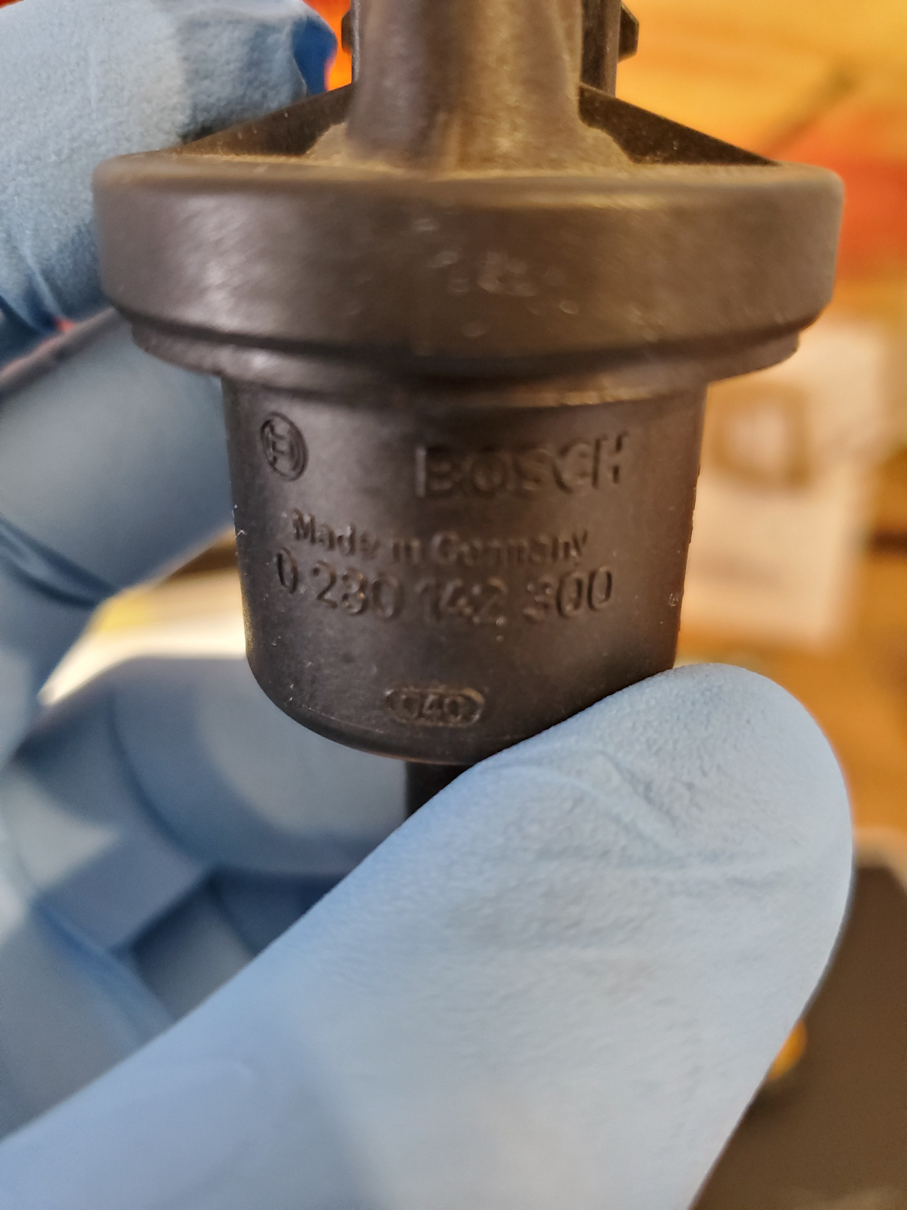

Alright boys, this is what I found.
This is located on the fan shroud, clipped to it via the metal bracket underneath, hidden inside. This is where I found it: This little guy was below it a little but still in the same general vicinity. Abscate, I think the part numbers are visible via the photos (they are on my end.) If you have any trouble reading them let me know and I will post them in plain text.
Do all of these lil guys need to be replaced, Richard? I'd love it if you could mail me a purge valve. I would be happy to pay for it, and your shipping costs. Thank you very much for the offer!

Richard, I found it. This is the purge valve that seems to be such a thorn in everyone's paw, huh?Richard99 wrote: 13 Mar 2020, 13:17 This is the purge valve you should be looking for. It is located under the air box intake tube.
https://www.fcpeuro.com/products/volvo- ... -9470775oe

Yes! That is it. Glad you found it. The tubing going to it looks fairly cracked. You may want to replace that tubing. I hypothesize that part of the reason for the failures is small black particulates getting inside the valve from old tubing.ShadyMilkMan wrote: 13 Mar 2020, 14:30Richard, I found it. This is the purge valve that seems to be such a thorn in everyone's paw, huh?Richard99 wrote: 13 Mar 2020, 13:17 This is the purge valve you should be looking for. It is located under the air box intake tube.
