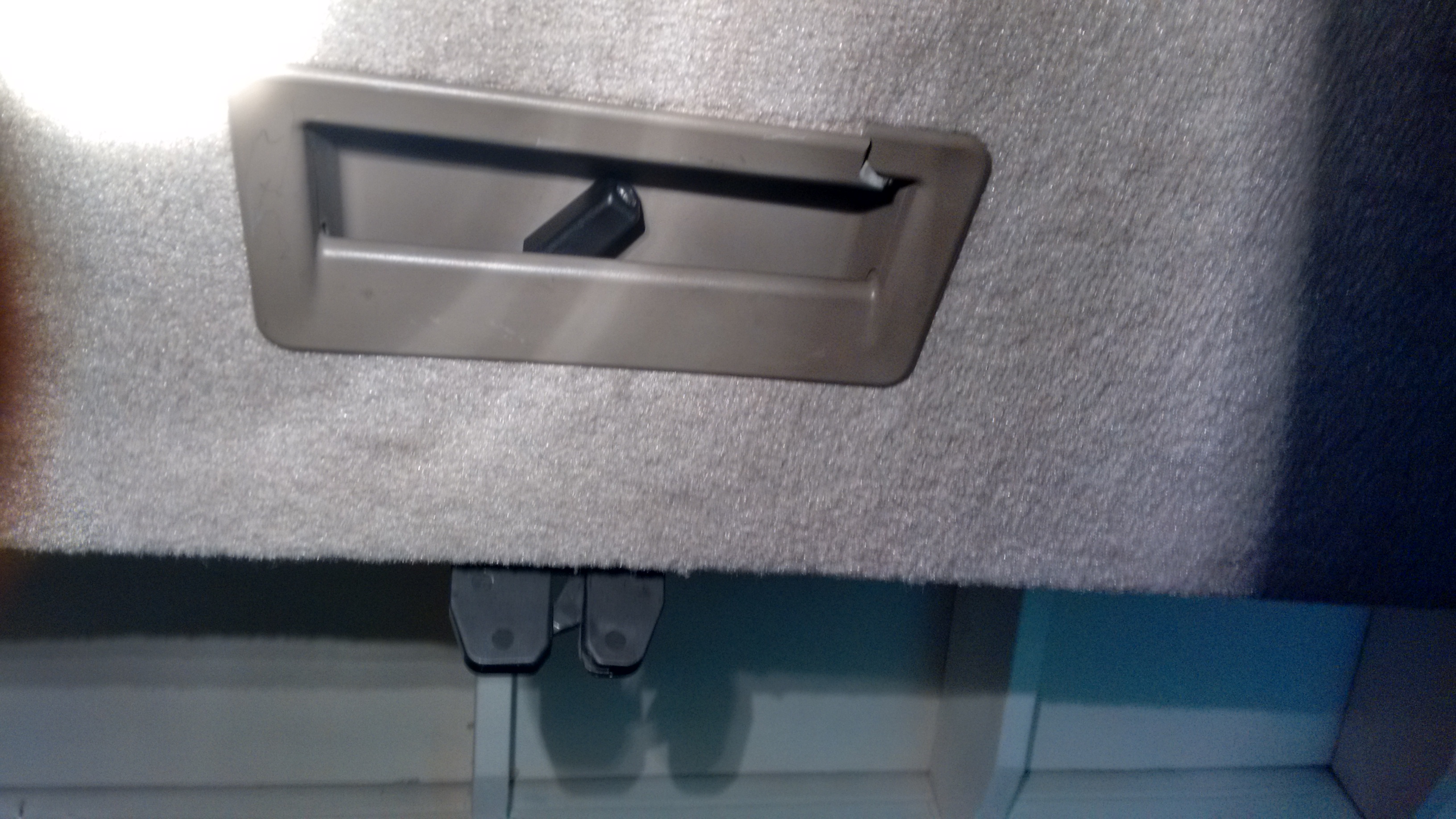

2. When I took the tailgate interior panel off yesterday, the small panel around the interior handle came off easily. Today, I tried to take this little panel off again, and it wouldn't budge! I tried from all different angles, using various tools to gently pry at. I eventually broke it! Ughhhh:
Is there a trick to this?
