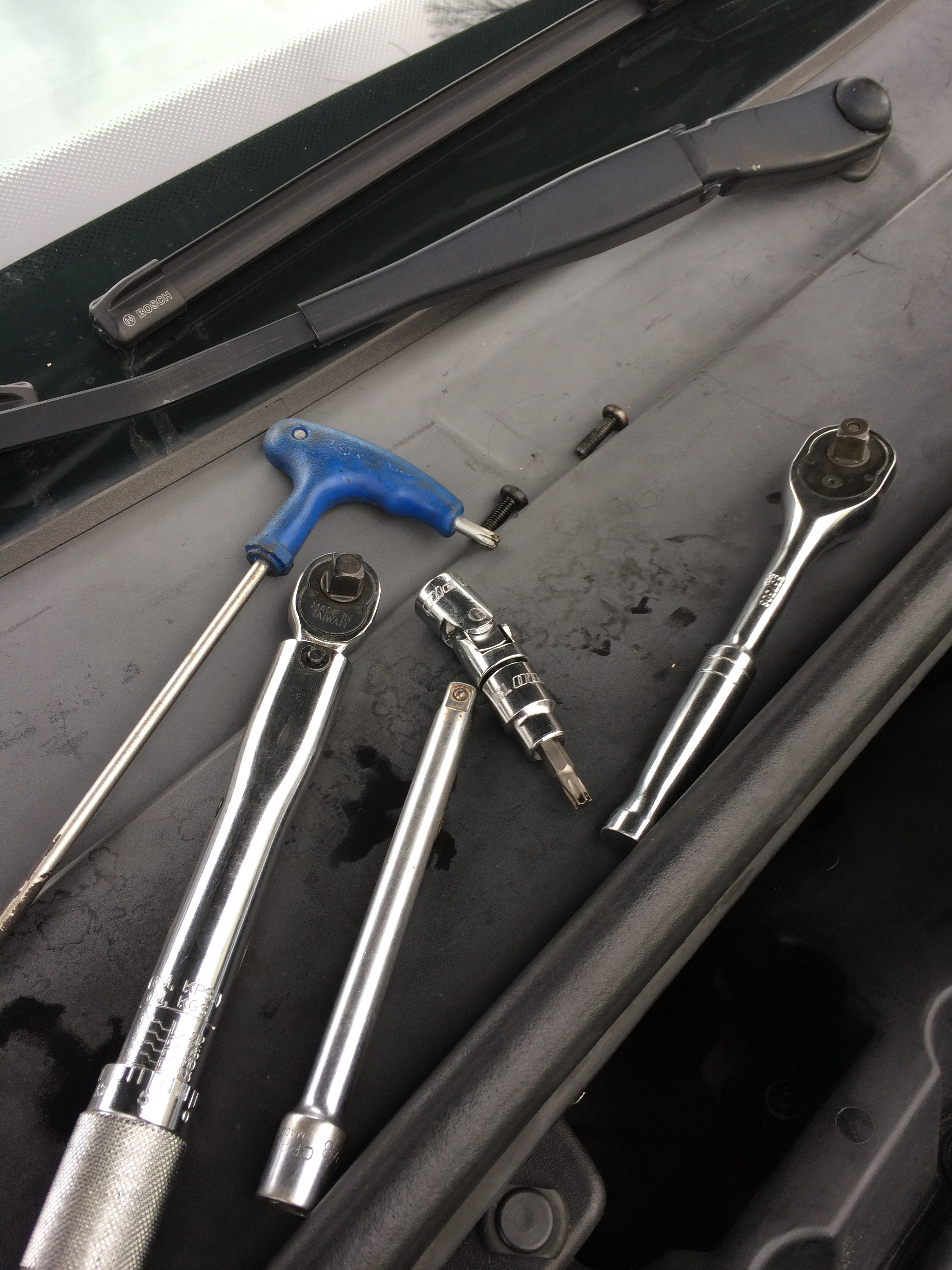

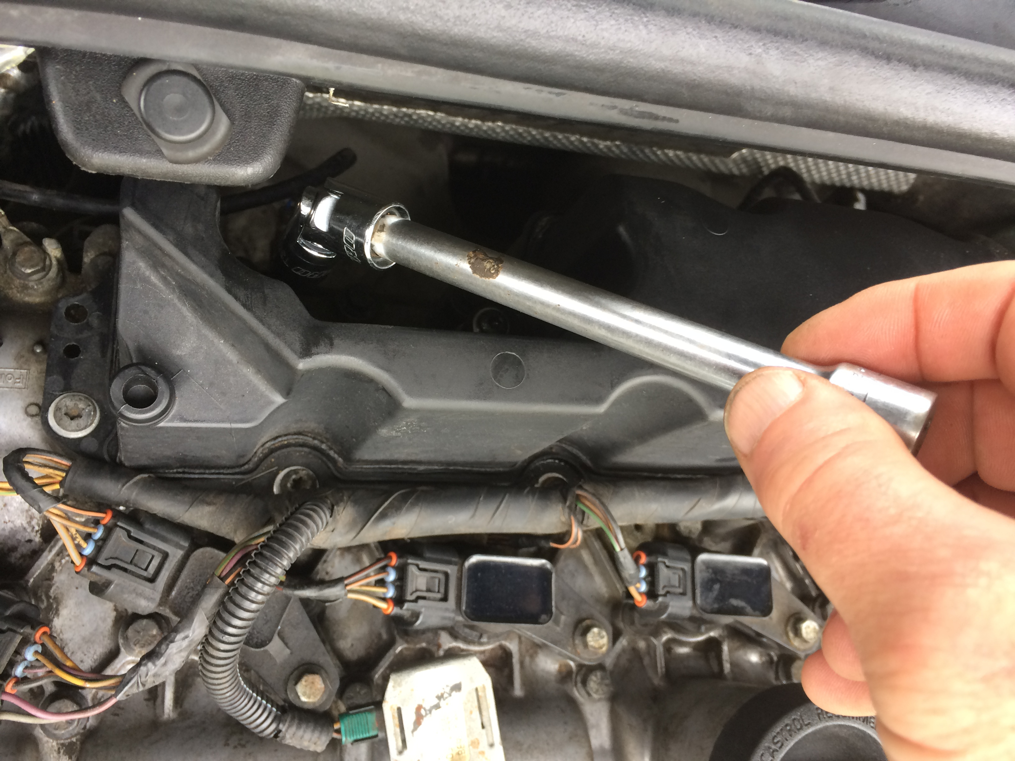

I used a 3/8 swivel socket and a T30 socket with a ratchet to remove the easy screws in front. Near the firewall I used a torque wrench because it had a low profile head giving me just enough room with the 3/8 swivel and T30 socket. All screws (there are a lot of them) were removed by hand once broken free using a long extension with the swivel and T30. Just held the extension between thumb and finger for dexterity so I wouldn't lose any screws down the firewall. Worked great.

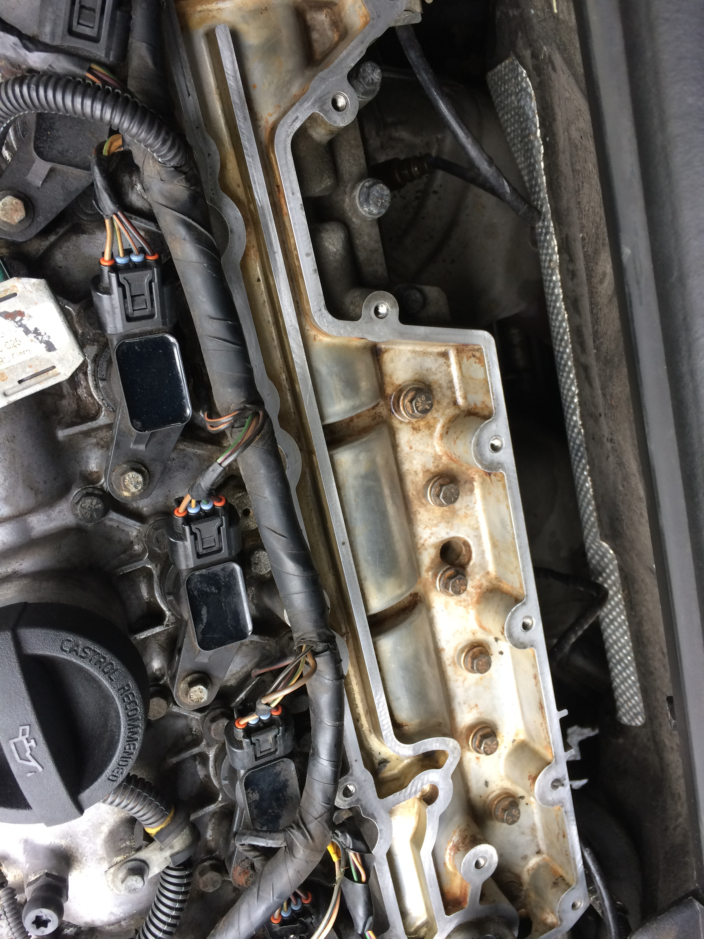

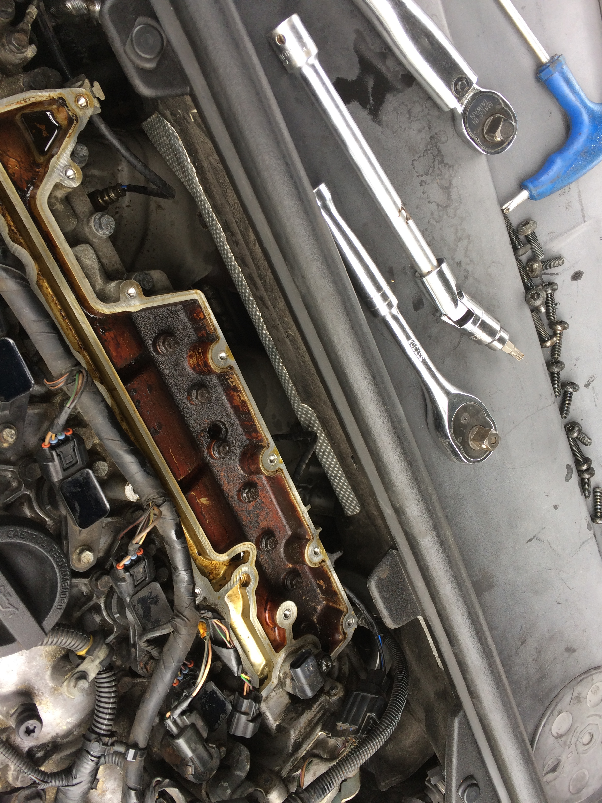

With the PCV cover removed, there was a lot of oil sludge buildup and this was carefully cleaned up. I used brake clean with bunched up paper towels held by a pair of angled long nose needle pliers and probed into all the channels and crevices.

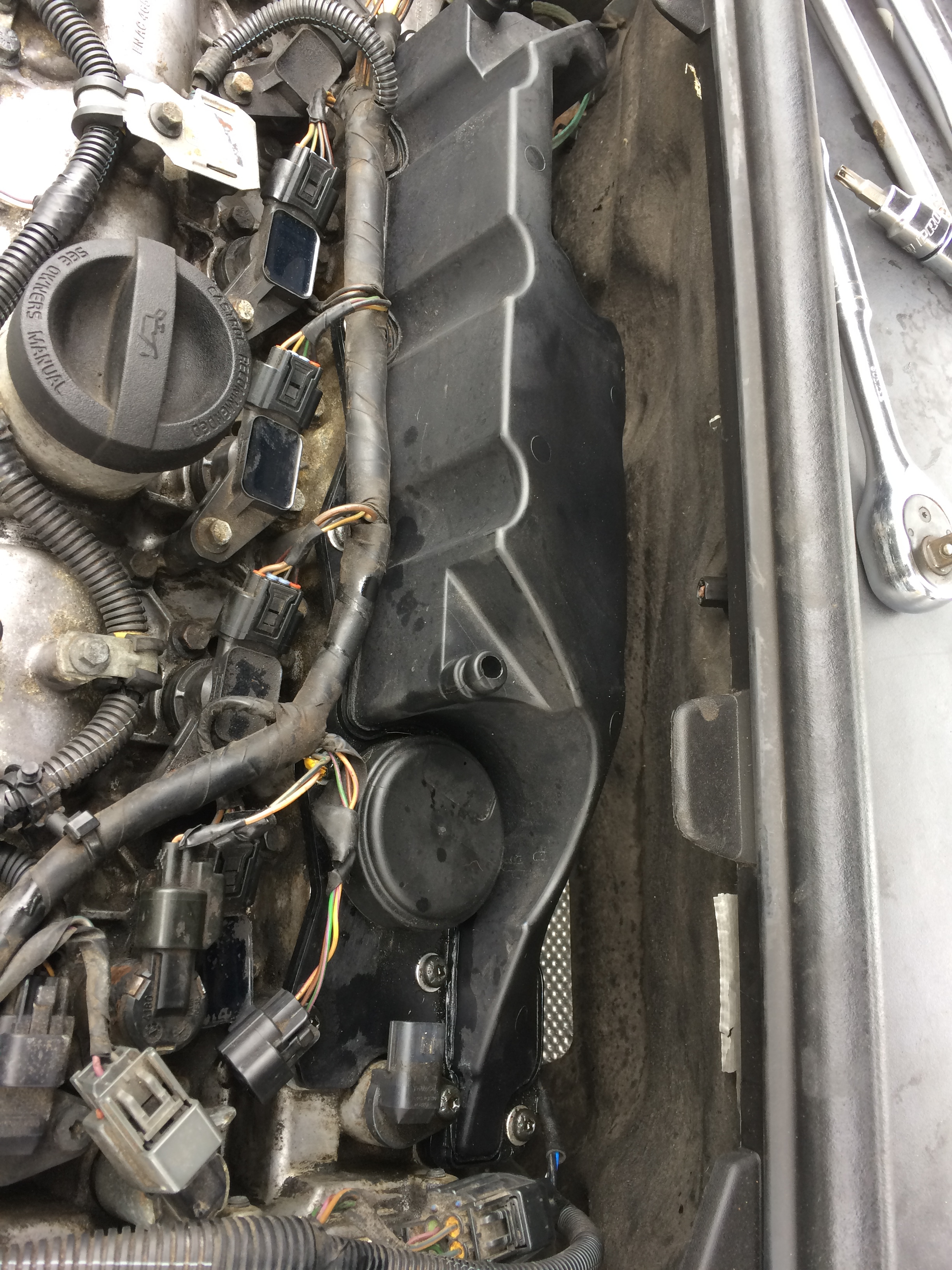

Installed the new PCV system, carefully tightening by hand and used the torque wrench to try to make them all equally tightened.

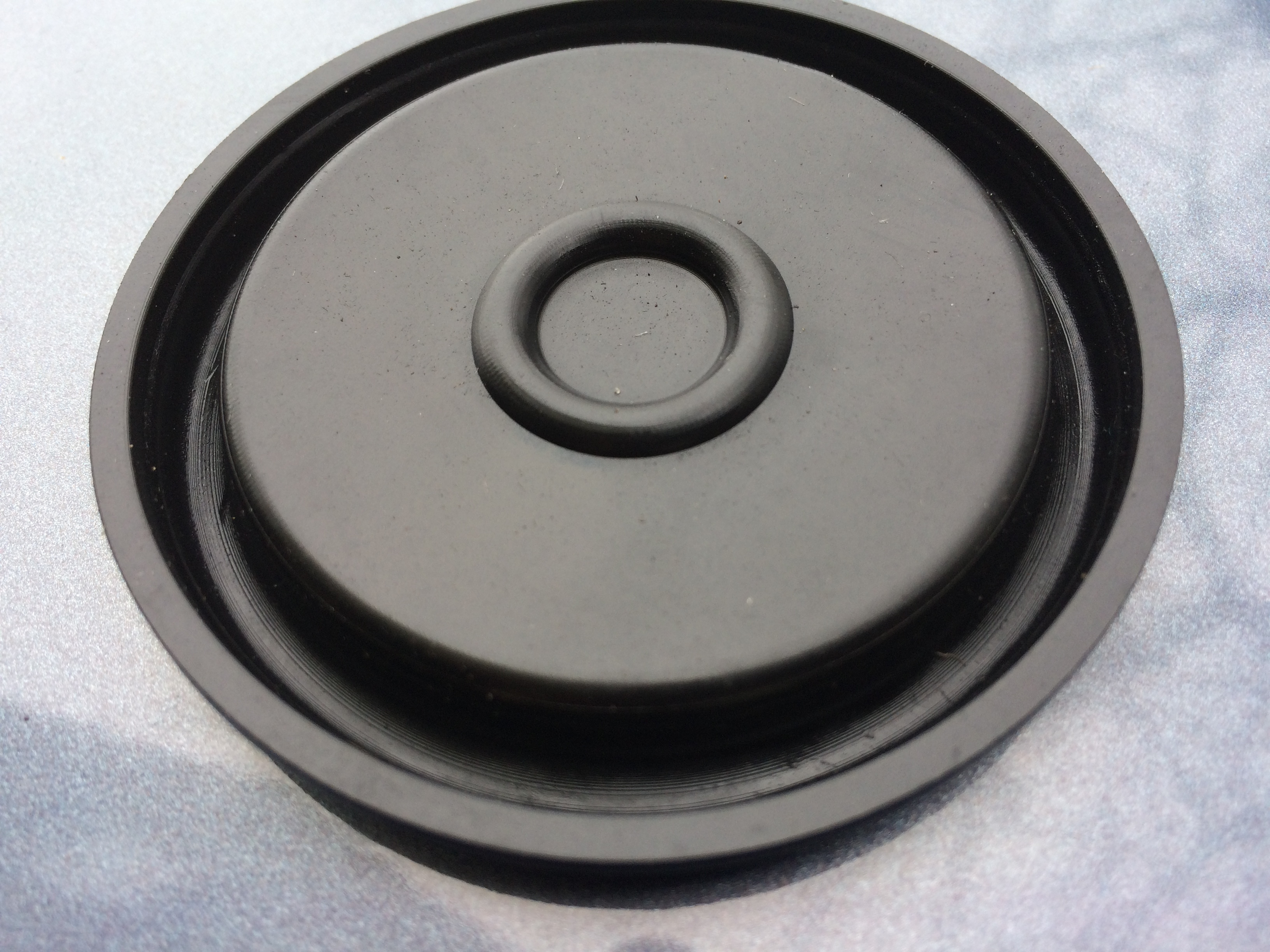

Crossed my fingers and ran the glove test again. It passed! Inspected the old PCV diaphragm and it looked quite normal. Stretched it out and maybe there was a tiny week spot but I couldn't be certain. The only thing I know is the old one didn't work and the new one does. So it looks like you can have a asymptomatic failed PCV, no noise, no leaks. Run a test as maintenance and catch it early!
