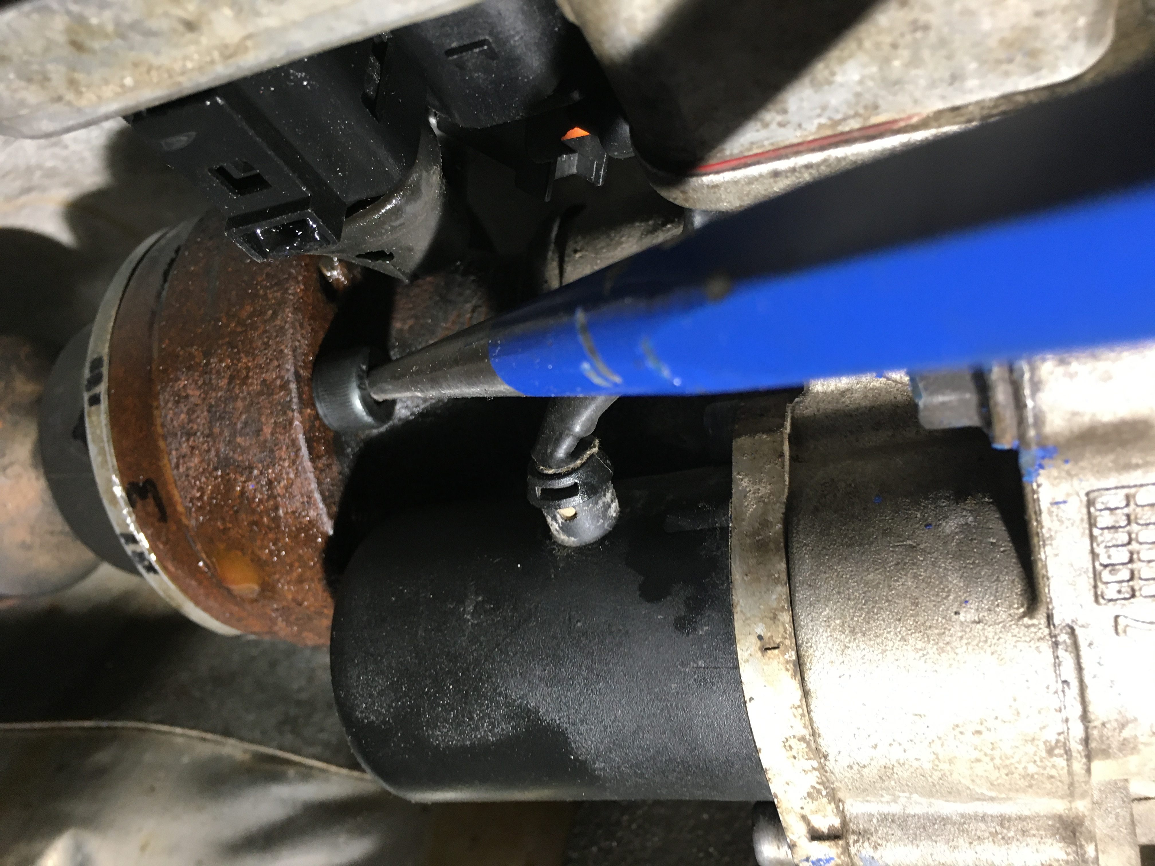

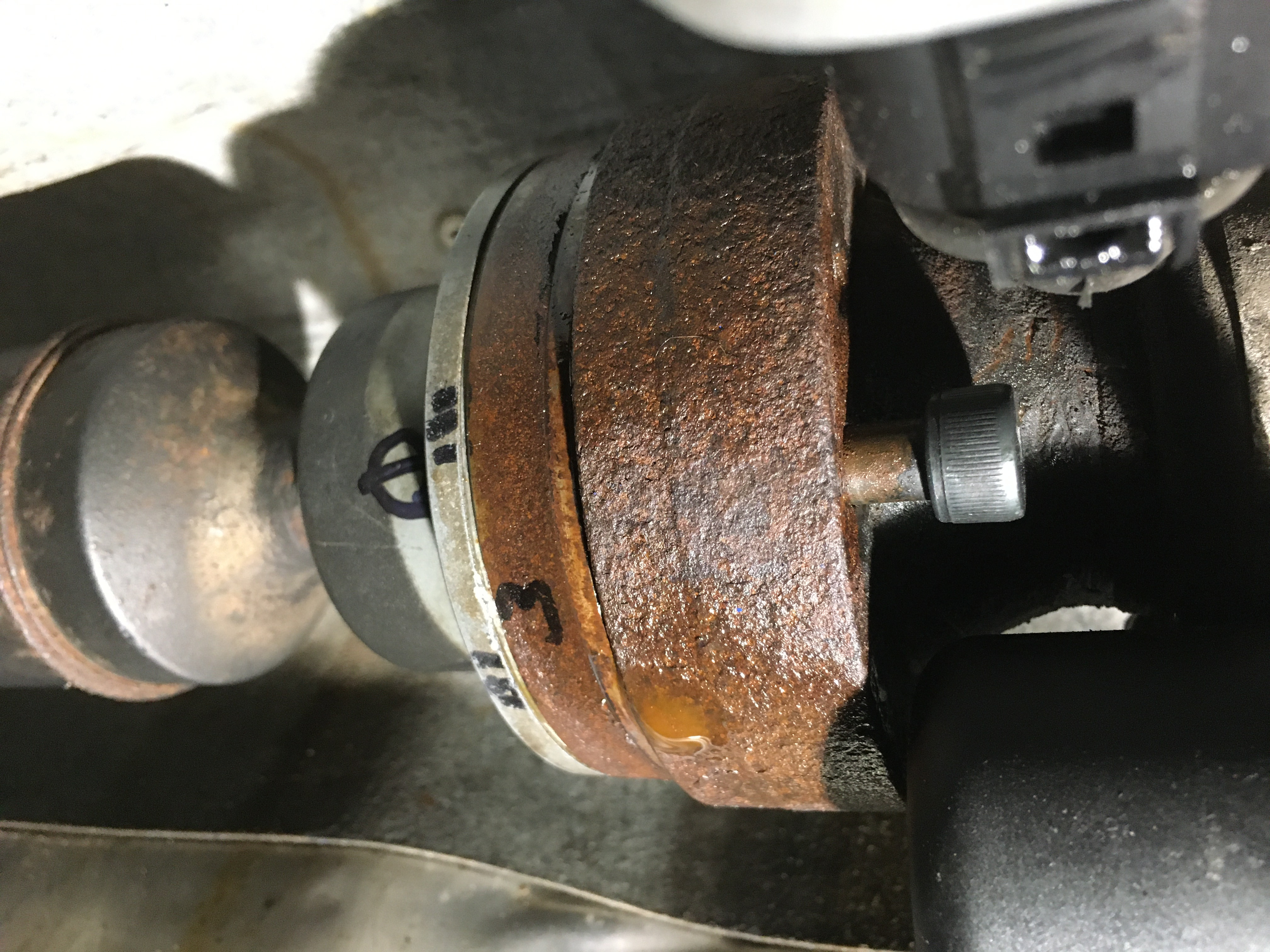

- Cut one of the bolts to 20mm, insert it into one of the holes in the back and using the punch and hammer gently, but firmly give it a couple wacks. Rotate flange 180 and do the same on the other hole. With patience it will pop free. Wiggle it out and place it to the side above the exhaust pipe.

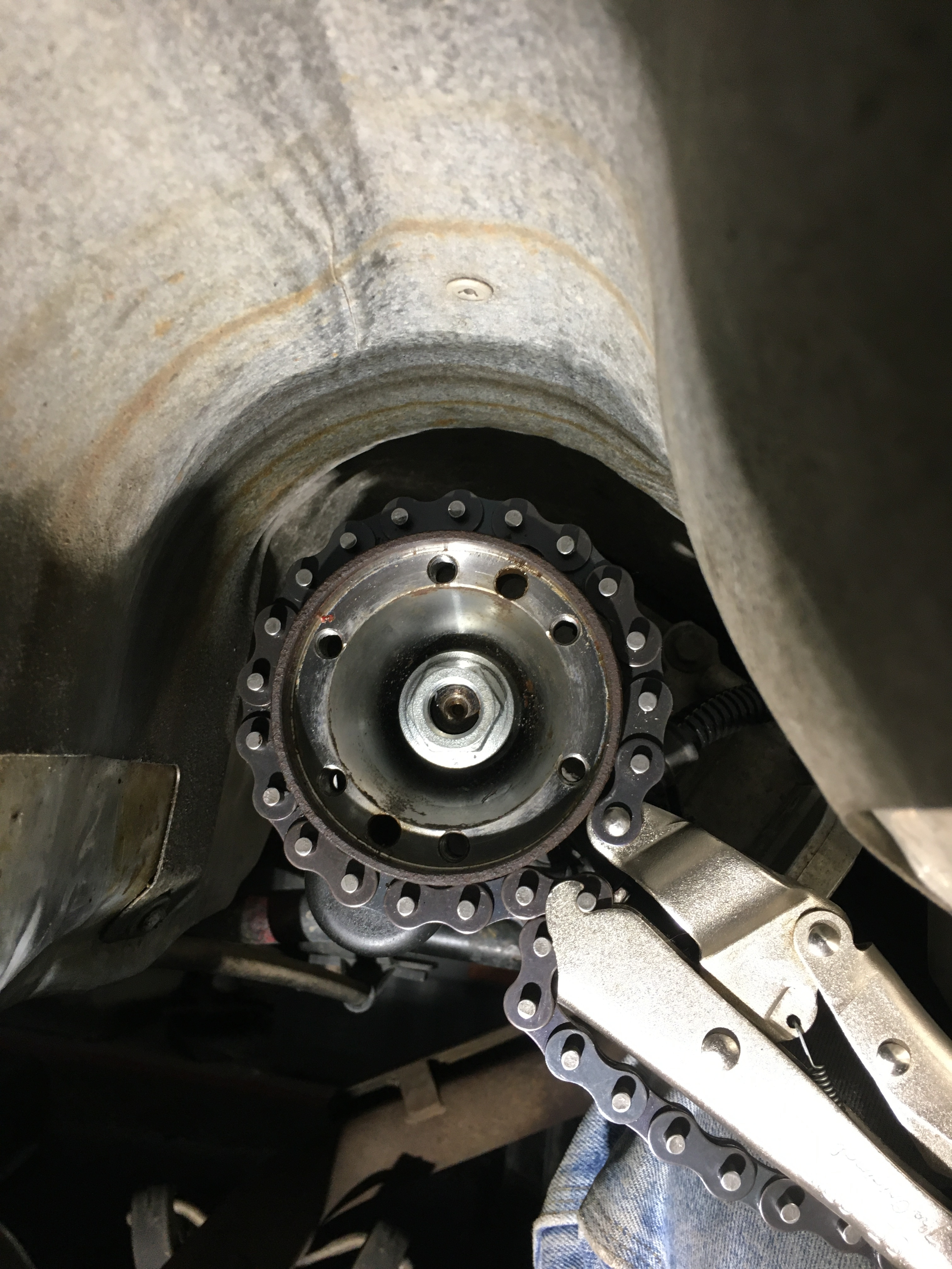

- Use the chain clamp to secure the flange and have at the nut with the impact wrench and 24mm socket.

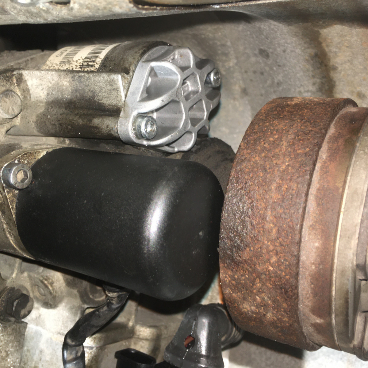

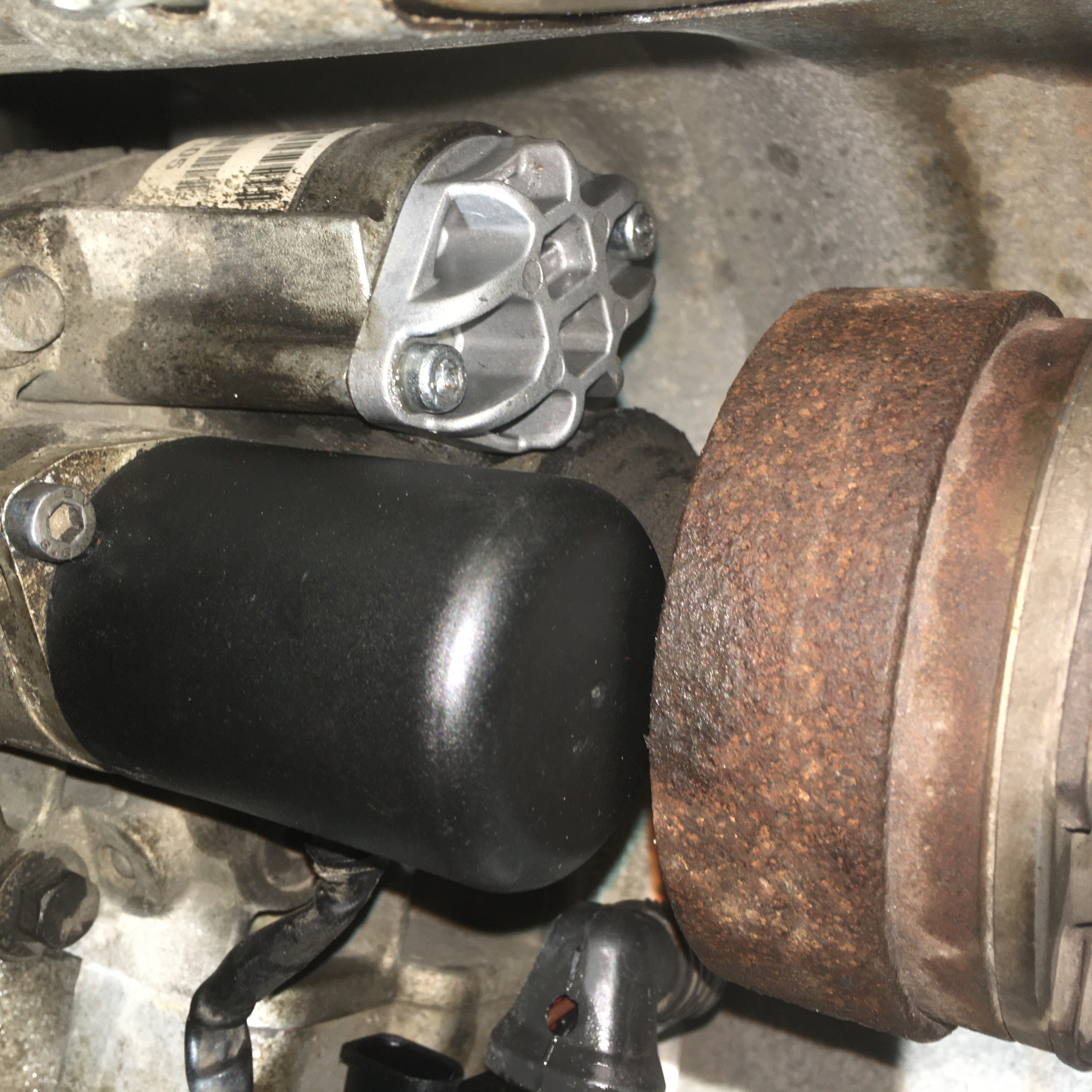

GEN 3
GEN 3
using the 20mm long bolt
Using punch on 20mm long bolt
the trusty chain clamp
