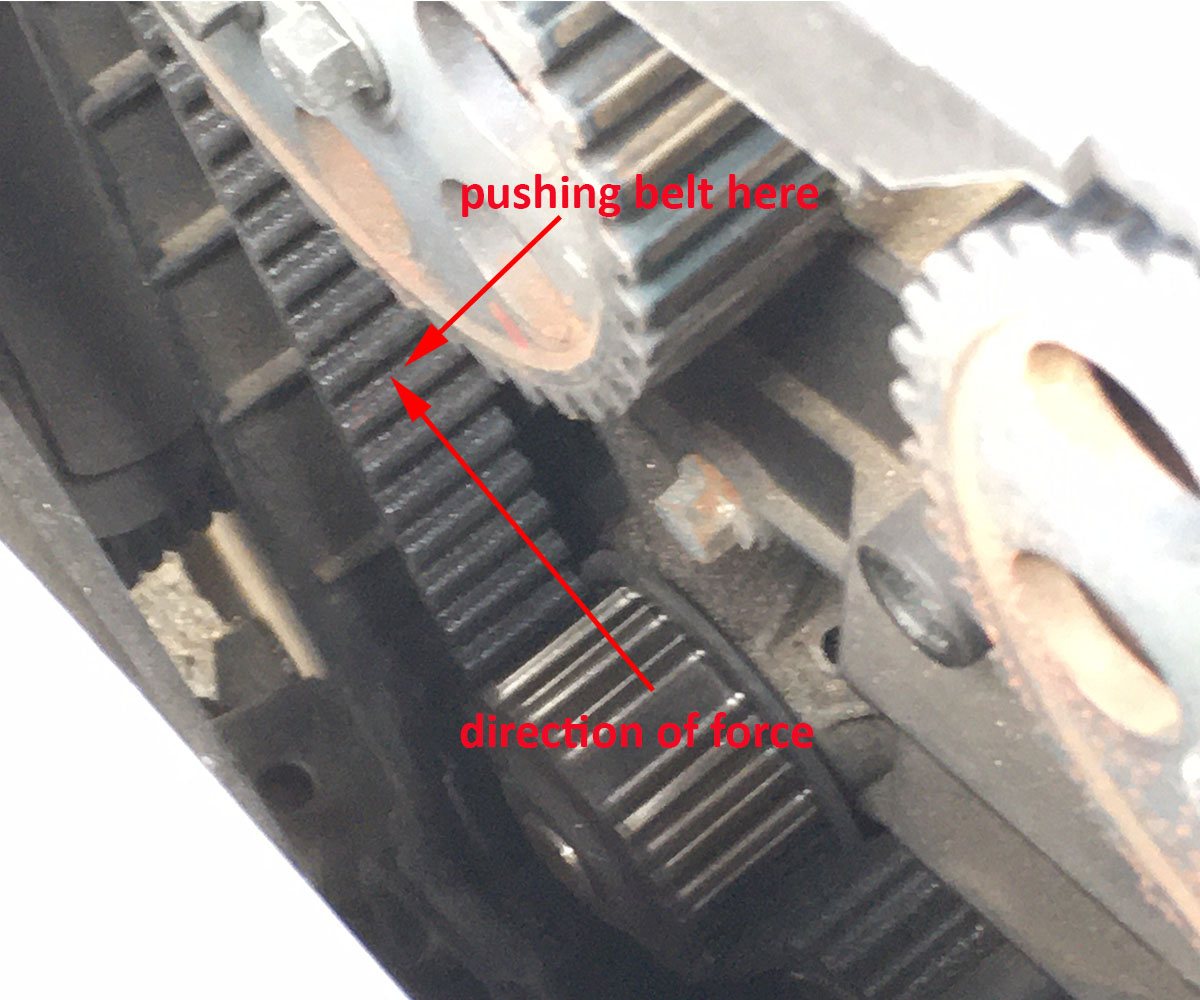

Researching my issue the past few days, reading a lot about ANY timing belt slip means your engine is toast? I'm hoping Rick is correct though! I do see what I would consider significant play (1/2"-3/4") in the belt when its pressed as seen in the attached image. The hydraulic tensioner (cylinder/plunger) also moves quite easy when force is applied. I know form experience how difficult it is to compress the tensioner cylinder/plunger with a clamp.
If it is the tensioner, I'm seeing a new tensioners at IPD (MTC) for $40 and $95-$110 at FCP? Understanding OE vs OEM.

Tensioner is definitely bad from your description. A few teeth of slippage is not engine death (bent valves), but several teeth is.
The factory tensioner is Aisin, I wouldn't touch MTC unless you are OK losing the engine at some point.

Belt breaking is toast. Slipping has some forgiveness.valvolvo70 wrote: ↑21 Mar 2020, 13:48 Researching my issue the past few days, reading a lot about ANY timing belt slip means your engine is toast? I'm hoping Rick is correct though!
For mission critical components, use OEM parts.

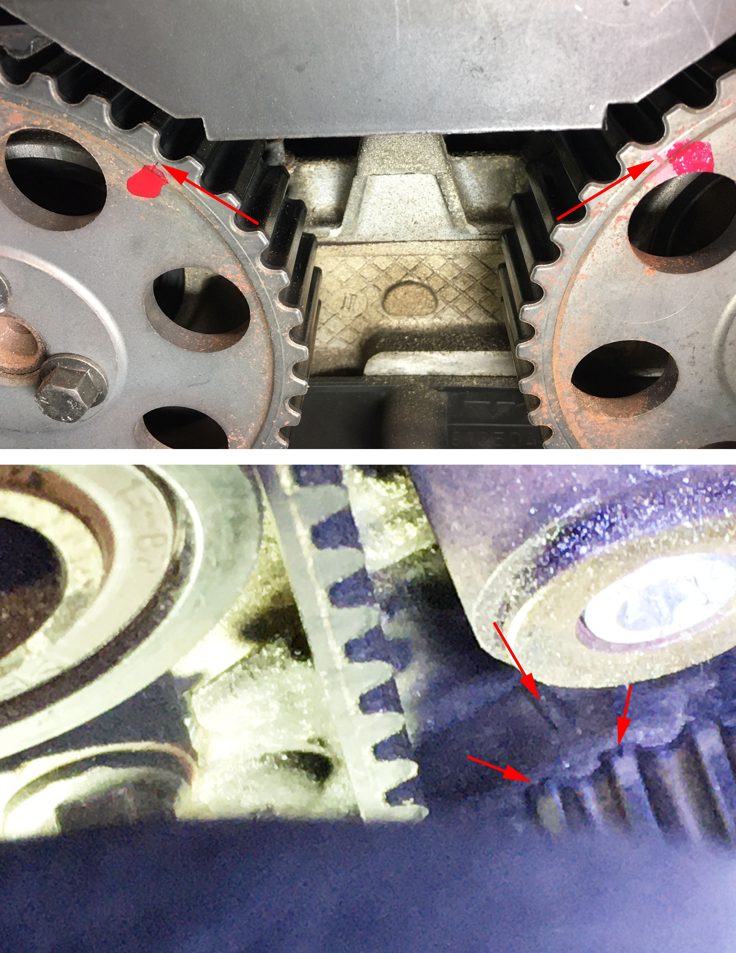

I purchased my T5 from a good friend along with a detailed 8 year mechanical history excel report. He also completed all the repairs like me. Fortunately, the tensioner and timing belt were purchased from FCP and covered under lifetime warranty! Ordering both today. Going to align the cams/crank to see how many teeth were jumped.
