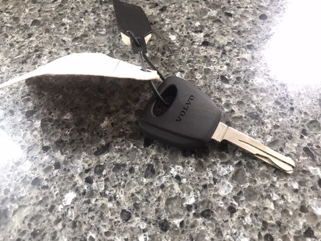

Hi All,
Getting ready to program some keys to my 05 XC70 that i purchased non-running. Dice is still in transit so i want to make sure i'm ready to go when it gets here. I do not have a remote keyfob for the car, just a valet key, and another off brand transponder key. There are BCM issues that i need to diagnose, but i get a start prevented message so i think the keys may need to be programmed.
I've seen where the remotes come with codes to program them, but how do the valet keys work in programming as they do not come with programming codes? Are they just sensed automatically when you put the key in the ignition? I do have 1 remote that came from a breakers yard, but have no idea if it's possible for someone to extract the codes required from it in order to program it to a new car. I will buy a new keyfob once i know it's worth spending the money, but for now i just need to get the car running as i have no clue if the engine & transmission are any good.

Did you get ahold of member Yagger?
He, Sergey, is able to do key coding but I’m unsure if he can do it remotely.
The large valet keys do have a chip/transponder in them. You may have just a plain cut key of it doesn’t have the chunky plastic at the top.
Yes, i definitely have the OEM transponder valet key - the other key i have may or may not have a transponder in it.
