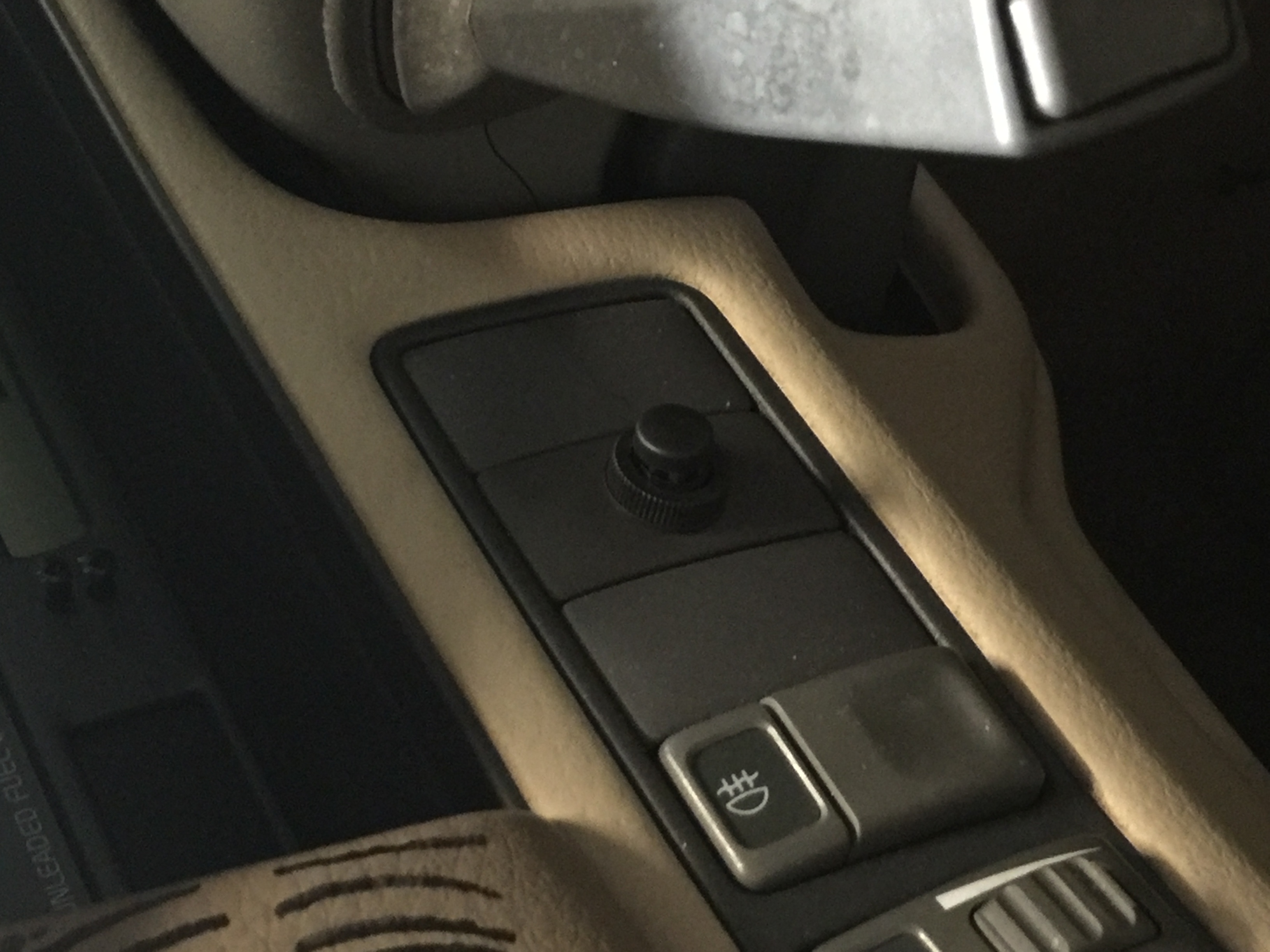

This is how I did it on the Volvo I had. The central locking stopped working for a while and finally the alarm started to go off every time the battery was connected. As neither of the door locks would disable it was clear it was the module.
The module is under the dash, drivers side above the kick panel. May need to remove the knee guard. A black box with 2 green connectors with numerous wires (may say ABS, on the backside). As this was bad it was no longer needed (Plus I don't think anyone would want to steal my Volvo) it was thrown away.
A cheap pushbutton was purchased from Napa that would allow the starter to turn. As the module would no longer be doing its job power would have to get to the starter relay a different way. The center pin in the relay is what needed power. So a fused power wire to the switch in the car, and another wire from the switch to the center pin on the relay ( pretty sure that is pin 87). This bypasses the module and allows cranking. Just put key to accessory position, push the button and she starts. All for about $10!
Attached are some pictures of my work. Hope this helps so someone else isn't spending time dorking around with this.

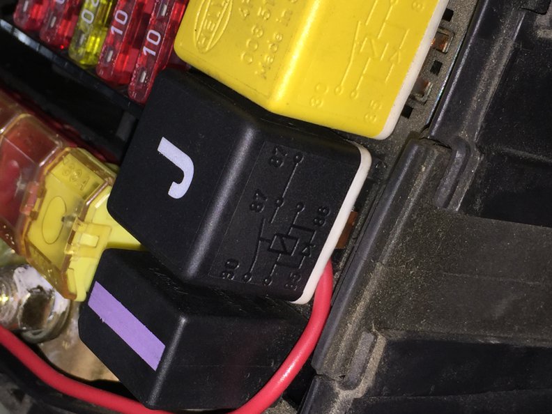

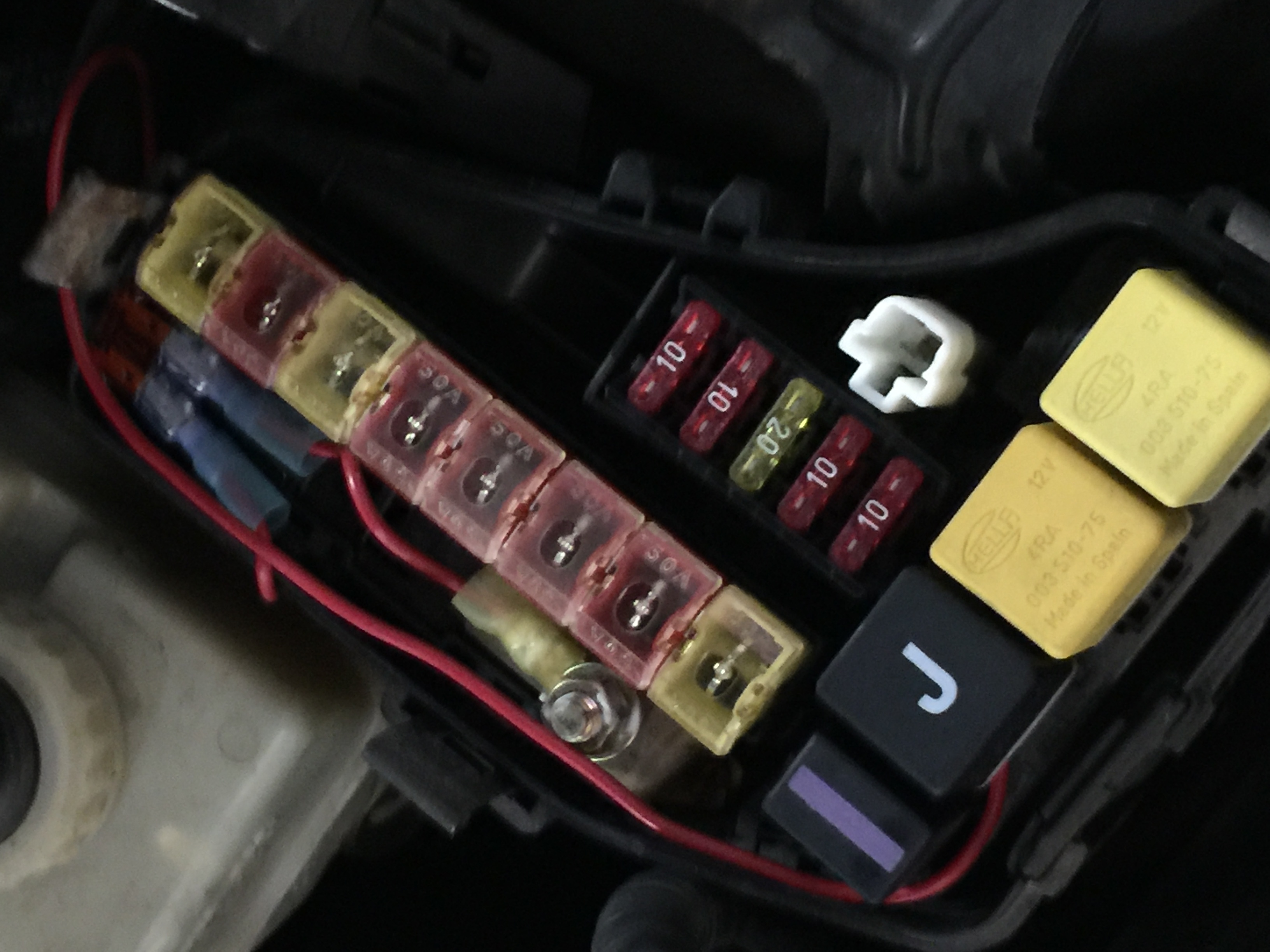

My 98 s70 M56 turbo car would not start without jumping the starter relay. Kept messing around, new ignition switch but to no avail. Caught this post and simply wired the relay lug #85 to ground and BINGO everything is working again!
