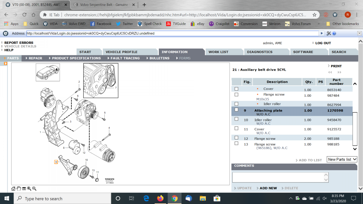

From what I can see in Vida you should be able to short belt it. It is just a matter of figuring out the new routeing and the length of the short belt. Keep in mind some of the Alternators are suppose to turn one way only. Short belting as shown below may result in the belt slipping on the Alternator, less belt to pulley contact. On the other hand it may work just fine.
Red is the change in routeing.
The official way is to remove the A/C compressor and replace it with a idler. #9 - 11 below.

The problem with such bypass is the belt will not wrap properly around the alternator pulley or around the tensioner
