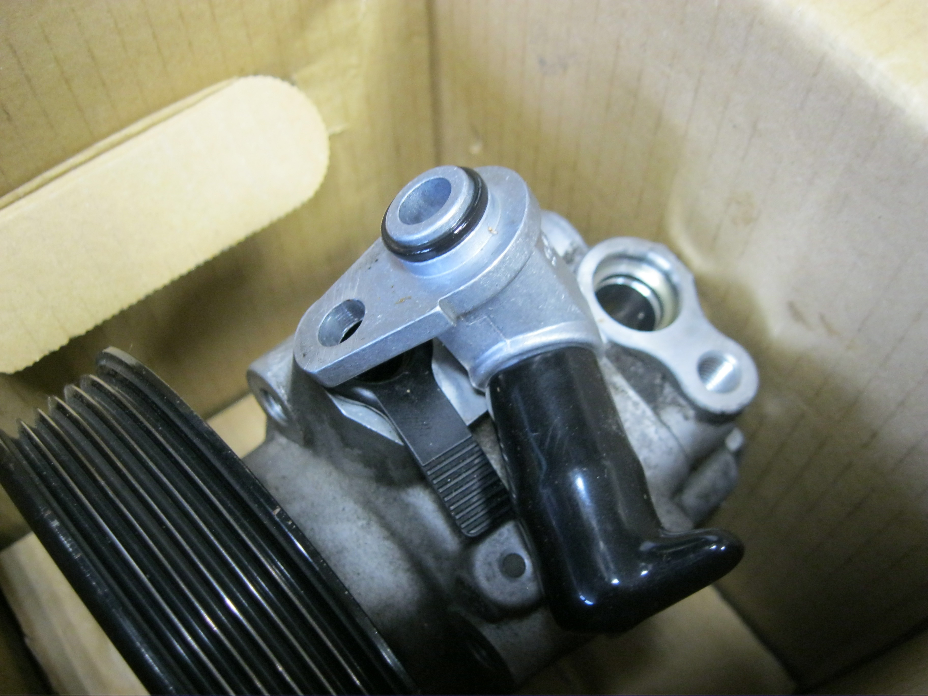

See photo, you can probably get to the high pressure side in place (O-ring is PN 988119). Power steering pump (exch) is PN 36000748, will be happy for you if it's only the o-ring. Plenum upper gasket are PNs 30720327 and 30720328 and if top comes off, you'll need to drain some coolant (good time to swap out with OE). My seeping was from the back seam, replaced before it got worse and still have the original pump- if someone knows where to get them quality rebuilt, let me know. When pump comes off belt comes off. If the vehicle is over 100k and the tensioner and idlers have already not been replaced, probably good time to do them all together. Keep the tensioner bracket if you do replace, you'll use it again some day.

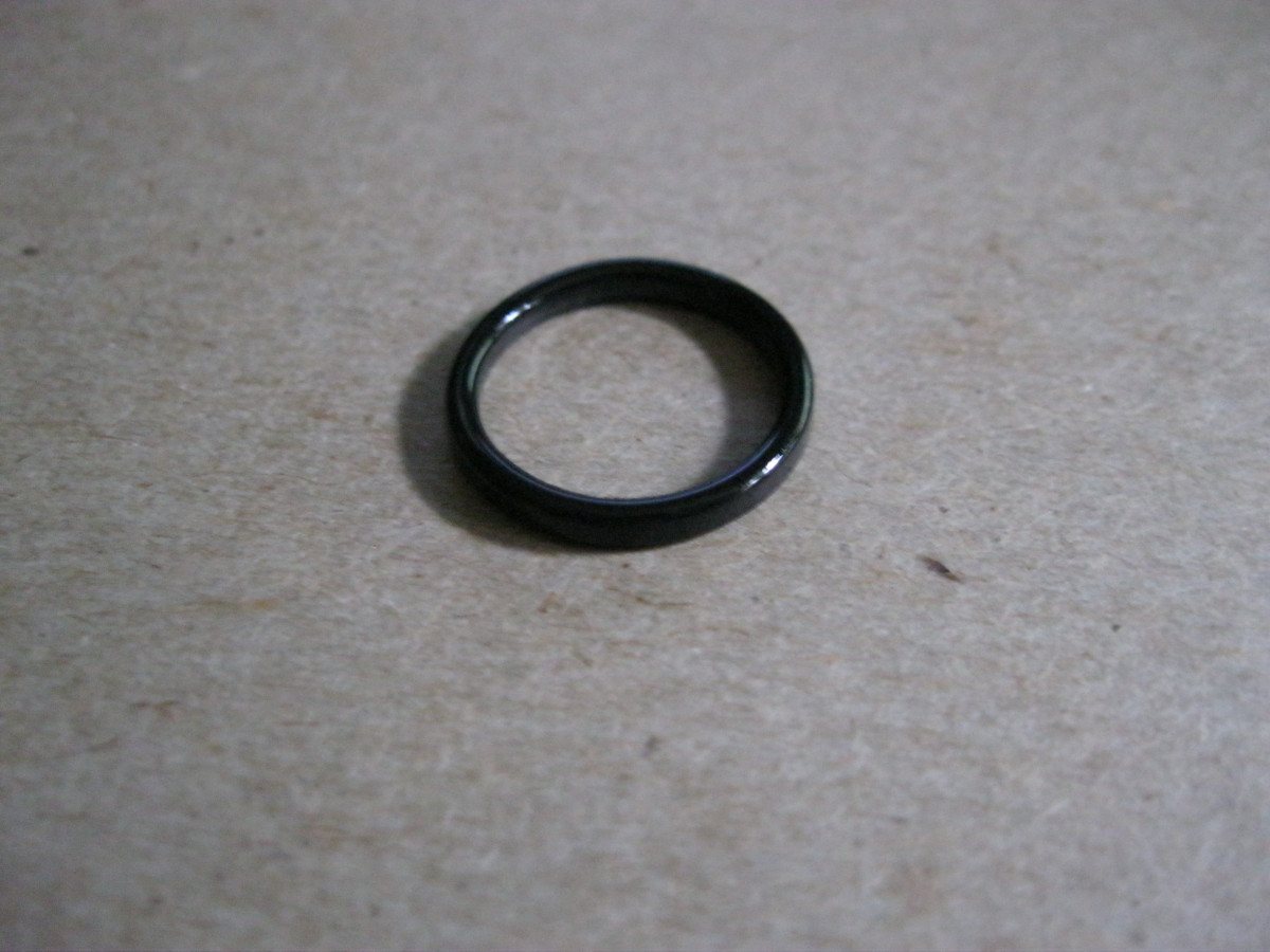

The steering rack side (high pressure) o-ring is readily available, PN 988119 as noted above. Reservoir (pump fluid input) side o-ring is not a replaceable PN on it's own, see photos for reference. I took a micrometer to the o-ring: approximate measurements are 14mm ID, 17mmOD, and 2-3mm thick (mine are flat on the sides).

No need to get anything, pump will come with that piece already bolted on. I took it apart (it's my old pump waiting on someone smart to start rebuilding them) in order to get a photo of the o-ring which the earlier poster had specifically asked about. If you have the rack side o-ring 988119, you're good to go.
