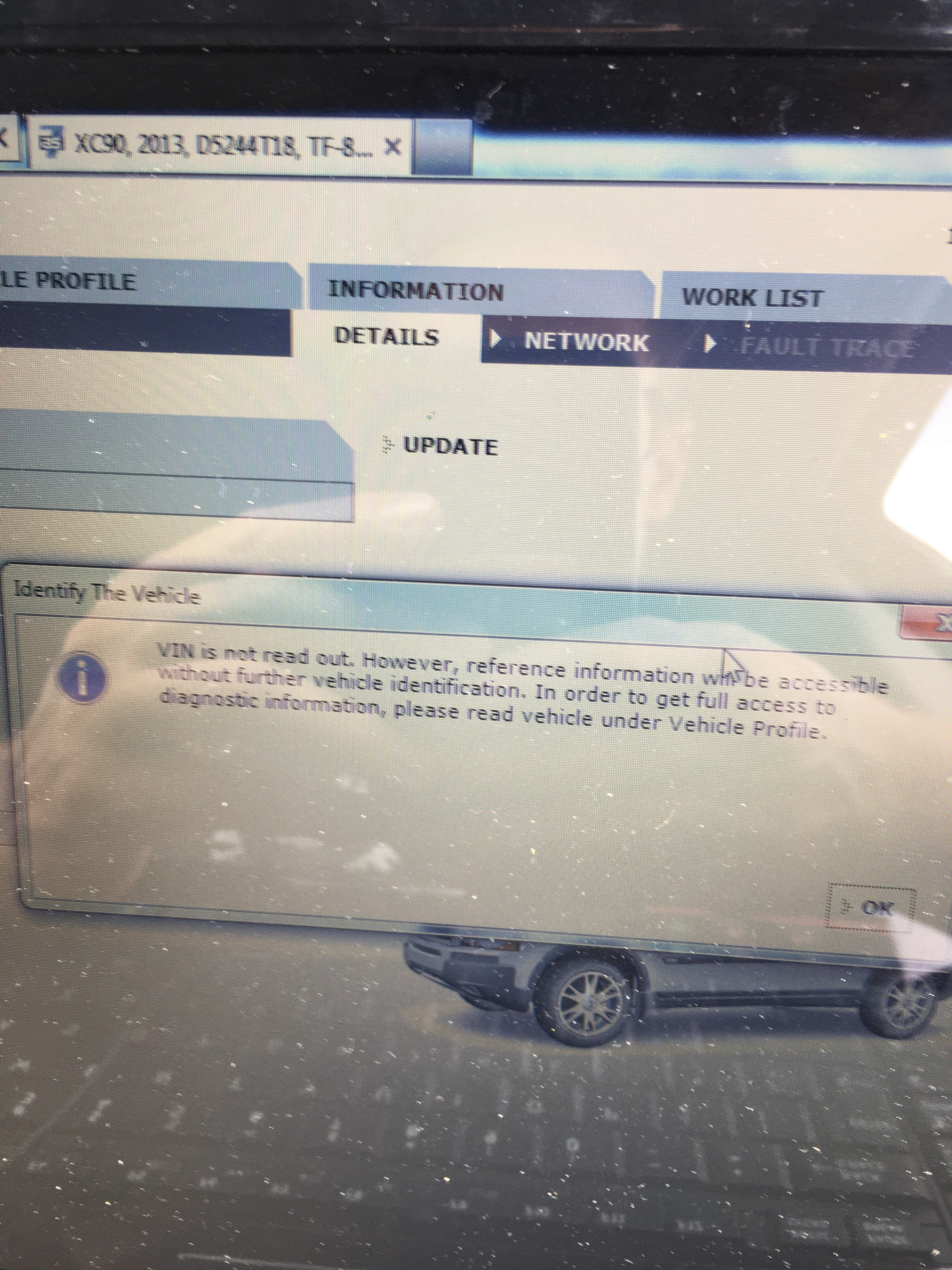

Hi again , just trying this again after some time , and after getting the correct model and model year and engine , click ok , , it won’t then allow me to connect to dice as no VIN
I get the attached message pop up

Enter the VIN in manually then select vehicle options. You can't do any diagnostic work on Vida without pointing to a VIN.
