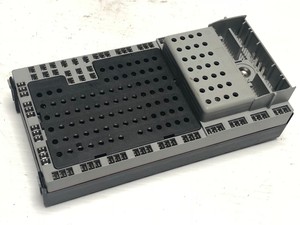

If you have this problem after engine stay worm, I think issue can bu in the CEM also.Angusthethird wrote: 24 Mar 2020, 14:20 this happens after the car has been driven a few miles,flashes about 10 times and quits,only after it has been driven and warmed up.?? battery going bad?
