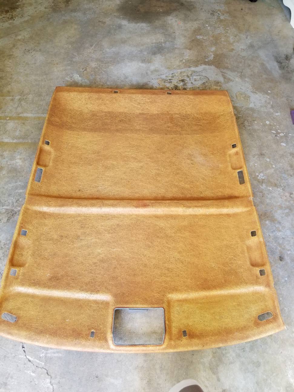

Okay. Small update. Well, Covid killed my job. So I've done less than 1000 miles since my last update. So that kinda sucks. But, I'm doing fine and I've switched focuses so that's all cool. I've had some time to start some "luxury" projects.
I attempted to repair my failed headliner. Repair wasn't to difficult, but my glue didn't spray correctly and so I have some saggy spots. Being a sedan I had to pull it out of the passenger side door. So I had to fold the headliner a bit to fanagle it out out the door. I am pretty confident that Volvo installed the headliners through the front windshield, seems the only wide enough place to do it.
So here's some pictures of the project.
First you sand the liner to get all the foam off
