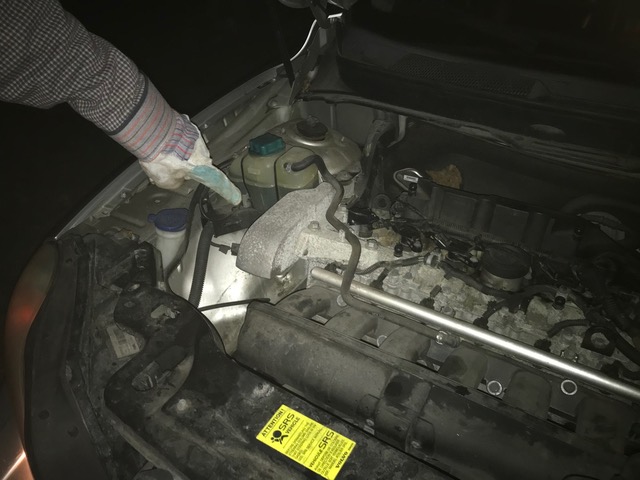

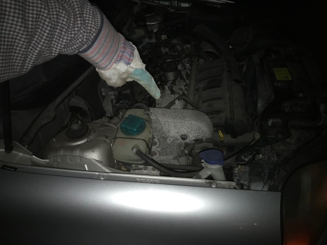

Thanks XCAndy. I am checking that out now. Was just about to post a new thread on it and pics. I can hear that aluminum area rattling around. At first I thought it was very low coolant - believe it or not, it's so loose it sounds like that 'waterfall' low coolant in radiator noise but it's that thingee rattling looser than a baby with cerebral palsy and a broken rattle (I don't know what I meant there apologies).
Here's me pointing to that area / rattle point.

I can flick that area around with my fingers - it's so loose. I know that cannot be intentionally engineered that way.
Is that a 'front upper engine mount'?
Is it something else?
I have to assume it's nothing so stupid as an external valve timing thing - that would be impossible.
In the 2nd pic just below my index finger straight down on that light colored aluminum cover, that's where something underneath freely moves and clatters around shifting and under anything but very light acceleration.

Yep. XCAndy you're right. it's that 'upper torque rod' and also called upper engine mount sometimes i guess.
Found great link here how to replace it:
https://andrewpeng.net/cars/2010-volvo- ... eplacement
"We’re interested in part #14 above – luckily, this is an extremely simple part to replace requiring only two tools and about 30 minutes of time! The replacement part number is 31430441 from Volvo and costs about $62 from Tasca."
Not sure what the symptoms of this being shot are aside from noise driving - or what being so loose makes bad / worse aside from noise. But that will get done next during my no work Covid season now.
