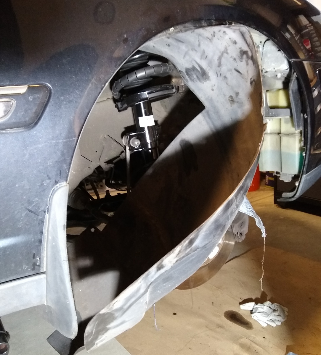

Gave the thing an oil change today (Mann & Rotella T6 5W-40). Glad to get that Mobil 1 out. Installed a set of Quick Struts and left it on the Quick Jack for tomorrows installation of Anti-Ping bolts, neoprene upper engine mount inserts and lower torsion transmission mount.
US $135.35
Set of 2 Front Complete Struts Spring For 1999-06 Volvo S80 & 2001-09 Volvo S60
https://www.ebay.com/itm/Set-of-2-Front ... Swdzxd6Hfw
The set removed were KYB Quick Struts. No leak but the right side had no bump stop as it bottomed out over big bumps. Probably internal wear or damage. Same experience on a set of KYB struts years ago on a 95 Plymouth Grand Voyager. Internal damage out of the box and the new one didn't last long either.
Inserted some flexible magnet strips as spacers into the gap of lower control arms bushing to make it flex less when I used a pry bar on it. If that removes the pull I will need to replace the lower control arms or bushings.

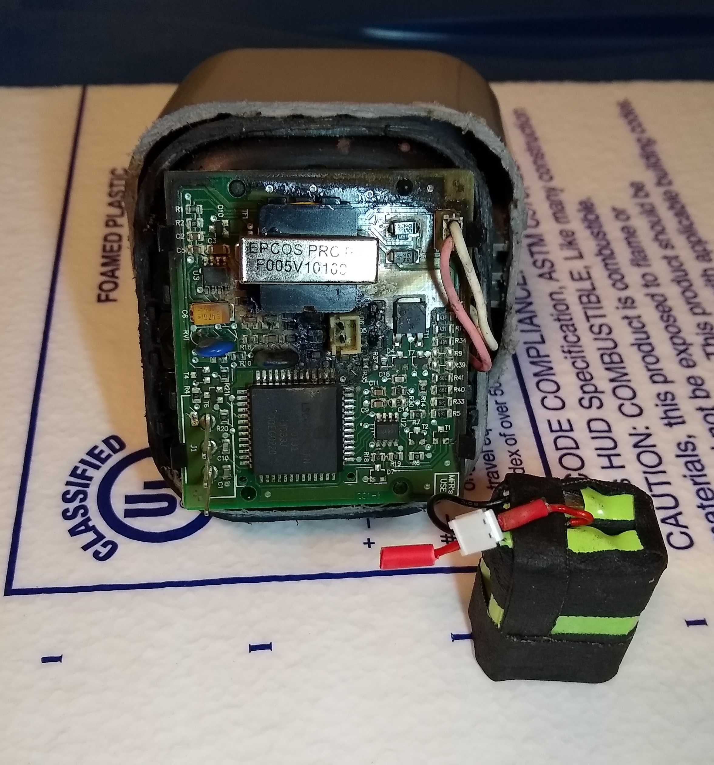

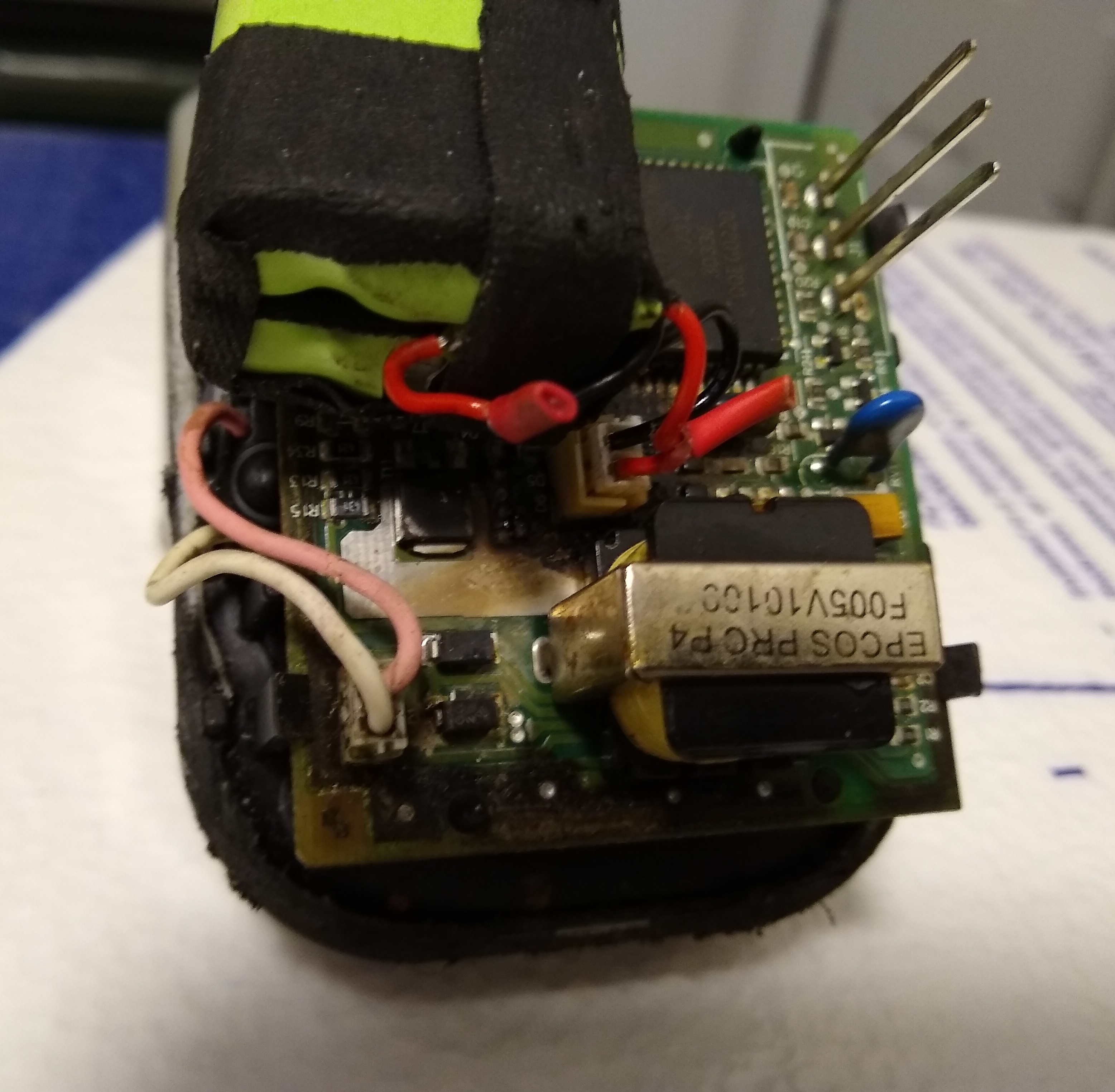

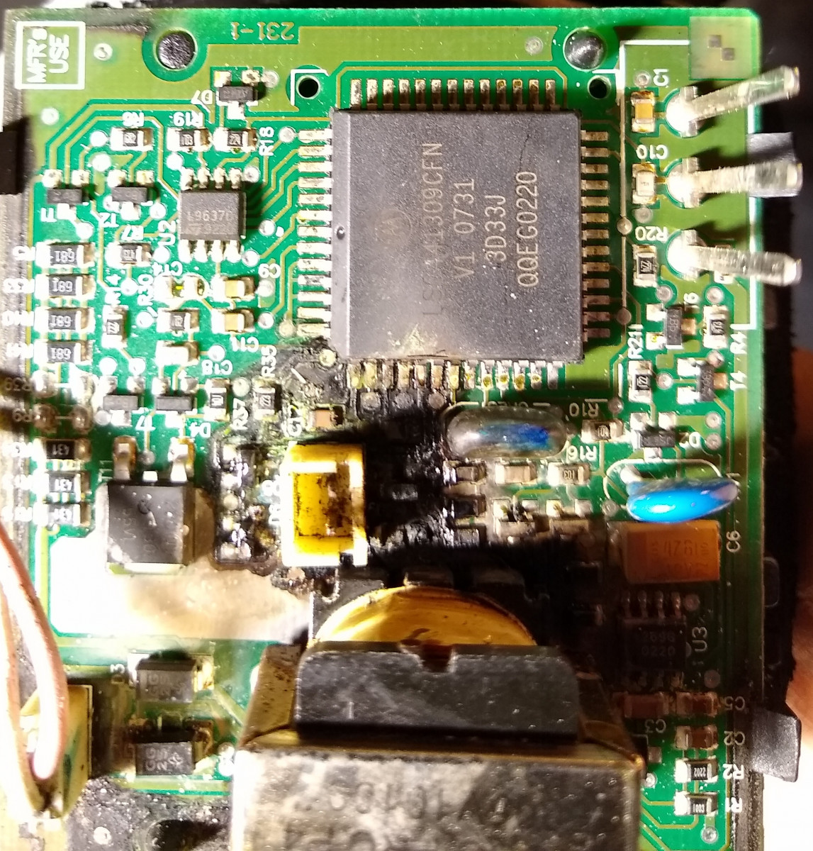

Tried to repair the Alarm Siren with some cordless phone batteries as the "Alarm Service Required" warning is on. The board was in pretty bad shape but since I already had the batteries decided to give it a go. FCP does a nice job of showing the process from beginning to end. I only took a few photos of the mess. "Alarm Service Required" message is off but didn't have time to test the system as the car is on the rack.
Similar Batteries
https://www.ebay.com/itm/2-Pack-3-6V-90 ... 0005.m1851
FCP
Don't need to remove the entire fender liner
Tried a pry bar end and hammer to rotate screw then cut a slot with a rotary tool for a screw driver. One more time with the pry bar and hammer on the slot but it was the vise-grip that worked.
Cut it open with a hack saw, it's the best method. Splice the battery wires so the batteries are in series. Used a shrink tubing with glue inside to make the connection of the battery wires. Trimmed the edge of the white connector so it will fit into the connection of the PC Board.
Need to remove all the plastic in the case that use to hold the old battery. Position wise this is where the new battery will sit in relations to the PC board so it was fit back into the casing.

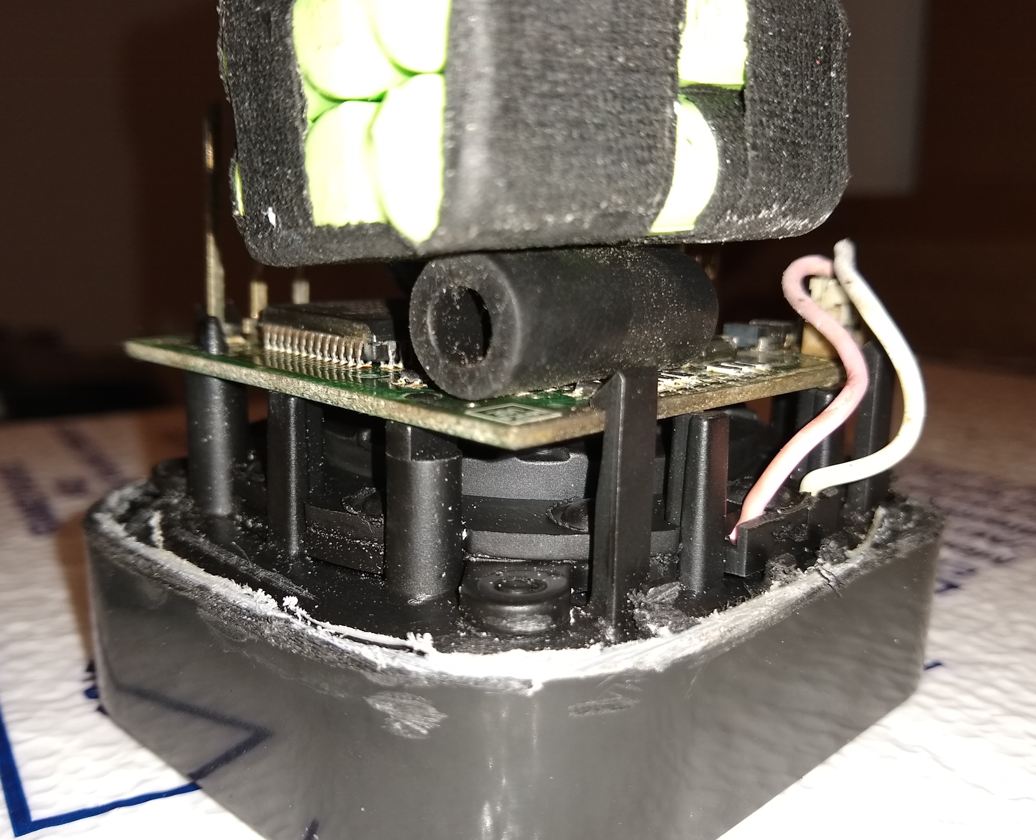

In order for the battery not flop around in the case nor rub against the PC board a soft flexible tubing / hose is used to provide space and cushioning.

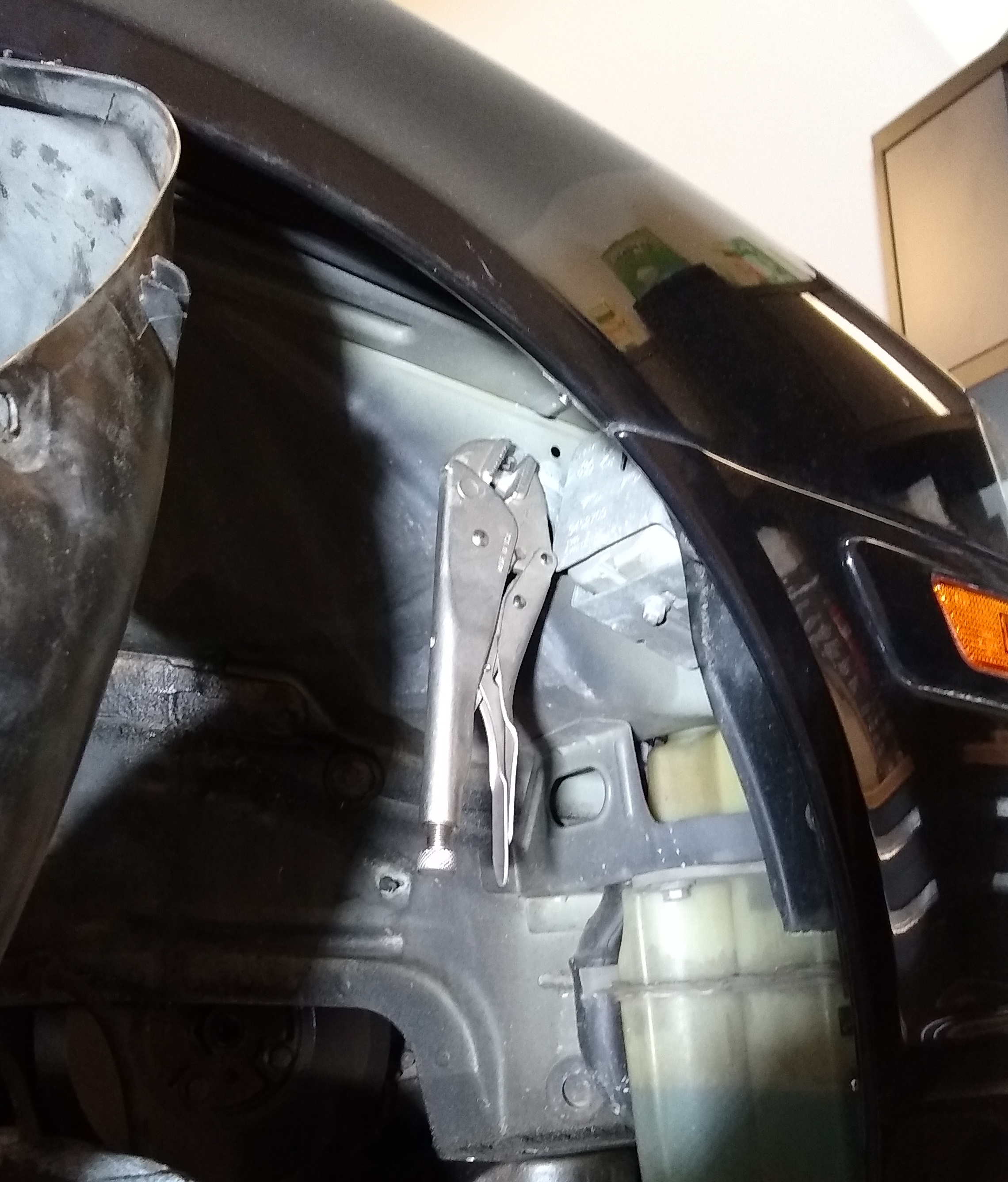

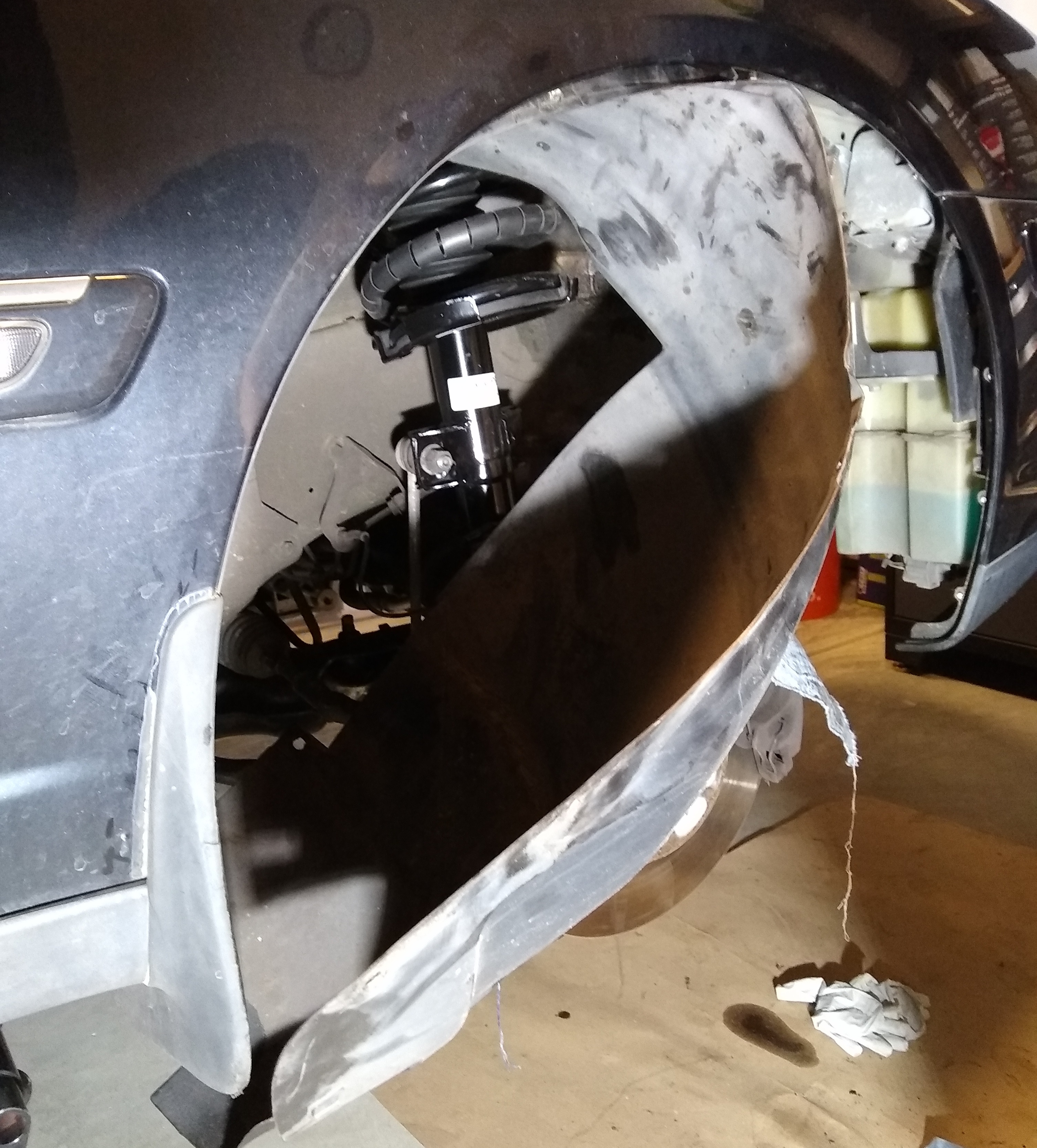

Having owned so many cars I usually have a sense where suspension issues are and from a preliminary look the control arm bushings, ball joints & tie rods all seem fine including the sway bar links.
I was hoping to systematically put in parts needed and upgrade so I can tell where that pull to the left comes from when I start from a stop. The steering will straighten right away and at all other speeds and turns there are no issues.
1) Sub Frame Bushing Parts - The chassis feels like one with the upper body of the car but pull is still there.
2) Quick Strut - It ended here as I went ahead and change power steering reservoir before a test drive and broke the coolant tank. I AM VERY THANKFUL and GLAD I BROKE IT as it was very brittle. Better to have this happen rather than during my son's 2.5 hour trip to college.
SUNDAY AFTERNOON

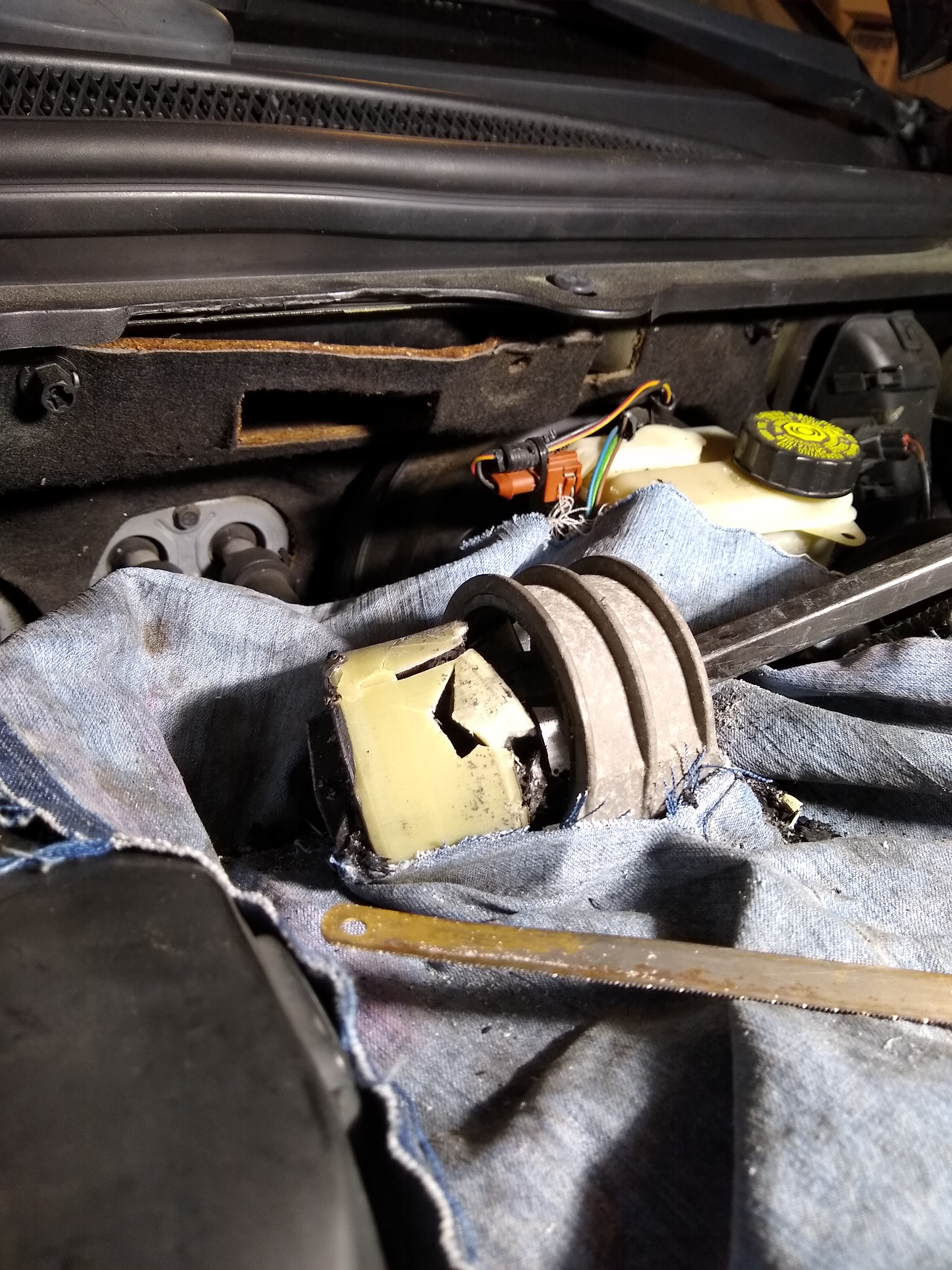

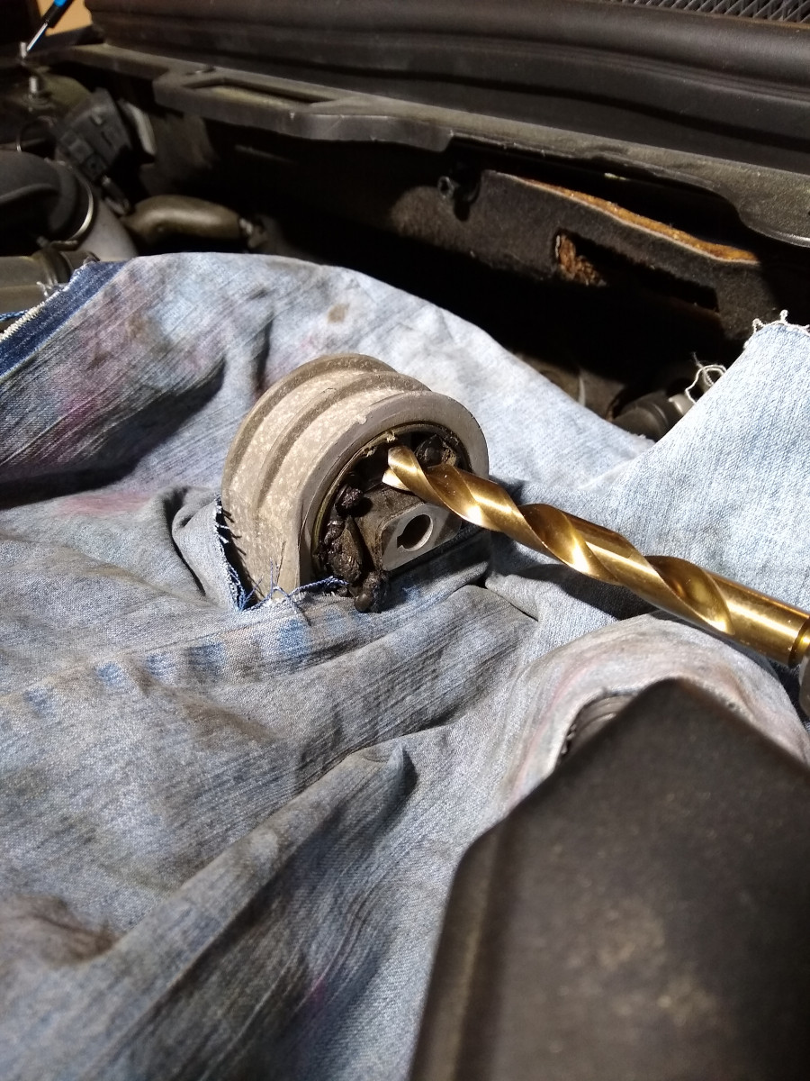

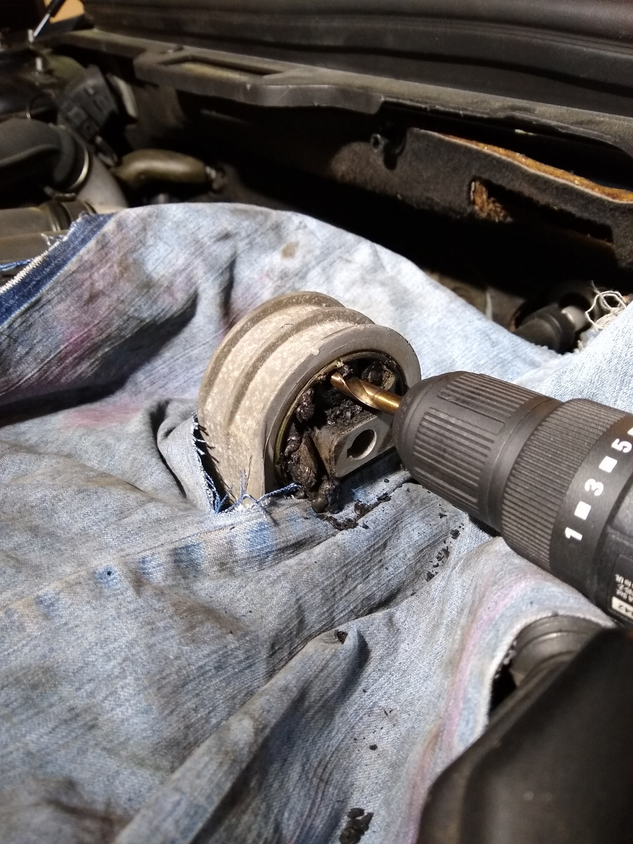

3) Upper Engine Mount & Transmission Torsion Rod - Decided to install these while waiting for the coolant tank. I also inserted some flexible magnet as shims for the gap in the front control arm bushings. If the pull is still there the rear control arm bushings are suspect. If the pull goes away I will remove the magnets and see if it comes back. If so the front control arm bushings are bad.
Pilot Hole
Larger Hole For Hack Saw Blade
Hacked Two Kerfs In The Upper Area Of Mount - Coolant Tank Before Breaking That Hose Off.
Outer Ring Made Of Plastic Instead Of Metal
Super Pro 8671633
https://www.fcpeuro.com/products/volvo- ... e-8649597u
FCP Super Pro 8671633.png (399.74 KiB) Viewed 1432 times
Regardless, I hope to have time to replace the control arm bushings.
Rears will be the XC70 units while I'll look for some Poly for the front. Review on FCP stated Volvo should only sell these for P2 control arms.
https://www.vivaperformance.com/genuine ... 0-v70-s80/
https://www.fcpeuro.com/products/volvo- ... r-genuine-
