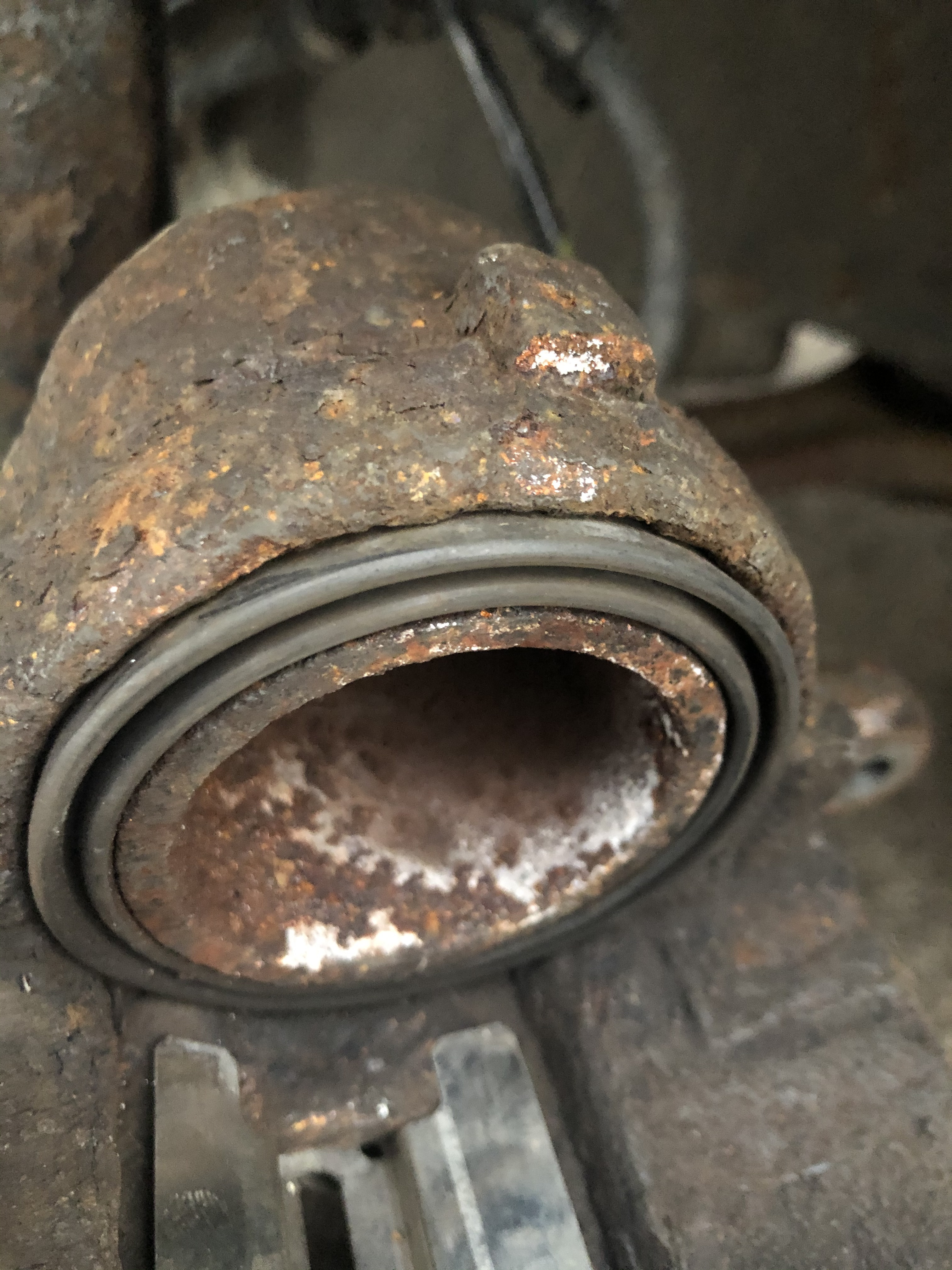

Judging by the exterior, there may be interior corrosion that is stopping the piston from retracting more into the caliper. This would limit the gap for the new discs and pads. If you bleed off fluid at the caliper, how bad does it look?

The rust on the lip of the piston might be what is doing it.
Zapta: Clean, file, sand the rust off the lip of the pistons and try again. Be a good idea to push the pistons back out a little to avoid damaging the seal.
