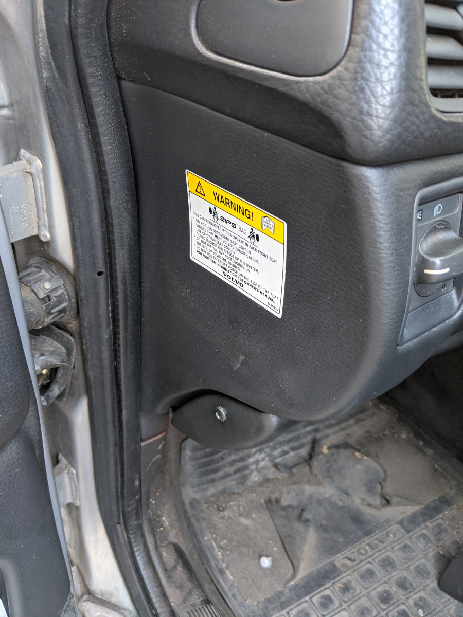

RickHaleParker
Posts: 7129
Joined: 25 May 2015
Location: Kansas
Has thanked: 8 times
Been thanked: 958 times
Post by RickHaleParker »
Fiodor wrote: 16 Apr 2020, 12:26 But that's inside the engine bay ?
I'm trying to find a place to attach the 2 power wires to the amp.
Open the door and look on the end of the dash.

Fiodor
Posts: 141
Joined: 17 October 2017
Year and Model: 1997 V70 2.0 T5 AWD
Location: Reims
Has thanked: 13 times
Been thanked: 9 times
Post by Fiodor »
No fuse box there...
But I found the gromet next to the pedals and I managed to get the wires through there and to the battery's positive terminal.
