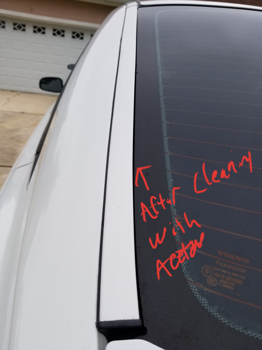

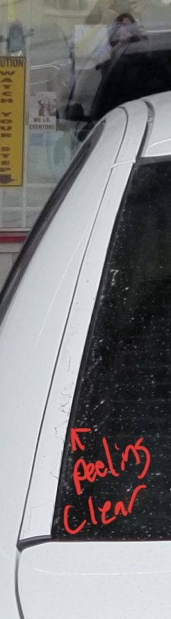

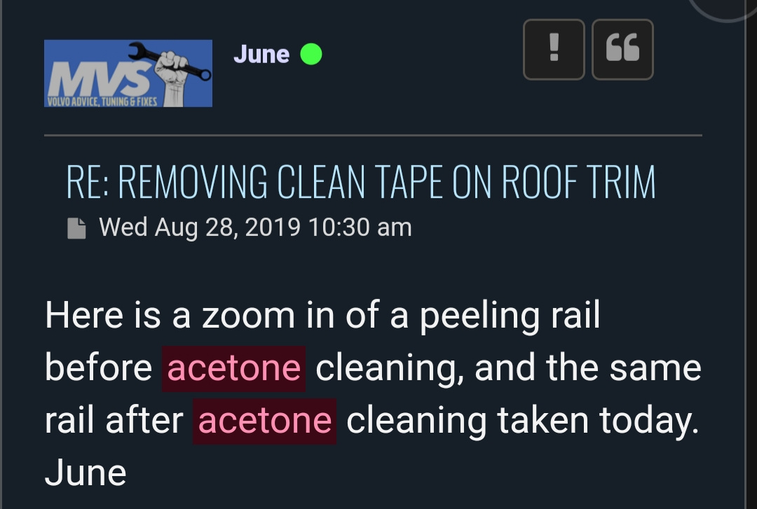

Here is a screenshot from a previous thread and the before and after pictures of my rm car taken from that thread. Use the heading title I left on the screenshot if you want to read that thread. I don't know how to post a link or I would. June
- 20190828_101827.jpg (75.29 KiB) Viewed 952 times
- 20190828_101935.jpg (143.07 KiB) Viewed 952 times
