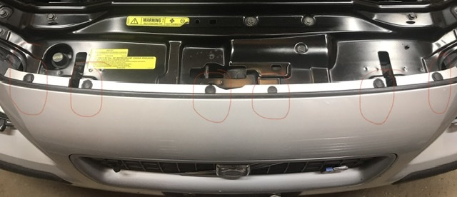

  • 6 plastic retainers visible right under the leading edge of the hood once opened.

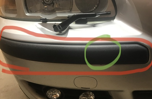

  • Then, with a non-marring pry tool, remove the bumper trim pieces circled in red. Once off, remove the 10/12mm farstners behind the trim pieces. The green circle is pretty representative of where you’ll find these. I said 10/12 because I’ve seen both sizes used. I fact, one car I did had one of each.

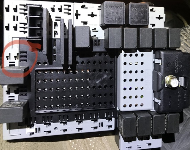

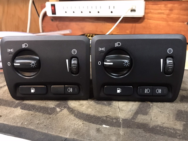

For the fogs, if your car had them originally just hook up the new ones. If the car did not, and you want to retain a factory switch look & functionality, you’ll need a LSM (Light Switch Module - which has the front fog button), a 9441161 relay for your CEM (05 may differ), and CEM programming to permit front fog light function from your new LSM, and obviously fog lights/housings.
On the earlier models they came pre-wired for fogs regardless of if the cars had fogs or not. I’d think your 05 is as well but you’ll know soon enough.
Here’s a view of where your 9441161 relay will need to go on your CEM. Again, 05 may differ as I’ve never owned one.

"Then, with a non-marring pry tool, remove the bumper trim pieces circled in red. Once off, remove the 10/12mm farstners behind the trim pieces. The green circle is pretty representative of where you’ll find these. I said 10/12 because I’ve seen both sizes used. I fact, one car I did had one of each."
I just got my car back together and found out why this might be. I lost one of the official Volvo bolts, so I took my one remaining one to the hardware store and grabbed a metric bolt that seemed the same. The same metric nut from the store threaded onto either one just fine, so I bought it and took it home. The Volvo bolt used a 12mm socket and the hardware store bolt used a 13mm socket for the SAME SIZE bolt! I had no idea that was possible. It all went back together just fine.
