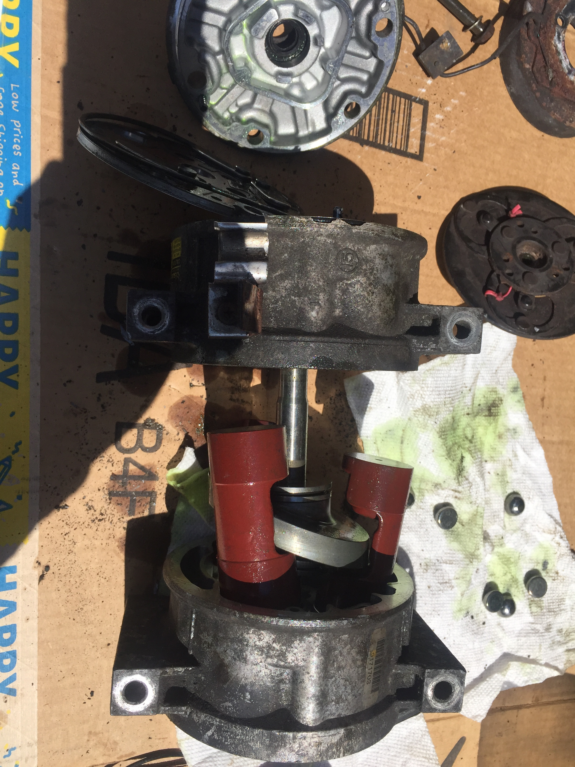

After removal of the clutch and magnet, 6 m8 (12 mm head) bolts hold the four pieces together
Front cap
Body half one
Body half two
Rear cap
Two reed valve assemblies live in each cap end
Bakelite pistons ride in the cylinders in each body half, they have semi spherical metal bearing on top and bottom
They are driven by the eccentric cam in the middle with axial float of the cam controlled by needle bearing, and radial by a rear bearing on the rear plate and a bushing/seal in the front plate

Why do you need 110 x 2mm 'O' rings?
- Posts: 36148
Big o-rings go between each body section and the two end plates seal it up.

This type of design is often used on high pressure hydraulic pumps. It is called a swash plate design (the eccentric cam part in the middle). The hydraulic pumps are extremely close tolerances and do not tolerate any dirt. I have never seen one with front and back pistons.
How are the balls installed and removed? On hydraulic pumps, a foot with spherical bearing is held by pressure against the swash plate. They have no suction capability.
If the bushing is bronze, it should be easy to have some made. I think the O-rings could also be sourced. Someone could start a cottage industry rebuilding these. Hydraulic pumps are rebuilt for about 1/3 cost of new.

Found the reason this was a growler
The swash plate ( thanks Volvolugnut) has damage
