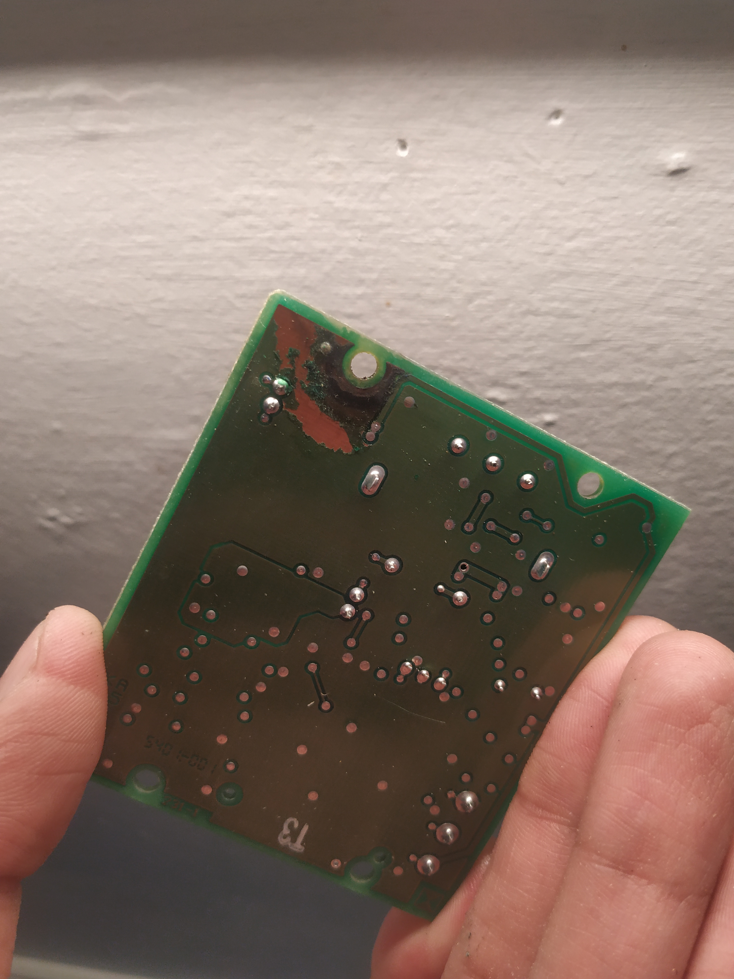

Removed the siren, the internal battery has cooked the board. I suppose that leaves sourcing a new siren as my only choice?

You can try cleaning the board and replacing the battery, put up a photo of the board to assess the damage.

Blech. That’s pretty bad. For the cost of the battery you could wash that with an electronic cleaner and sift scrub brush to remove that Detritus, then try connect the battery and see if it comes back to life.
Ill find specs on battery. Is there a Volvo part number on the battery?
See link to the VRd posted above
It takes 3 2.4v button cells in parallel series for a total of 7.2V. You can also use a 7.2 volt single cell per the DIY
Put some battery protection on your new board if you get it working

That would be 3 2.4 Volt cells in SERIES for 7.2 volts.
