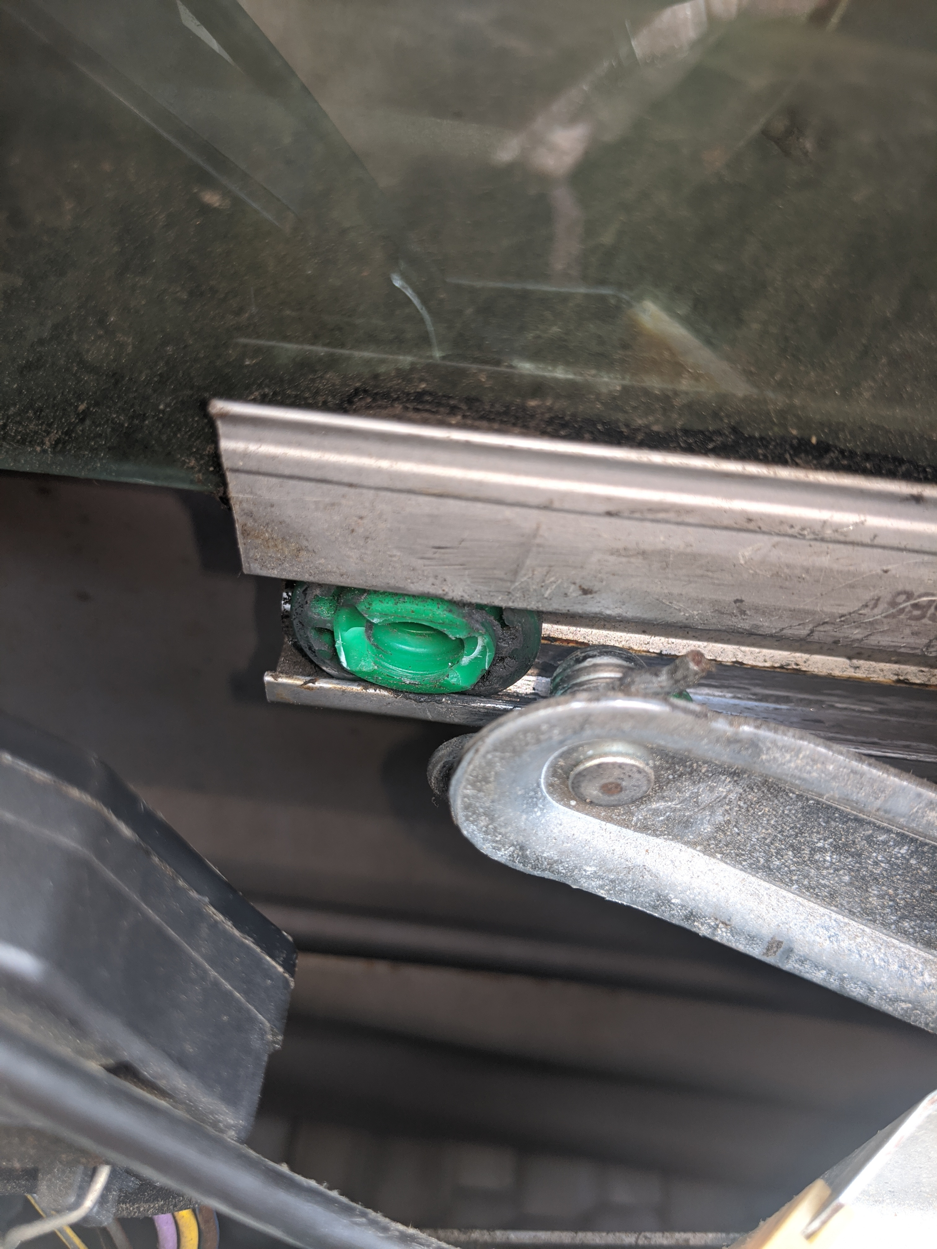

What typically (for me) happens with the window runners is there is a bracket and screw or rivet near the bottom of the rear window runner. These rust and break allowing the window to move wonky.
If you remove the inner door panel you should be able to confirm this. I believe a new runner is available as recently as 2 years ago from Volvo and wasn't to stupid a price. If I recall the newer version is rivet only for the lower mount. The older version (NLA) was designed for a screw mount. You can use wither variant.
While it was fiddly, and requiring a little force, it was possible to replace the guide without removing the window.

I think you're spot on, as the leftside rail is kinda wobbly as the bottom rivet seems to be loose. The plastic rail clip/guide also seems to be broken, so I'll fix that first, but it could very well be caused by that loose rail.scot850 wrote: ↑03 May 2020, 10:58 What typically (for me) happens with the window runners is there is a bracket and screw or rivet near the bottom of the rear window runner. These rust and break allowing the window to move wonky.

I had to replace my guide, and now I have issues with the window being very slow when moving in that guide. Any ideas?

When you have access to look at the regulator, confirm the flat metal arms are not bent. They are not stiff enough o last forever. Dorman Products has a reasonable priced replacement without buying the motor.
