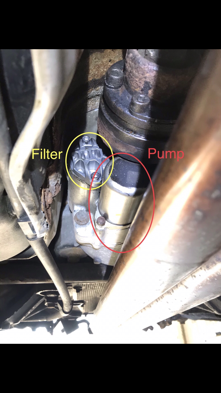

One note of importance here, since you are doing this on an exploratory basis, I would strongly encourage you to invest in a new filter and AOC oil for your Haldex/AOC. There is a pretty good chance the filter in there is the original, and the fluid is likely as well. You cannot change the filter without removing the driveshaft and also the flange/oscillation damper on the front of the AOC/Haldex. You will also need an impact to remove the 24mm nut holding the oscillation damper on. .
Below is the filter & updated “finned”-for-cooling cover. I’m sure you could get it cheaper elsewhere.

You can look at your AOC/Haldex to see if it already has the updated cover. If it does & has been changed recently (and AOC oil) you can skip this. If not, I would not omit this.
