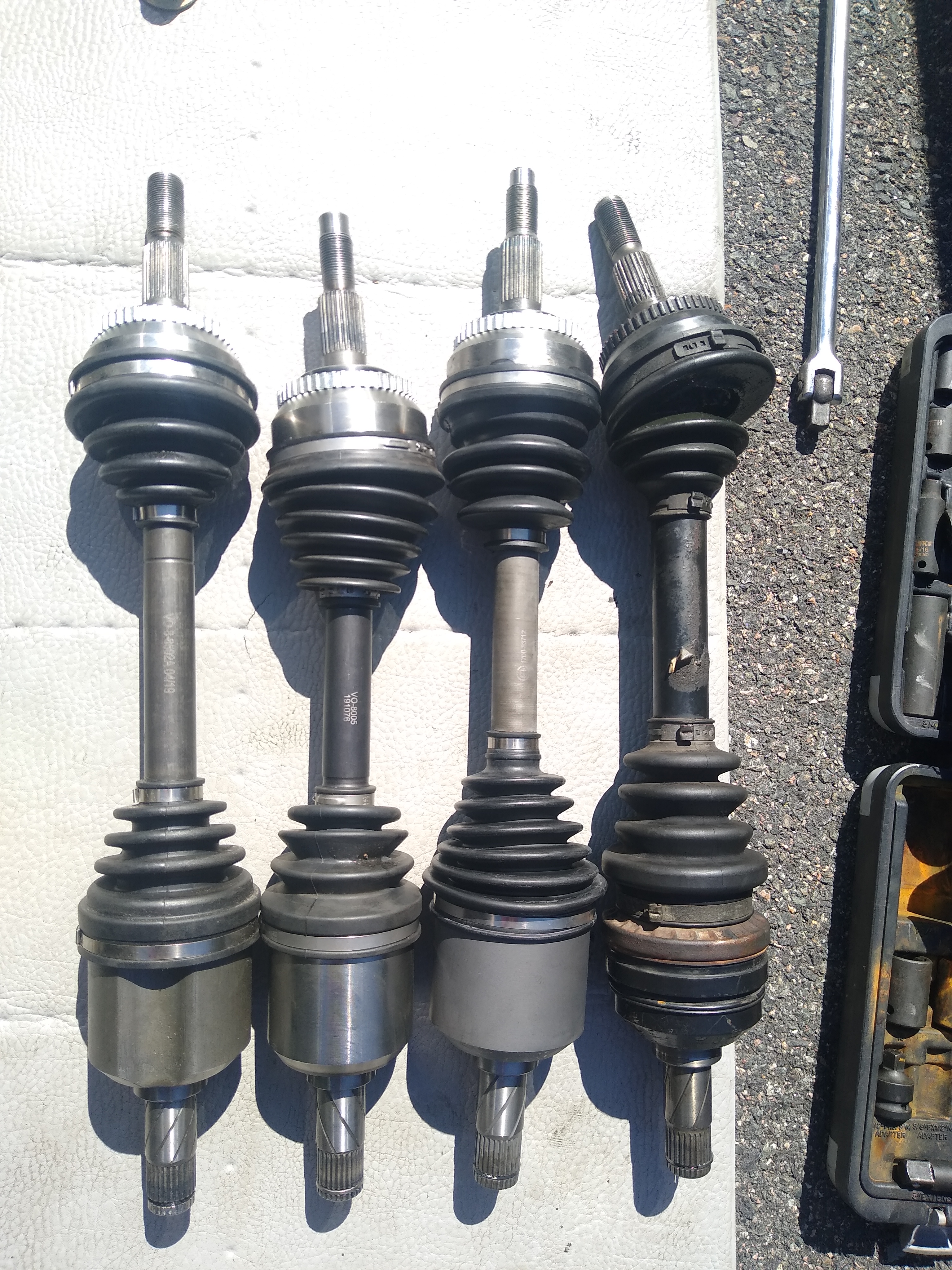

- firestarterpro
- Posts: 79
- Joined: 25 Feb 2015, 04:08
- Year and Model: 850 NA - 1995
- Location: Dallas, TX
- Has thanked: 2 times
All four of my axles look different... i dont feel so bad as a mechanic.
From left to right (the same order as I installed them):
1 APIs 1st shipment
2 Duralast Gold (AutoZone)
3. APIs 2nd shipment (currently installed)
4. Old Volvo
The 2nd API seems to be the right length, the 1st was slightly smaller when you compress it, so i put it in instead of the old one. Also, i messed up the nut in the old one.
Wish me luck
Also, I'll never buy an aftermarket volvo axle ever again
1 APIs 1st shipment
4. Old Volvo
Wish me luck
