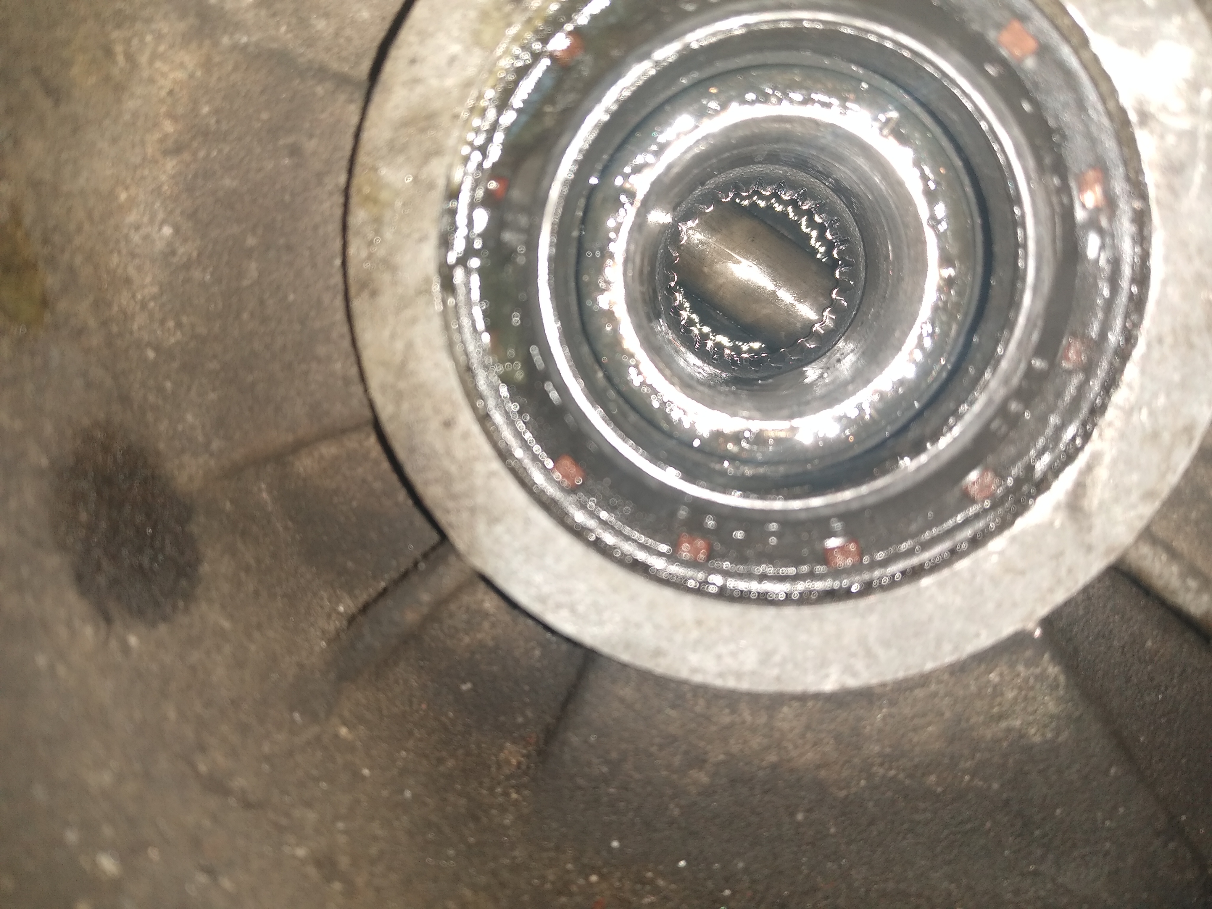

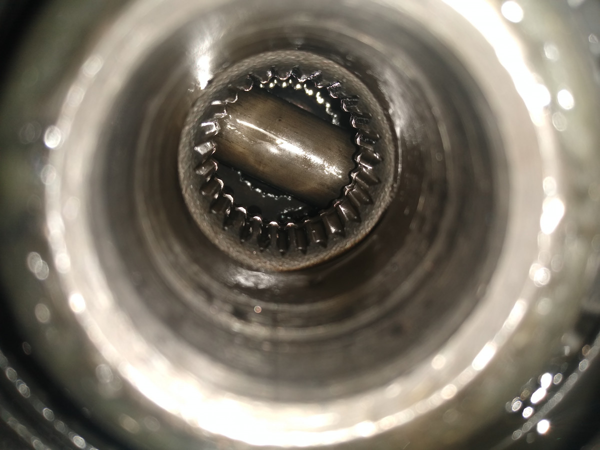

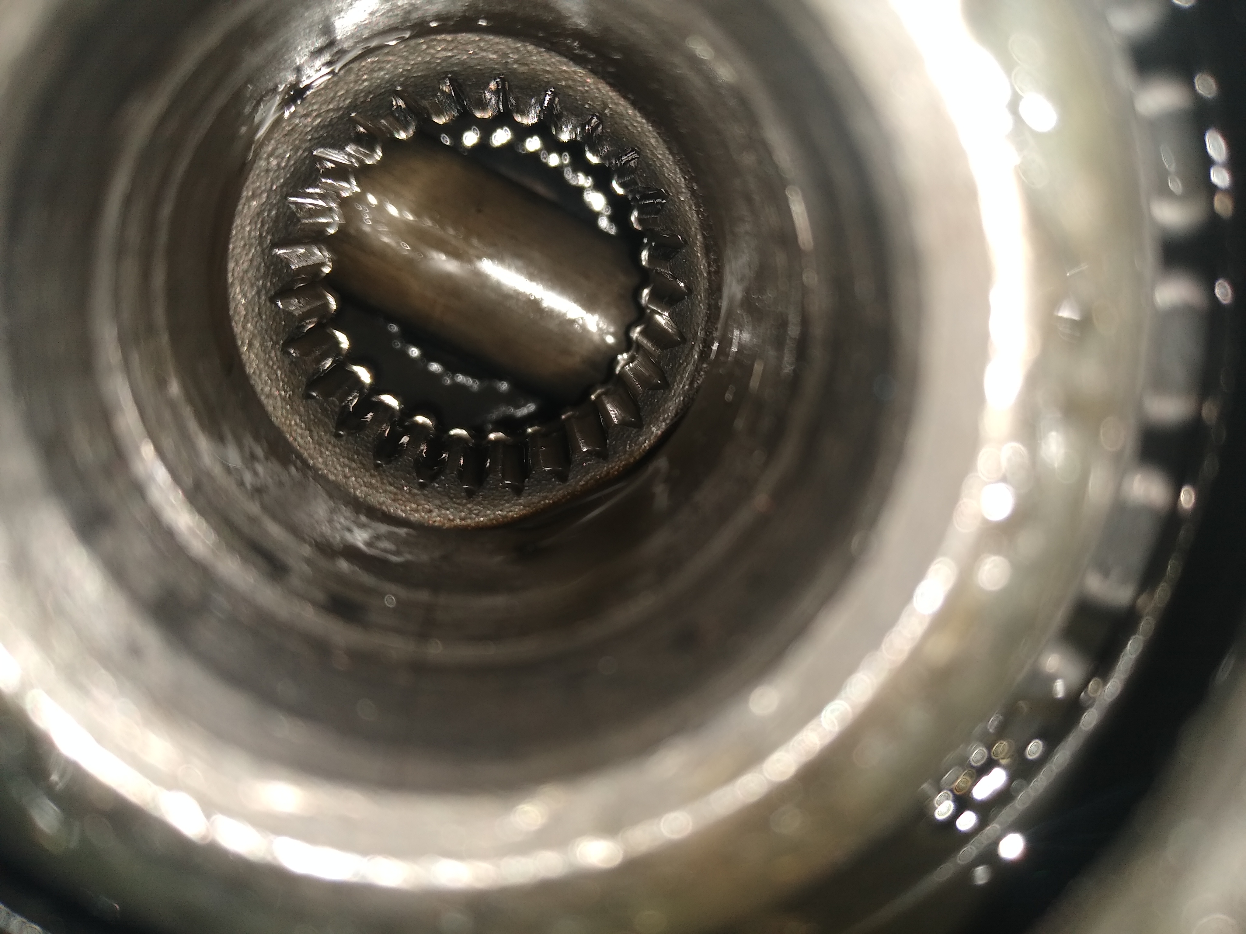

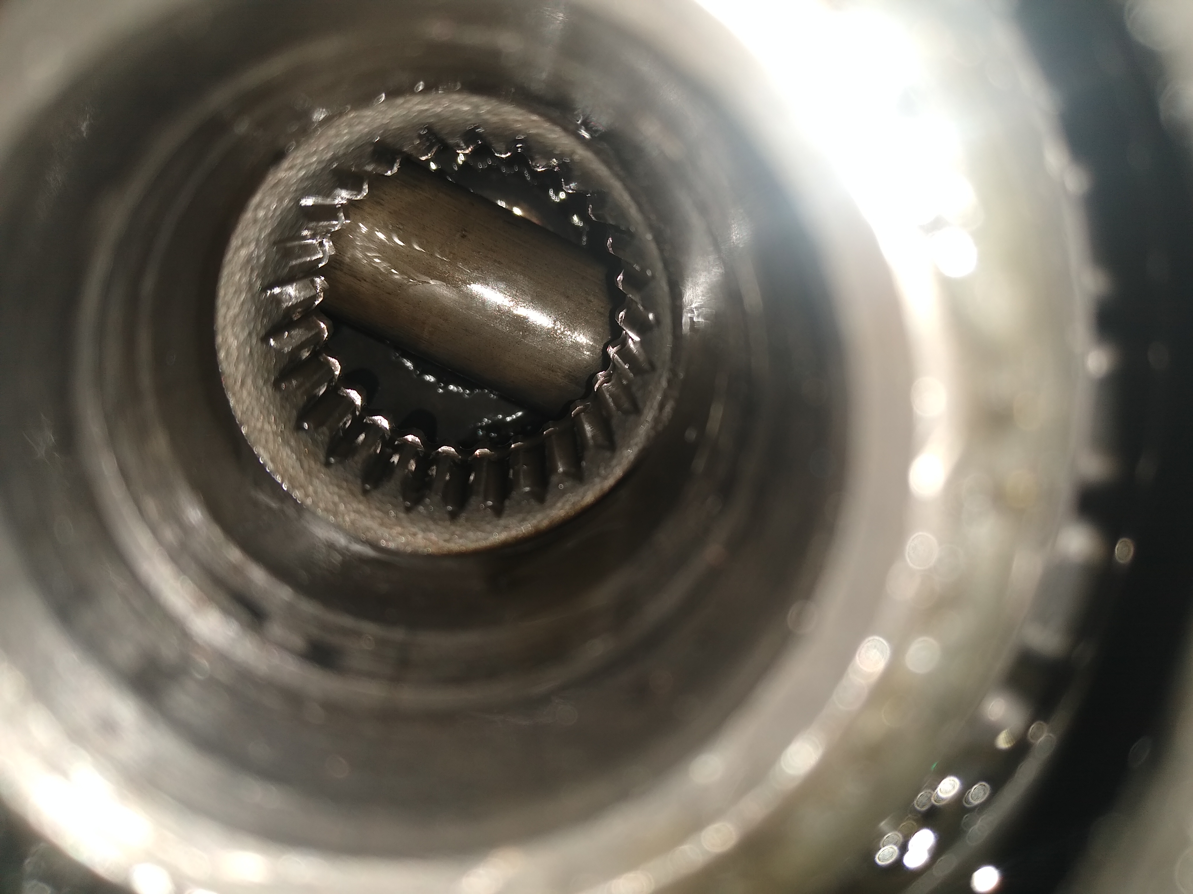

Before I put in the 3rd one, I took pictures of the inside.
I felt the groove and the edges the circlip goes into felt flush

Thanks for the photos. It is hard to see clearly, but I don't see damage to the C clip groove.
Another crude inspection idea: get some modeling clay and press a ball into the groove area. Carefully remove the clay and inspect the groove impression. This may reveal something you can't see.
