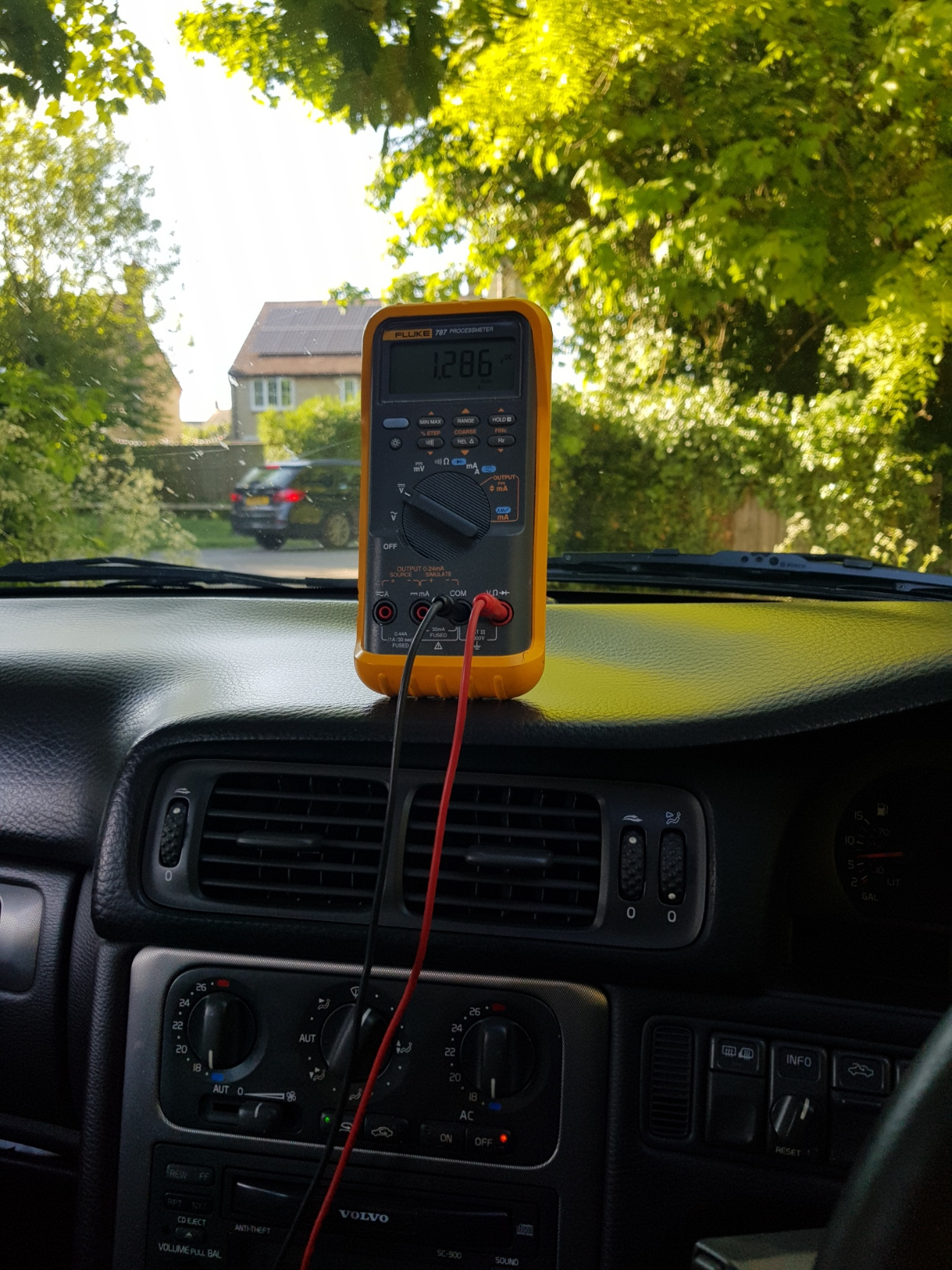

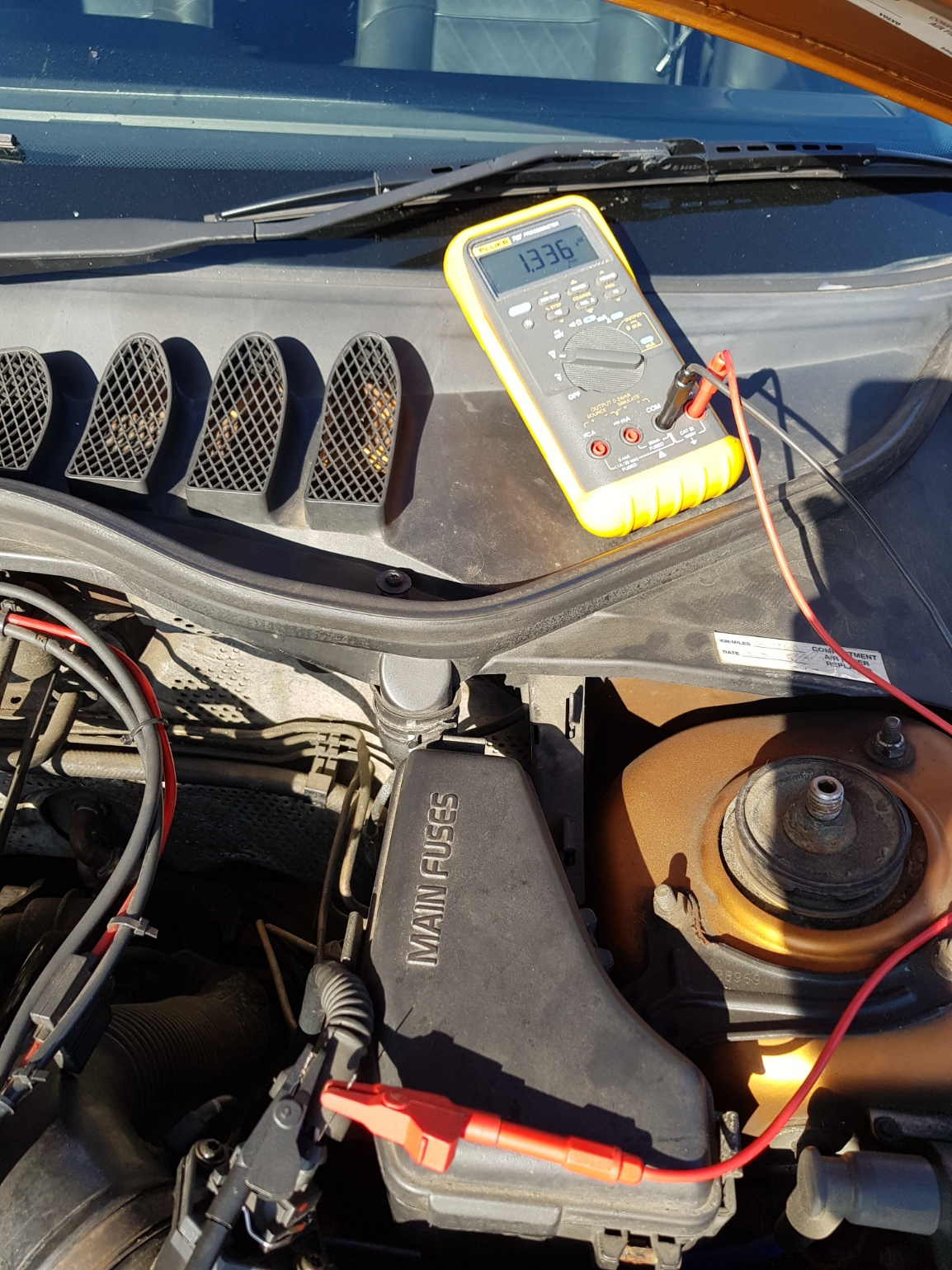

I'm still working to investigate a sound which I suspect to be pre-detonation at full boost+high revs and I've been looking in detail at my MAF. This failed a couple of years ago and was replaced with a pattern part. I have back probed the socket over pins 1 and 4 and am getting a range from ~1.3v at idle to ~5.7v at WOT and high RPM.
I've been looking for more information and the closest I've found is that from some forum posts I believe the ECU only reads up to 5v and I found this video where they are reading 1.7v at idle, albeit over pins 2 and 4 rather than 1 and 4 (1 and 2 are both grounds, when probing the MAF I found continuity between pin 2, a ground and pin 3 the 12v feed, so I believed that pin 2 is the ground for the 12v feed wire).
My car is a 1998 V70R, does anyone else know the ideal voltage figures for this?

1.7 volts at idle is listed in Alldata, going up linearly with air flow of course
I don’t know what the supply rail voltage is, so it could cap at either 5 or 12 volts, or even something in between
MAF failures are proportional to how much you fool with them, by the way.
Get the pin outs from the Bosch documentation. Look for the Bosch part number and google that. Continuity tests on digital circuitry can hurt stuff so be careful doing that
My ME7 MAF pulls supply voltages from both the injector amd the sensor ring but your earlier At is probably different. Wiring diagrams showing this are on the web and also linked in threads here, by agreement with Volvo.

Thank you. Supply voltage to the heating element is 12v. The voltage over the signal loop on mine seemed to cap at 5.7 for approximately the last 1000 rpm in the range.
