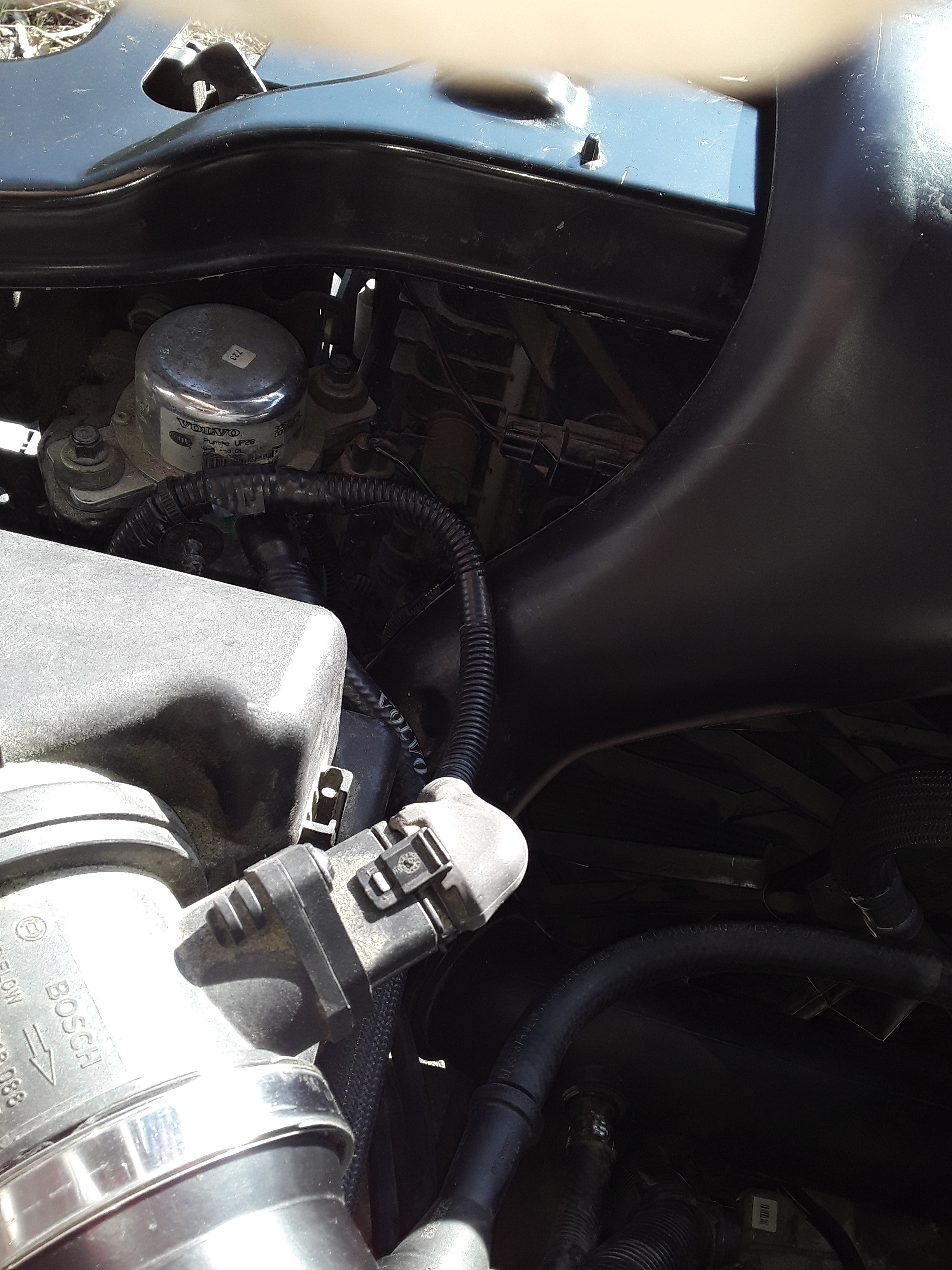

Ok I have 2006 Volvo xc90 and I have replaced battery and checked starter and solenoid both seem good ,turn key and the only sound is coming from ,... possibly a fuel pump ,I'm not sure I'll include a pic of it and is constantly engaging . Other wise when I try to crank it bypassing the relay the starter engages and motor turns over but is not actually cranking up just turning over I'm lost at this point

That's the brake booster vacuum pump. Normal to have it come on to supply vacuum to the system. Longer or shorter duration of run time due to whether your brake booster has a leak or not.
I don't think you can start one of these bypassing anything. Are you getting fuel to the rail when you turn the key? Are you hearing the fuel pump come on for 2-3 seconds when you turn the key to position II? You can temporarily disable the vacuum pump by following the wiring towards the firewall and unplugging the switch there at the top. It's the one with the connector on the top and 3 branches of vacuum hoses connected to the bottom. That might make it easier to hear if your fuel pump is working.
