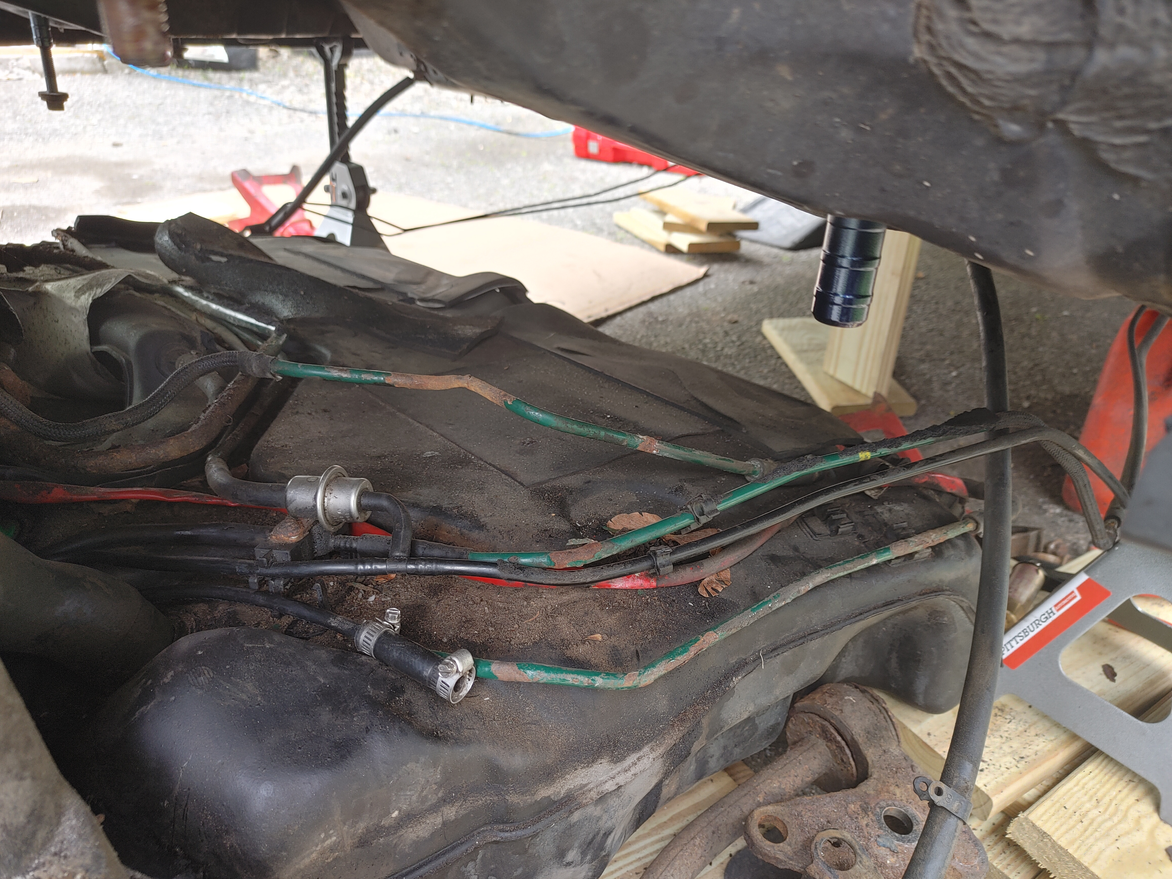

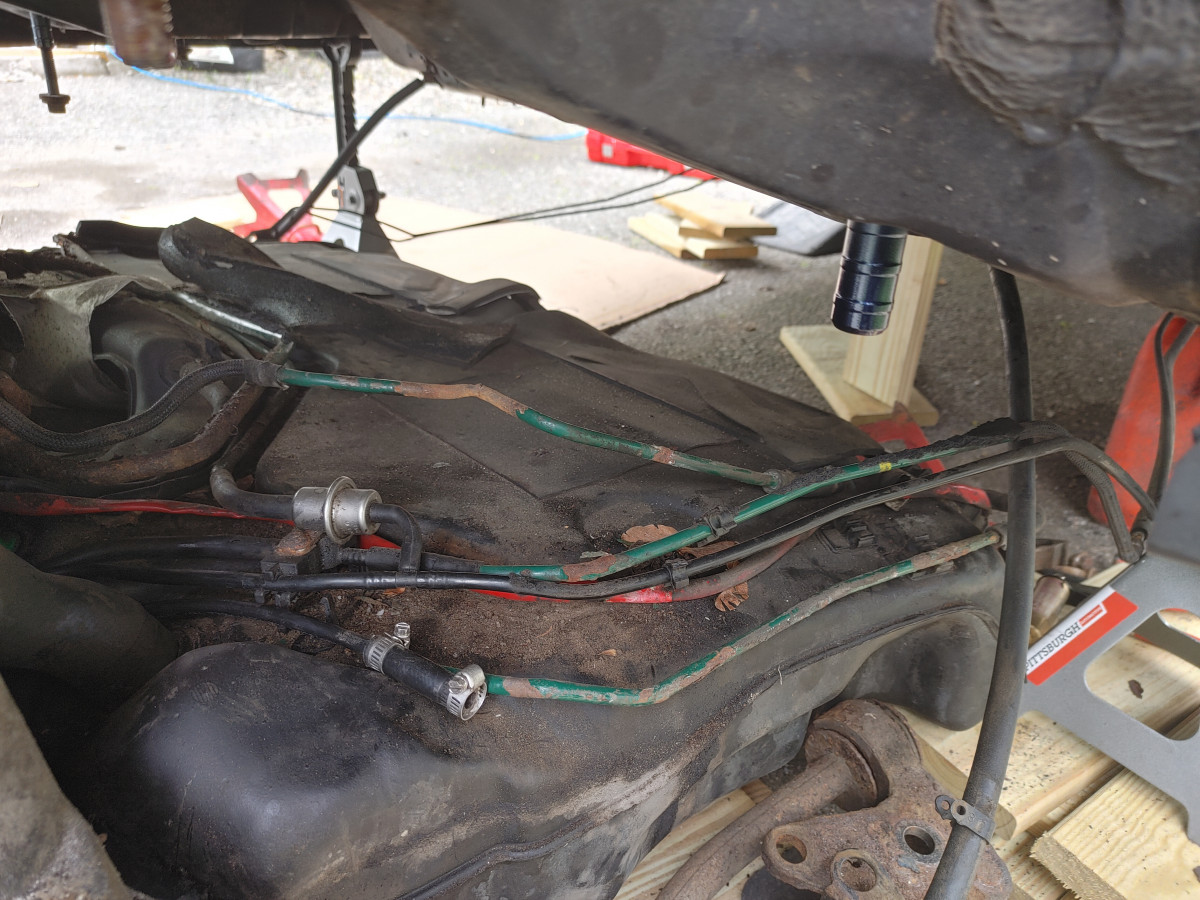

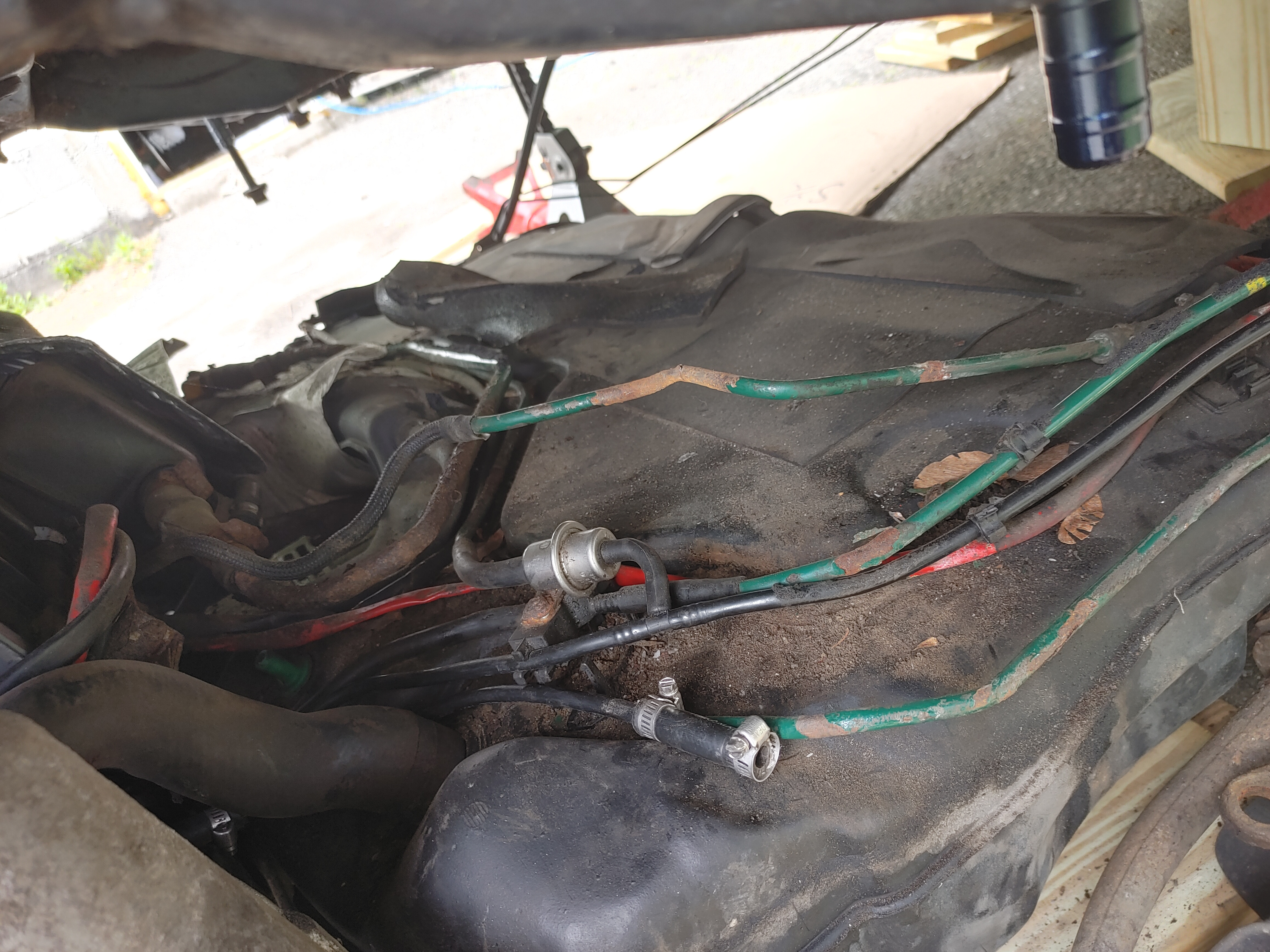

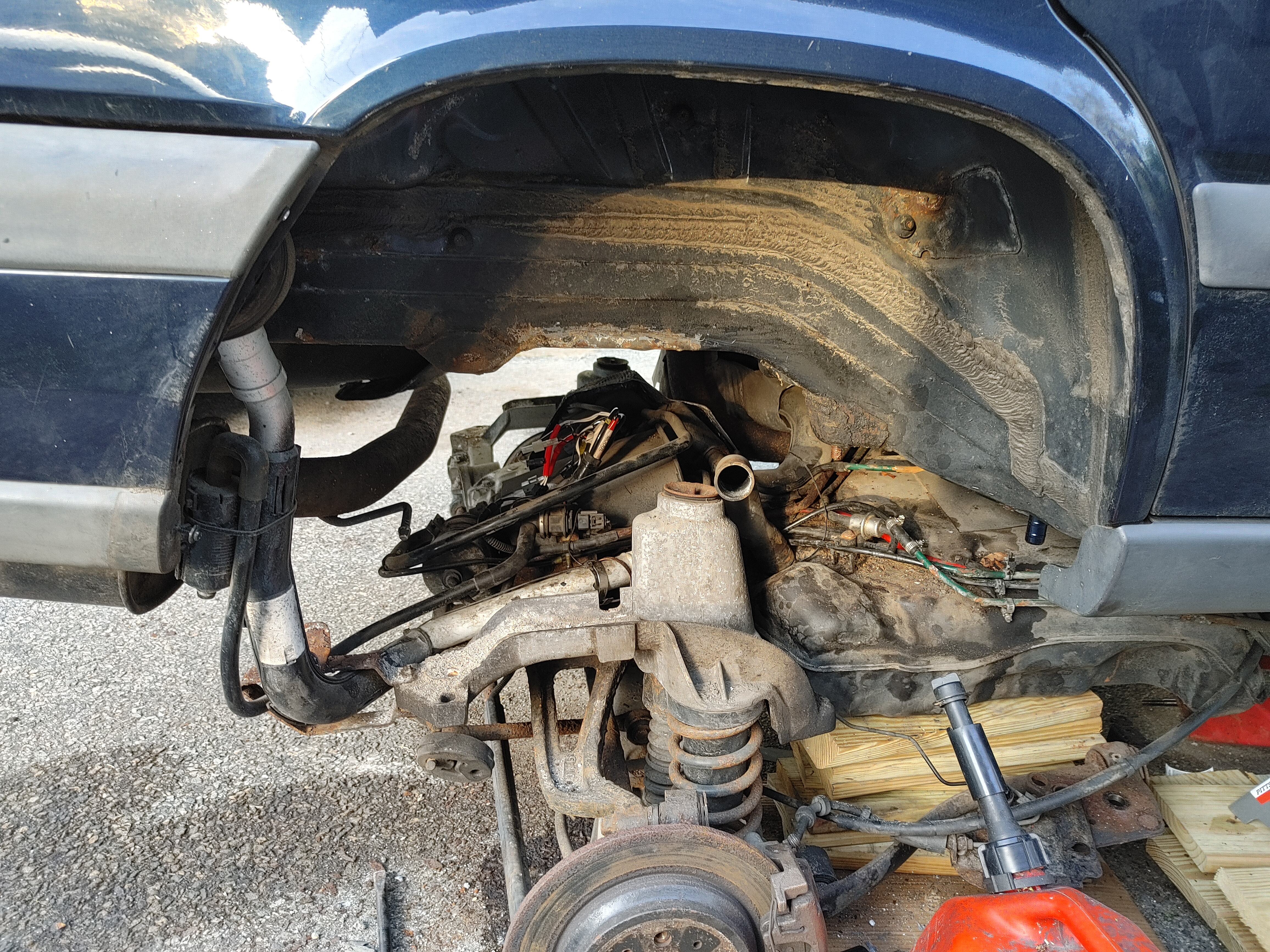

Good morning, so my car a couple weeks ago decided to start spewing gas from the top of the tank somewhere. So I decided to drop the whole rear end. Honestly not as bad as I expected. Here are some pics of the progress. The front two bolts snapped as expected. Now seeing the the condition of everything, I'm thinking my plan it to do the lines to get her running. Then see about getting another sub frame to rebuild to install later. I'll post updates as I go.

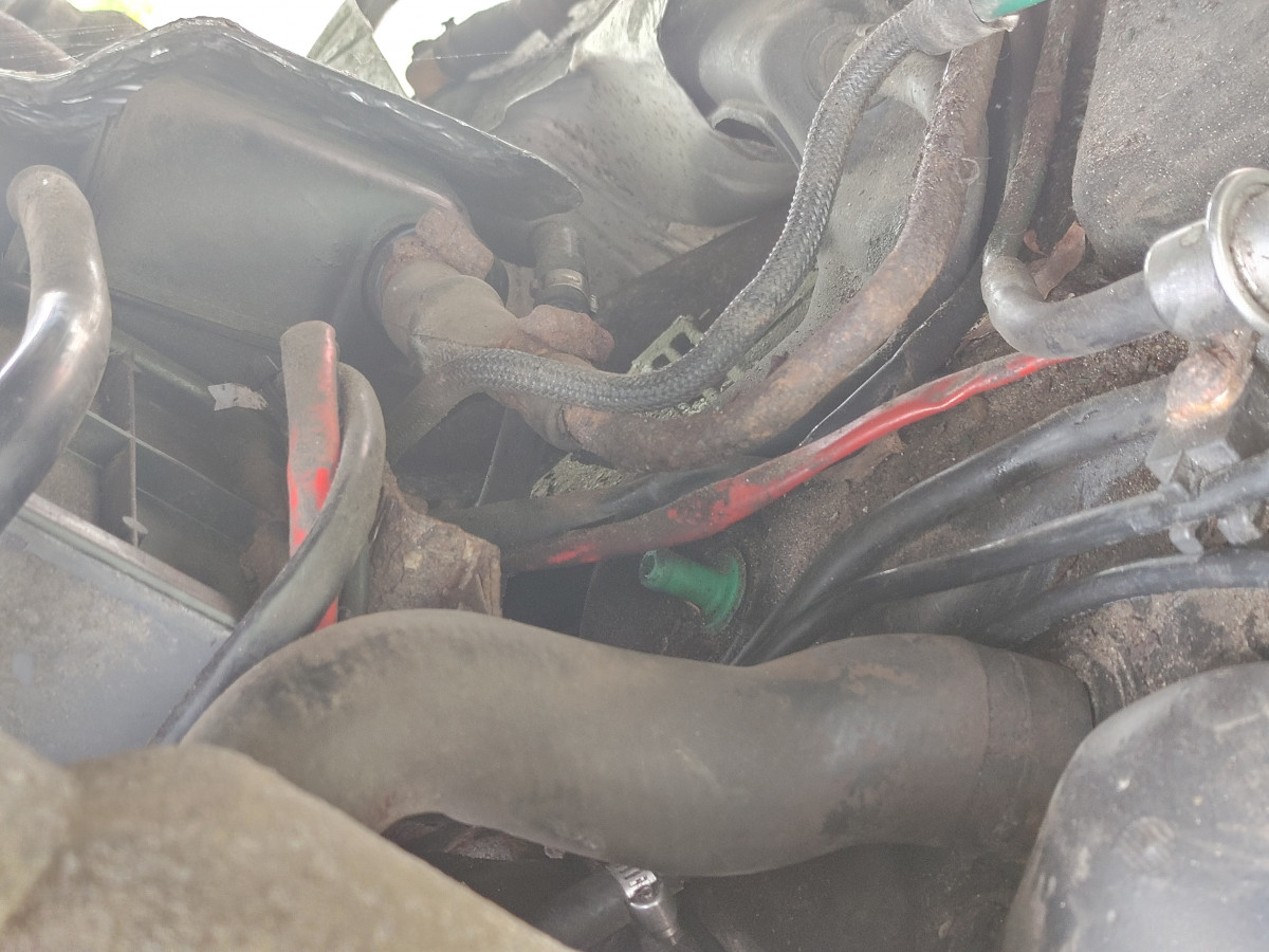

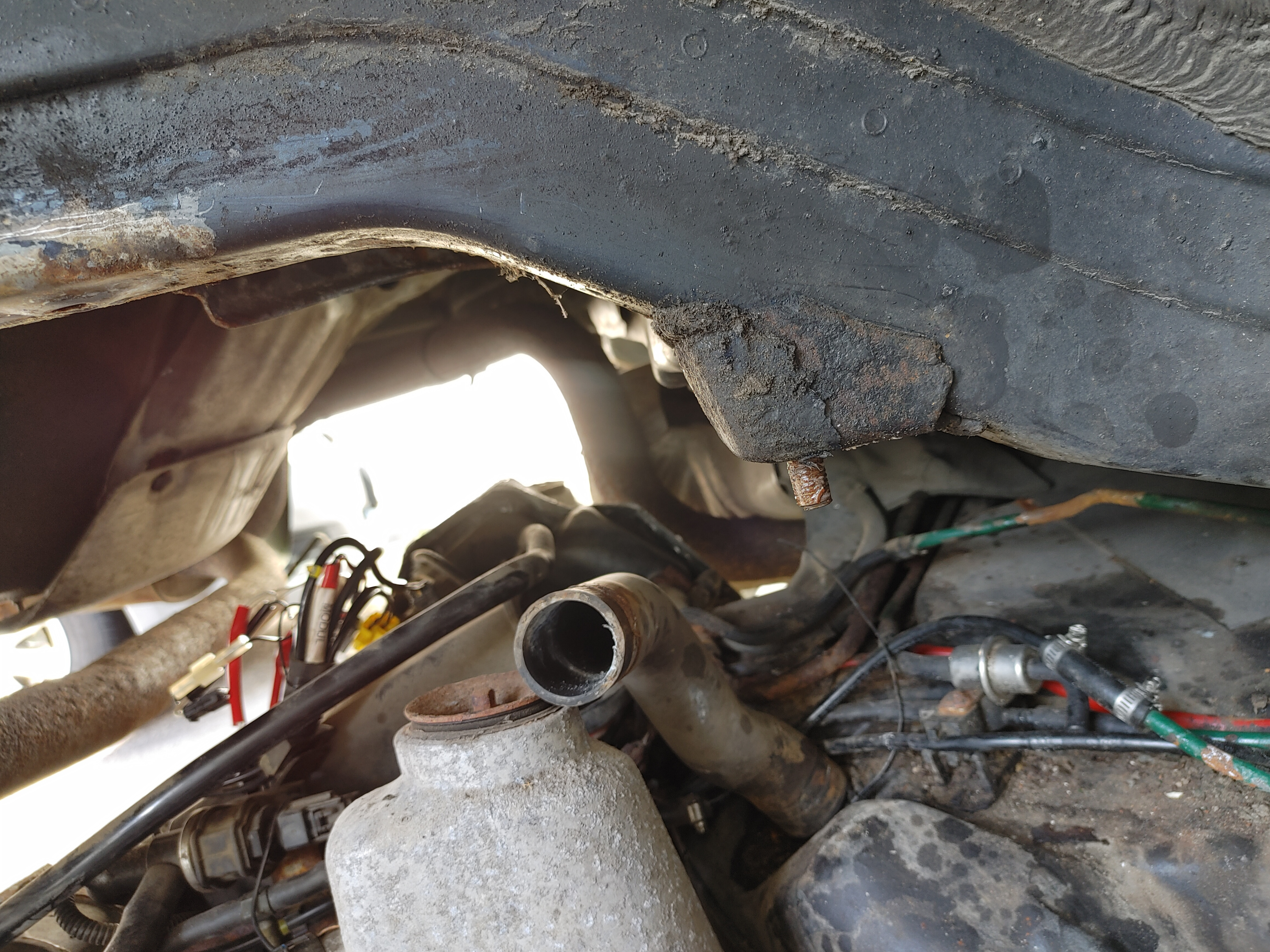

Sorry my phone died and life just got away from me. Your thread had helped immensely thank you! I unfortunately was in a position that needed to get the car back together quickly. Got her together and running well. My plan is to see of i can get another sub frame and take my time building it. Here are some pics I have. I don't have any of the fixes I made because I was under the gun and had to kinda slam it back together.

Apart from lots of rusty looking parts, what was the actual issue? There was another member suffering the exact same problem in terms of a leak from the top of the tank somewhere and was trying to drop the sub-frame also on his S70 AWD.
The sub-frame looks in pretty good condition from what I can see. There is some surface oxidation but no obvious sins on the 2 mounting 'rail's' where it is bolted to the main frame. The rear portion is usually the worst.

The return line was rotten through where it makes then turn towards the filler neck. The sub frame has corroded around the bolt holes and is getting thin. I'm hoping if I can find a decent one and take my time building it, i'll let you know when I get to that point if I need anything. I don't think it will be anytime to soon. Thanks
