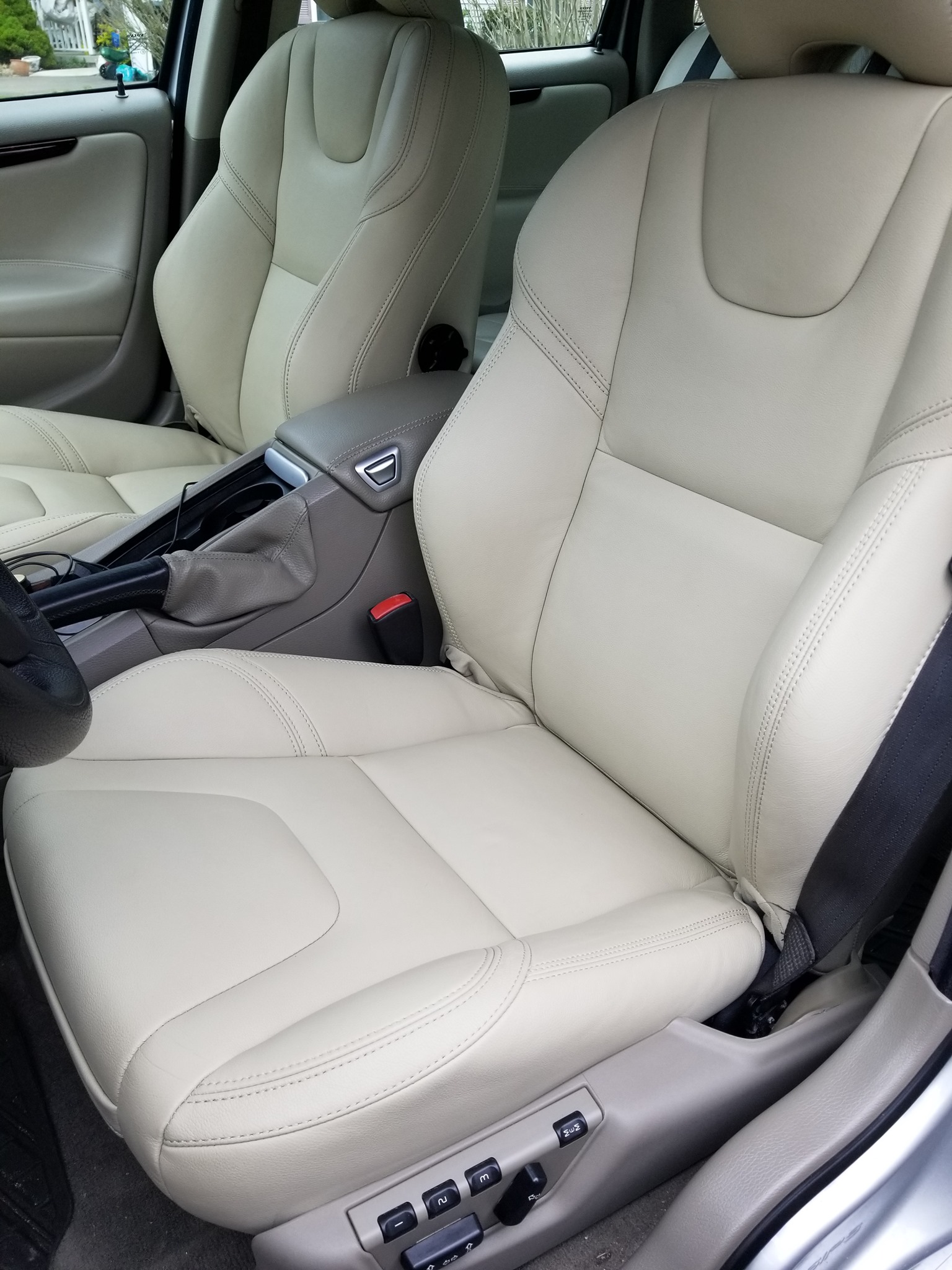

A little weekend project! P3 sport seats from a 2017 V60 swapped into my 07 V70. Swapped the P3 skins and foam over to my P2 frames. Spliced in the P2 seat heater connector and calibrated the OWS with VIDA. Done! Beats trying to find decent 10+ year old P2 sport seats. These seats had only 6k miles on them, so about as new as you'll find!
2017 front seats swapped into 2007

Also
The 01-04 years are harder since the seat frame is completely different. You'd have to swap the 01-04 electronics to an 05+ frame. Modules are the same, but motors are in different locations. Not impossible, but a lot more work.
