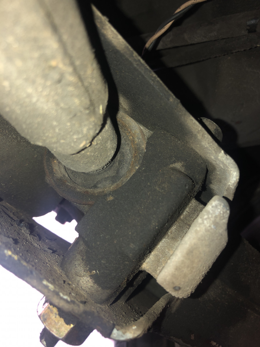

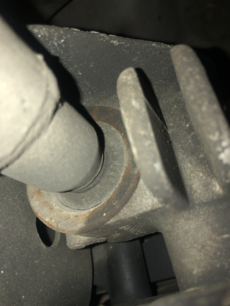

How do my Delta Link Bushings look to you?
- Chuck W
- Posts: 1325
- Joined: 24 Dec 2014, 10:45
- Year and Model: 97 854 T5
- Location: Indianapolis, IN
- Has thanked: 97 times
- Been thanked: 340 times
The rubber looks a little old, but they appear to actually be in one piece.
Unless they are broken, or your in replacing the outer link bushings, I would just leave them.
- Posts: 15487
- Has thanked: 2199 times
+1 First one looks ok, but second one is starting to get there but not yet.

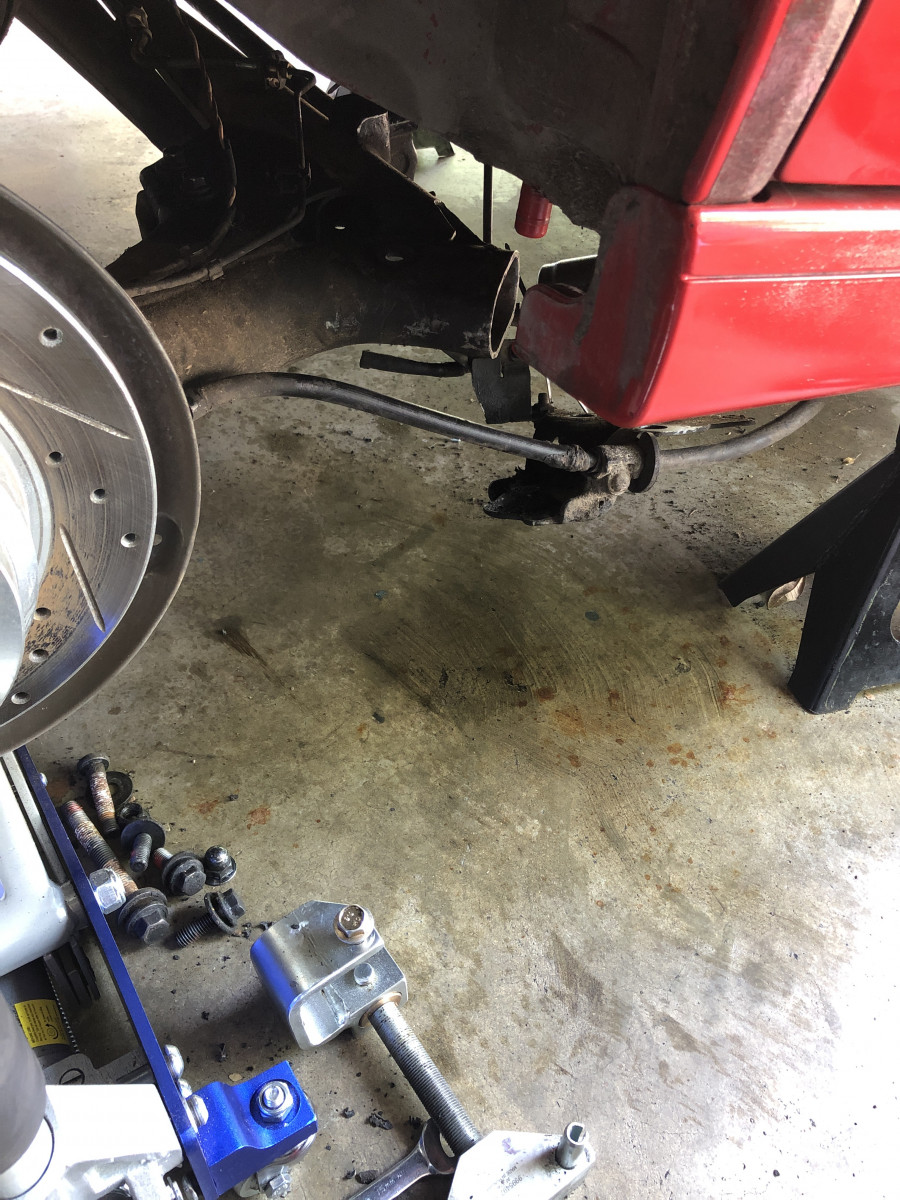

I just raked a drill across the top and plunged it in the corners a few times. Popped right out with the tool.
For the Delta link bushings, I actually ended up lowering the whole rear suspension to the ground with the brake rotors sitting on wood blocks. Just didn't have 2 wheeled jacks. Shocks disconnected but springs in the seats. I HIGHLY recommend having 2 rolling jacks under the spring seats. If you don't, be prepared to muscle the assembly around.

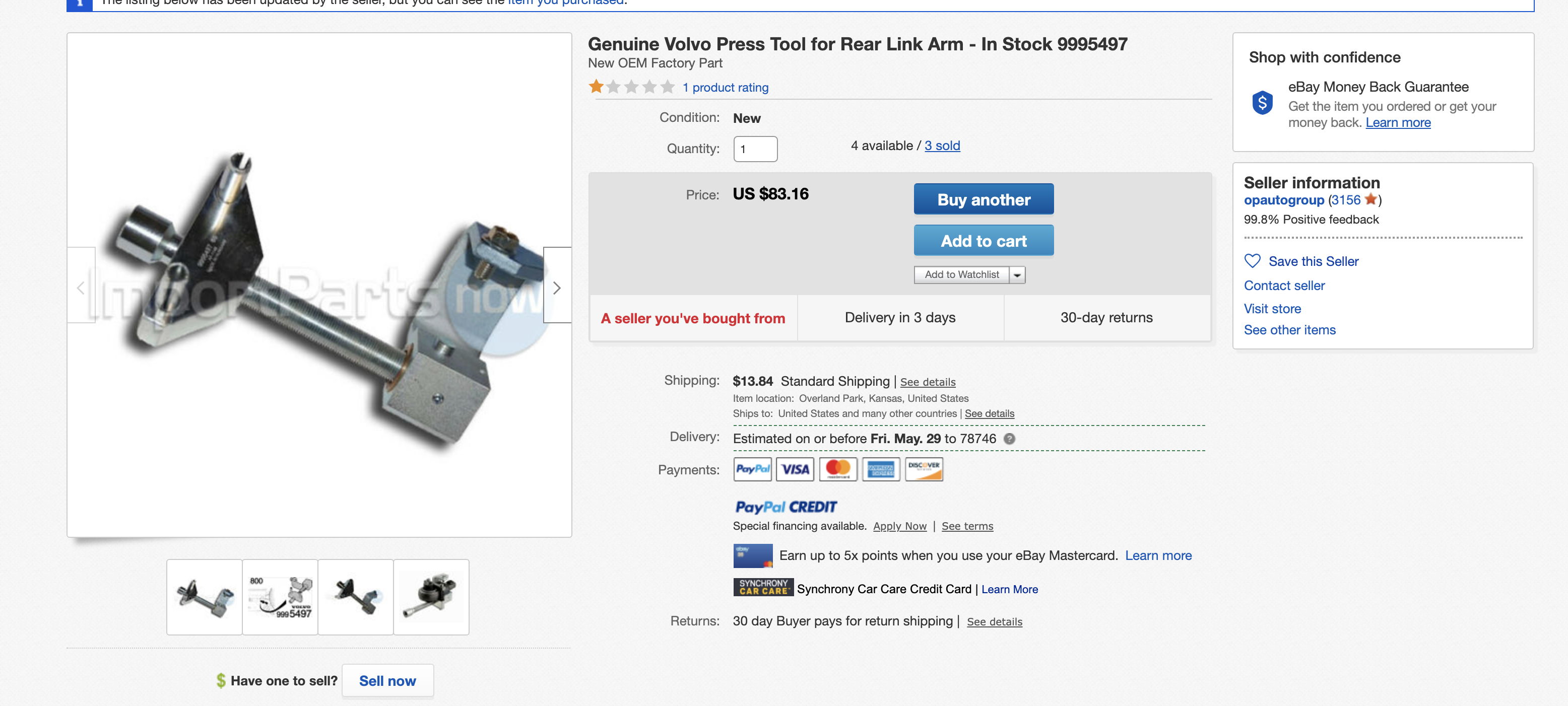

Just curious - where did you find the delta link removal tool ?
