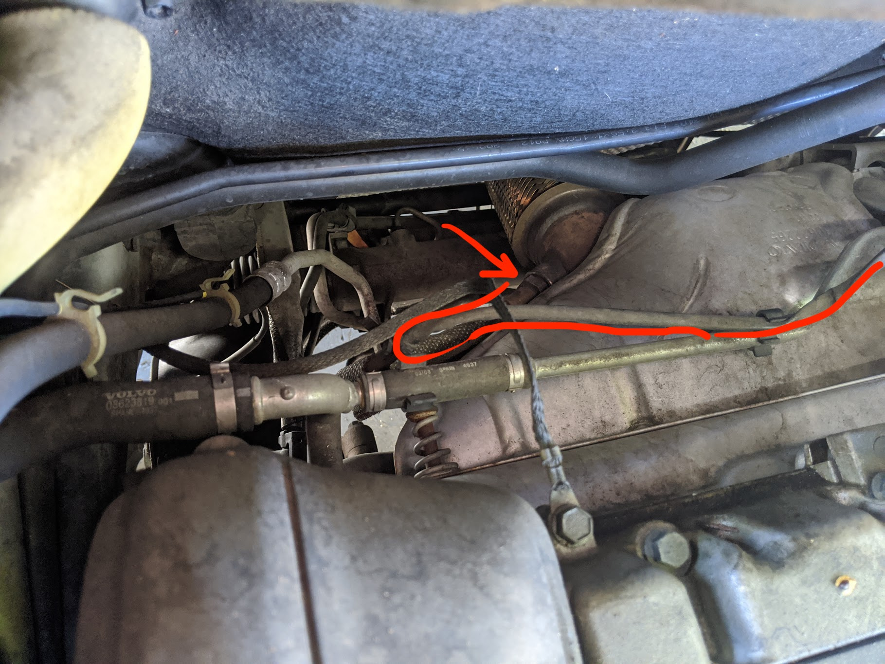

First post here! My 04 XC70 2.5t is throwing P0030 code: Heated Oxygen Sensor (HO2S) 1, bank1, heater control - circuit malfunction.
I reset the code multiple times, but it keeps popping up. Replaced OxygenSensor fuse, but problem still present.
I read online that "Circuit Malfunction" could be due to some loose connection rather than a faulty sensor, but I thought I'd check both. So wanted to unclip the sensor connector and clean up the pins.
Noob here :oops: Can someone please confirm if this is sensor1 bank1? Taking picture from top, passenger side
I traced down the wire with my hand and it goes all the way to driver side, underneath the air intake and fuse box. It's so hard to get to it, I can't even see it. Any thoughts on best way to reach out to the electrical connector of the sensor so I can unplug it?
Thanks a lot!

Update: I snuck in my phone to see how the electrical plug of the sensor looks like. Any idea how to unplug it? I tried many times but couldn't (again, I can't see anything, so just using my fingers). Didn't want to use force so it doesn't break. Please help this new noob here :P

You have the right sensor. We only have one a Bank of cylinders on our Volvo’s so it’s Bank 1
The first sensor before the cat is sensor 1.
You need a small right angle pick. Get that into the hole in the grey release tab and flip that up 90 to release the connector.

abscate wrote: 16 Feb 2020, 02:14 The first sensor before the cat is sensor 1.
Oh didn't know there was another one after the cat too (noob here :oops: )! Would the one after the cat throw a different check-engine code/description (say, bank1 sensor2)? Just trying to see if I need to buy both sensors or just the one I posted earlier.
Thanks a lot for the pick tip, didn't notice that hole! Will give it a shot and see!

That right on the second sensor. That sensor just β€œ monitors β€œ the cat efficiency so has less to do with good running.
It has a separate set of codes if the sensor or the heater circuit fail.

I replaced the upstream oxygen sensor (shown in pictures above) and it worked like magic! Bought the Bosche one from FCPEuro. The error code disappeared right after installation. Thanks a lot!

That’s probably about a $400 job at the dealer, well done!
