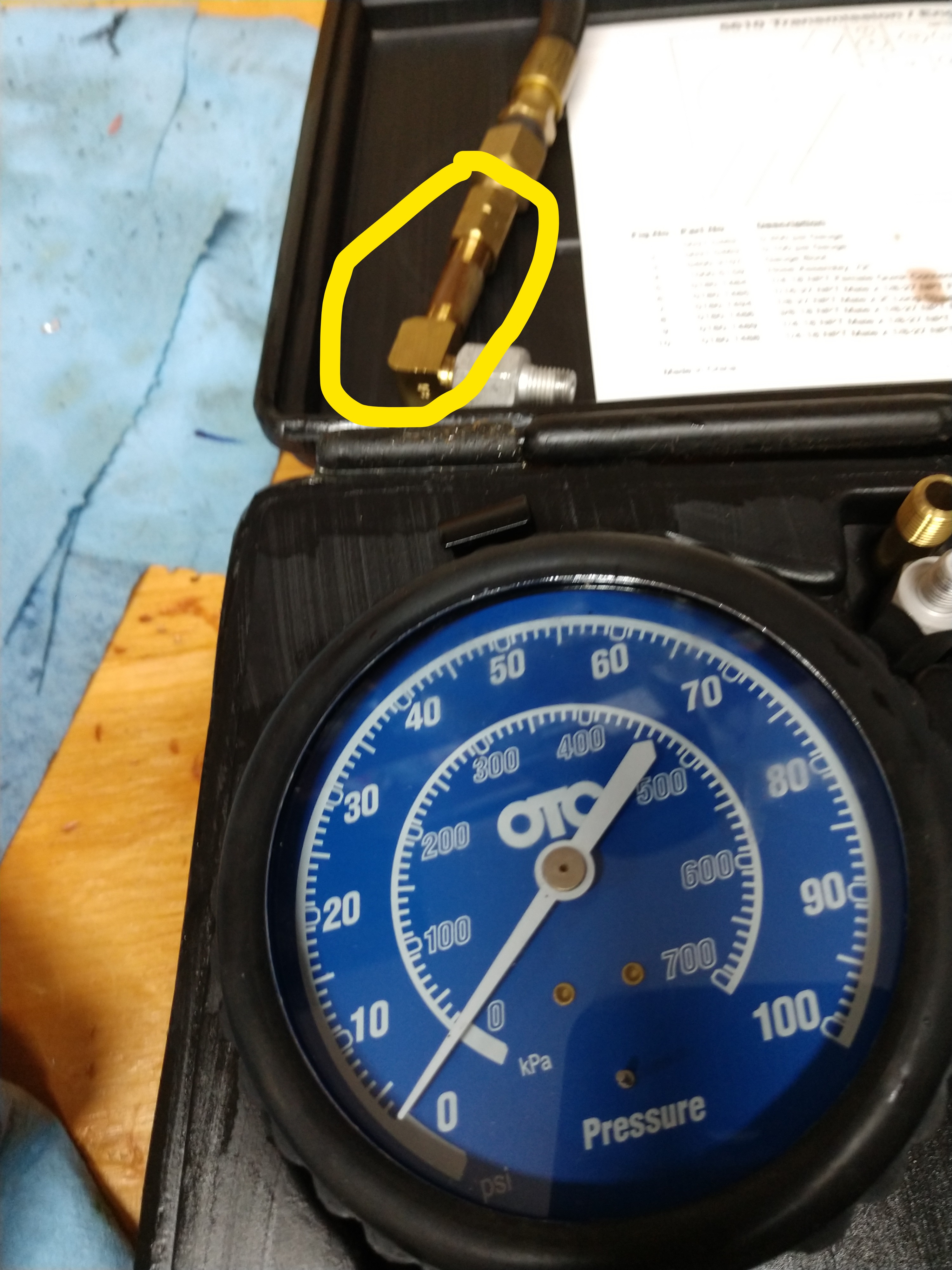

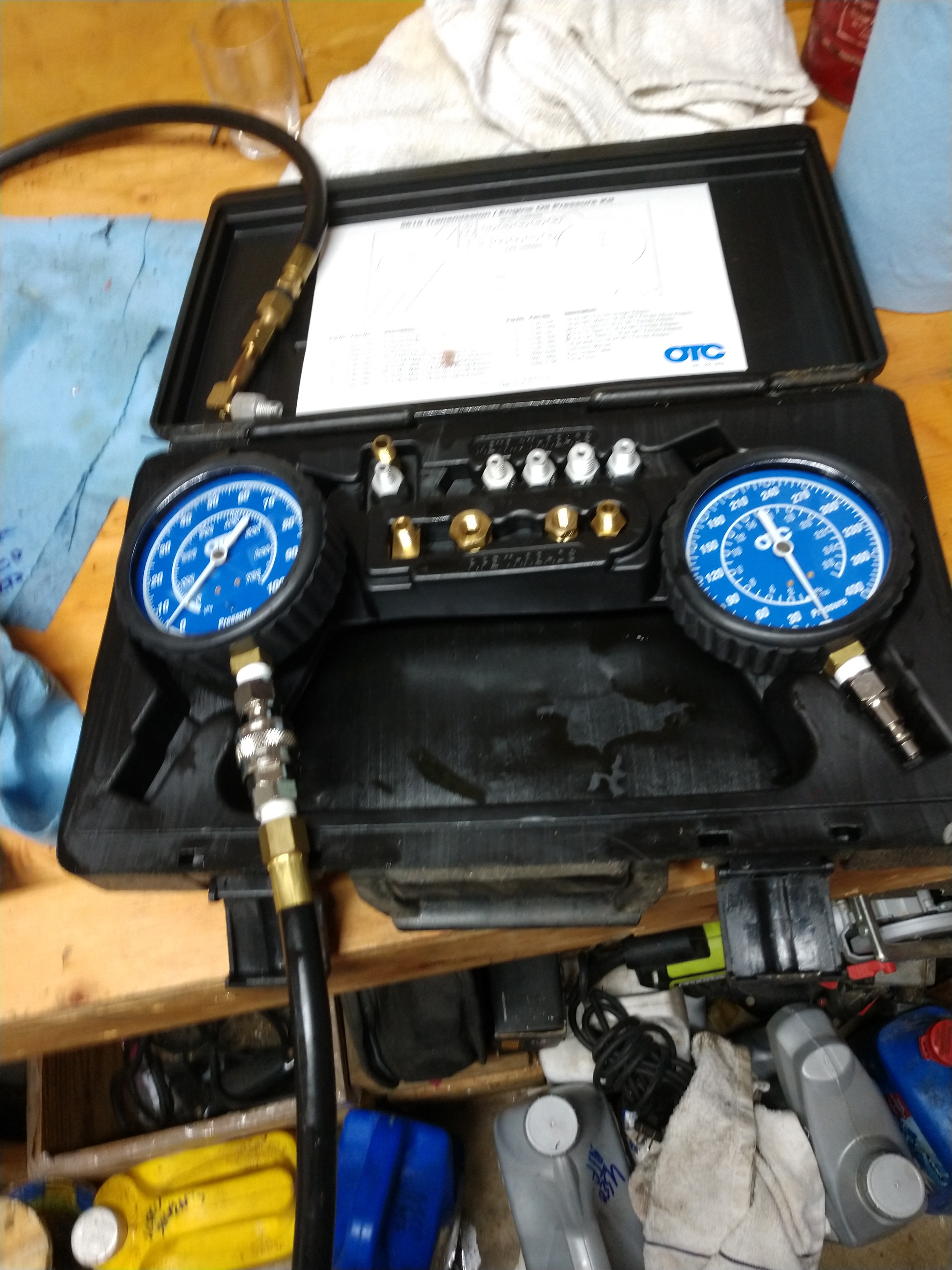

Here are some photos of the OTC 5610 pressure gauge set I purchased for about $50 and looks like it's $60 now; still cheaper than going to a transmission shop though. I did have to purchase a 90 degree elbow, coupler and short extension piece for access to some of the pressure taps. These items are standard 1/4 npt fittings you can get at Lowes, Home Depot or a hardware store. You would use the 0 - 100 psi gauge to look at the lower pressures values such as the main shaft lube pressure value (8psi in reverse and 5psi in drive at hot temps, 30 psi cold or at least greater than 10psi cold) and SLT at idle 5 psi. The kit has a fitting for the transmission pressure taps and in one of the photos I circled the pieces I added to get access to some of the pressure taps.
For the reverse jerk problem you're having I think you should look at the main shaft lube, SLT, C2 and C1 pressures using the Sonnax tech info and attached shift pointers file. Looking at the pressure levels would help you determine the condition of the pump, filter and bushings. Assuming the valve body is functioning properly any pressure readings out of spec would point to these other areas of the transmission like a clogged restricted filter or worn bushings. I haven't done this but I would expect you could also use VIDA DICE to activate solenoids and monitor pressures for troubleshooting.
