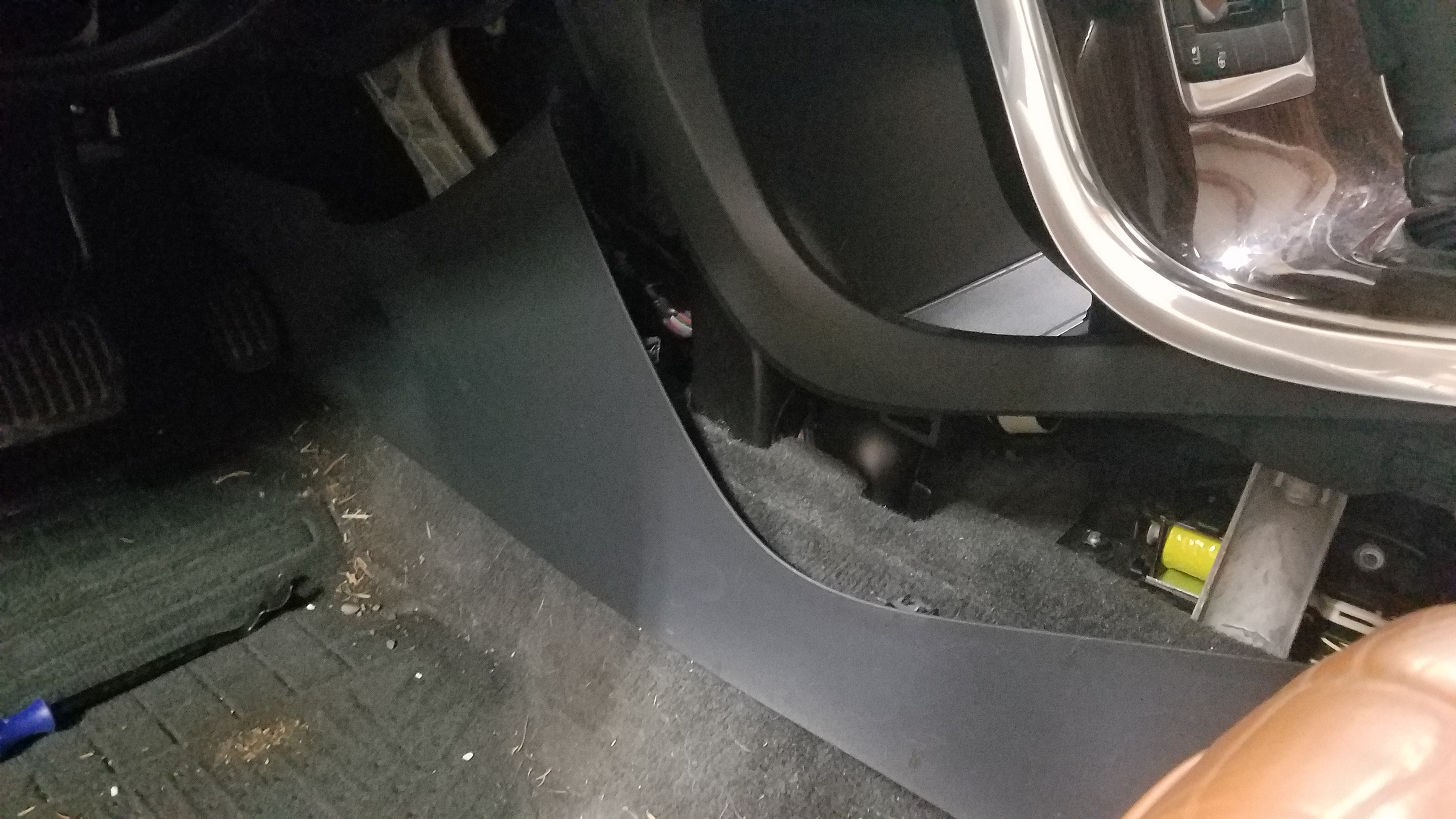

Start by removing the trim panel below the center console on the driver's side. This just pops right out and is held in by metal clips. I lifted and wiggled gently from the bottom until they started coming undone.
