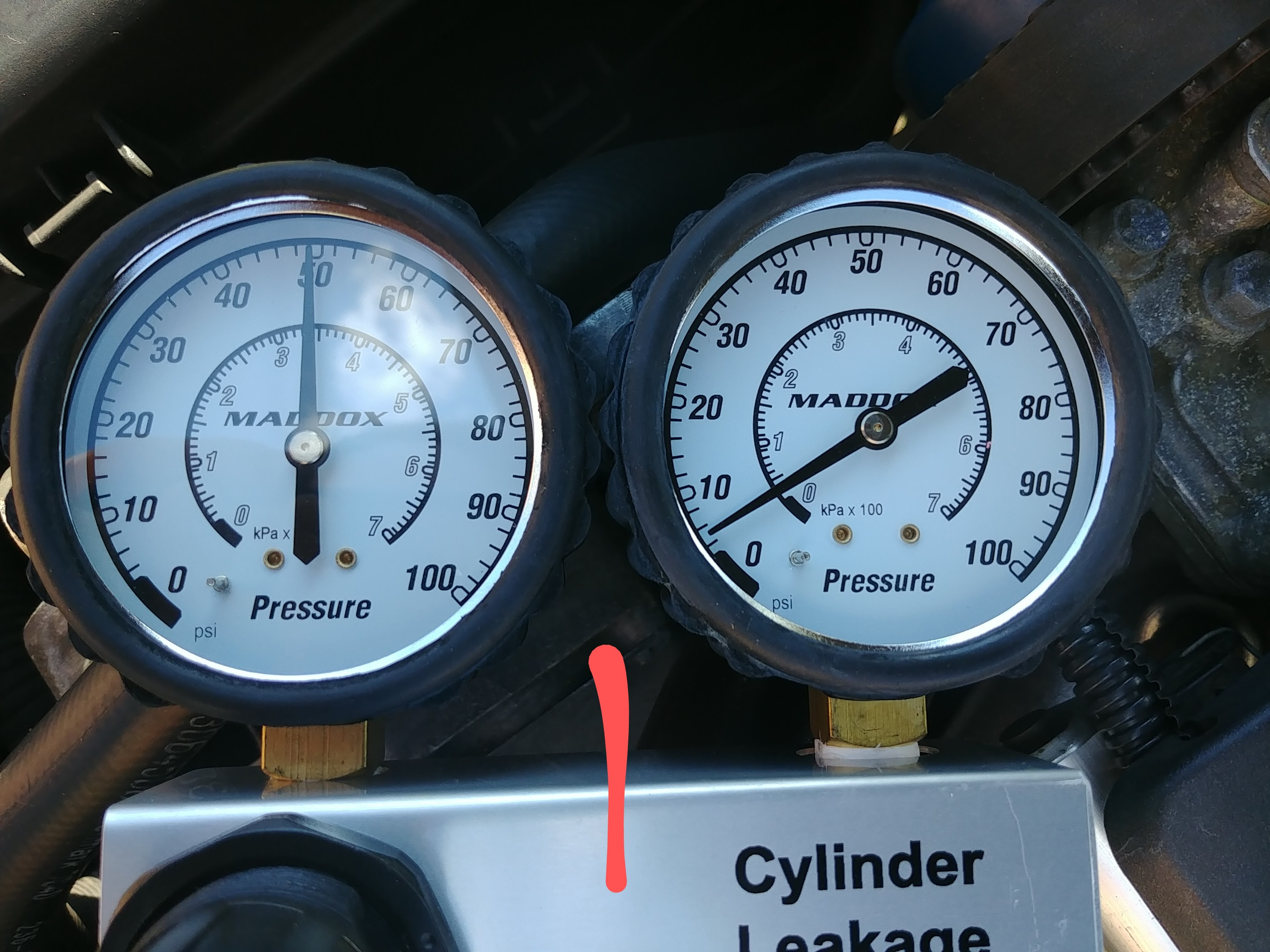

I didn't have time to do the cylinder leak down test the other day but just had some time to so here's the results. I put 50psi on each cylinder with each piston at tdc. How do I read this?
