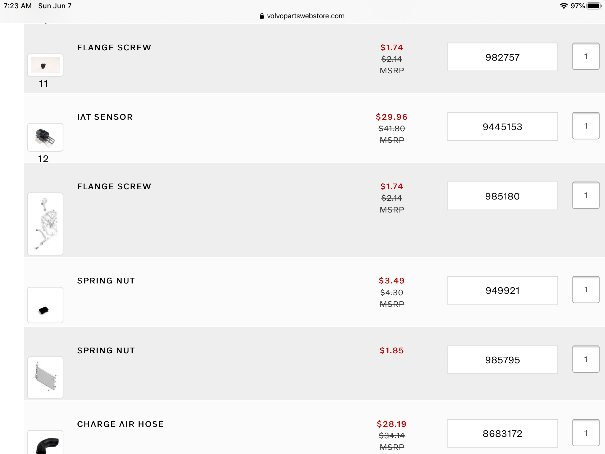

It looks like flange screw 11 or 20, depending on which charge air pipe you have
- Posts: 36162
- Has thanked: 1611 times
- Been thanked: 4075 times
They show as M6 x16 mm hex heads on the Volvo diagram, btw

I just removed the bolt and measured it for you.
It is M5 x 1.0 mm x 20 mm (length).
Either Ace hardware store or local junk yard should have it.

You can use the Volvo web store and grab the part number, then use the fitment tab and Sometimes find a non-critical place the same fastener is used in the car, too!
