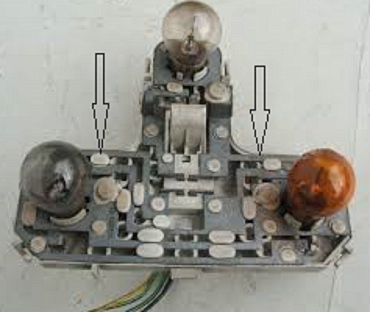

Also, you have to check water damages on all metal ways inside rear lamps. Sometimes there are gaps.
S80 lamp keeper.jpg (155.94 KiB) Viewed 2029 times

yagger wrote: 29 Nov 2019, 19:14 Also, you have to check water damages on all metal ways inside rear lamps. Sometimes there are gaps.
I have checked it. No water damage. I sanded all contacts once more. Now VIDA DICE shows that "REM-Bulb fialure, stop light" jumps to ~4.5 A instead of 5 A as before. Also, it flactuates at 4 A - 3.8 A (previously the maximum was 3.8 A) at idle, but if I press the gas pedal, it can drop to 3.6 A. The problem is that as while I was looking at VIDA DICE results, it started dropping to 3.2 A. I think that after some driving it will drop below 3 A again, as the problem is still here.
