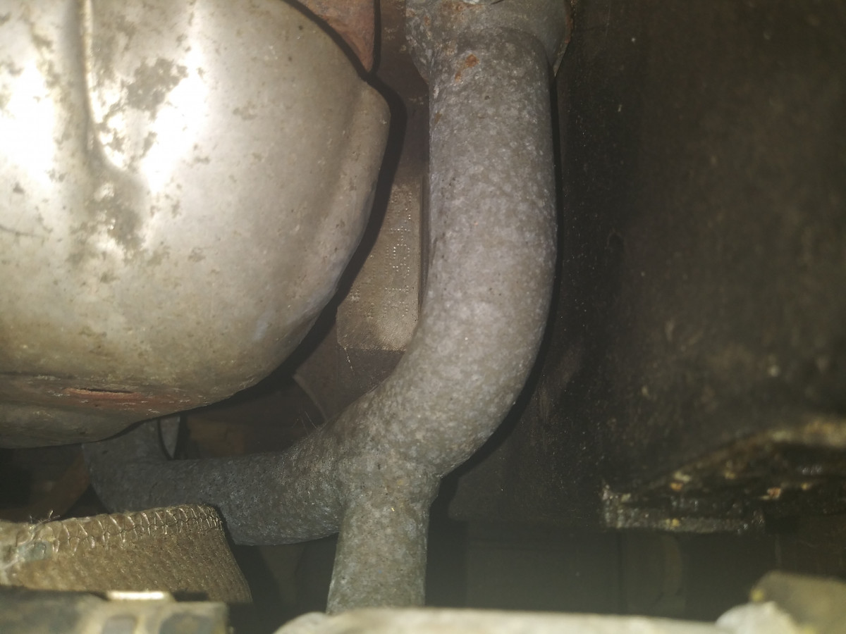

I adjusted
the tensioner, same problem with wobbling.
The tensioner bolt was too tight to loosen with stubby ratchet wrench, had to grab a 14" ratchet wrench.
so I guess I need to replace?
its possible this was the wrong part from the get go, I see 04 was a split yr with 2 possible tensioners, I never knew that when I ordered it.
I've been struggling to get the number from the rear of the block, scrubbing with a brass toothbrush, spray with brake cleaner, take pics, still hard to be certain but I think I might have it.
3135435 does this number make sense ?
- RickHaleParker
- Posts: 7198
- Joined: 25 May 2015, 14:30
- Location: Kansas
- Been thanked: 978 times
That line is the engine serial number and it is only six digits.
The line above it is the Engine model and revision ID.
Soak it with a degreaser then wipe it clean with a Scotch brite and a rag.
The degreaser "LA'a Totallly Awesome" which sells for $1.00 per 1/2 gallon at The Dollar three will clean it up.
You can also soak it with degreaser then pressure wash it clean. If you do not have a pressure washer there is one at the local car wash.
