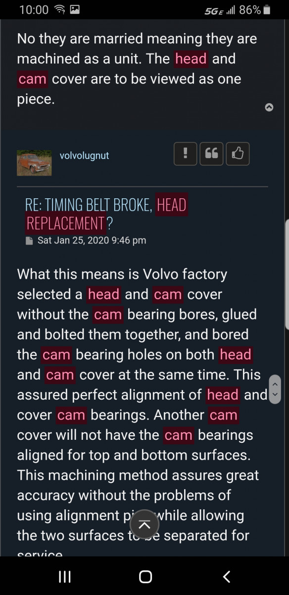

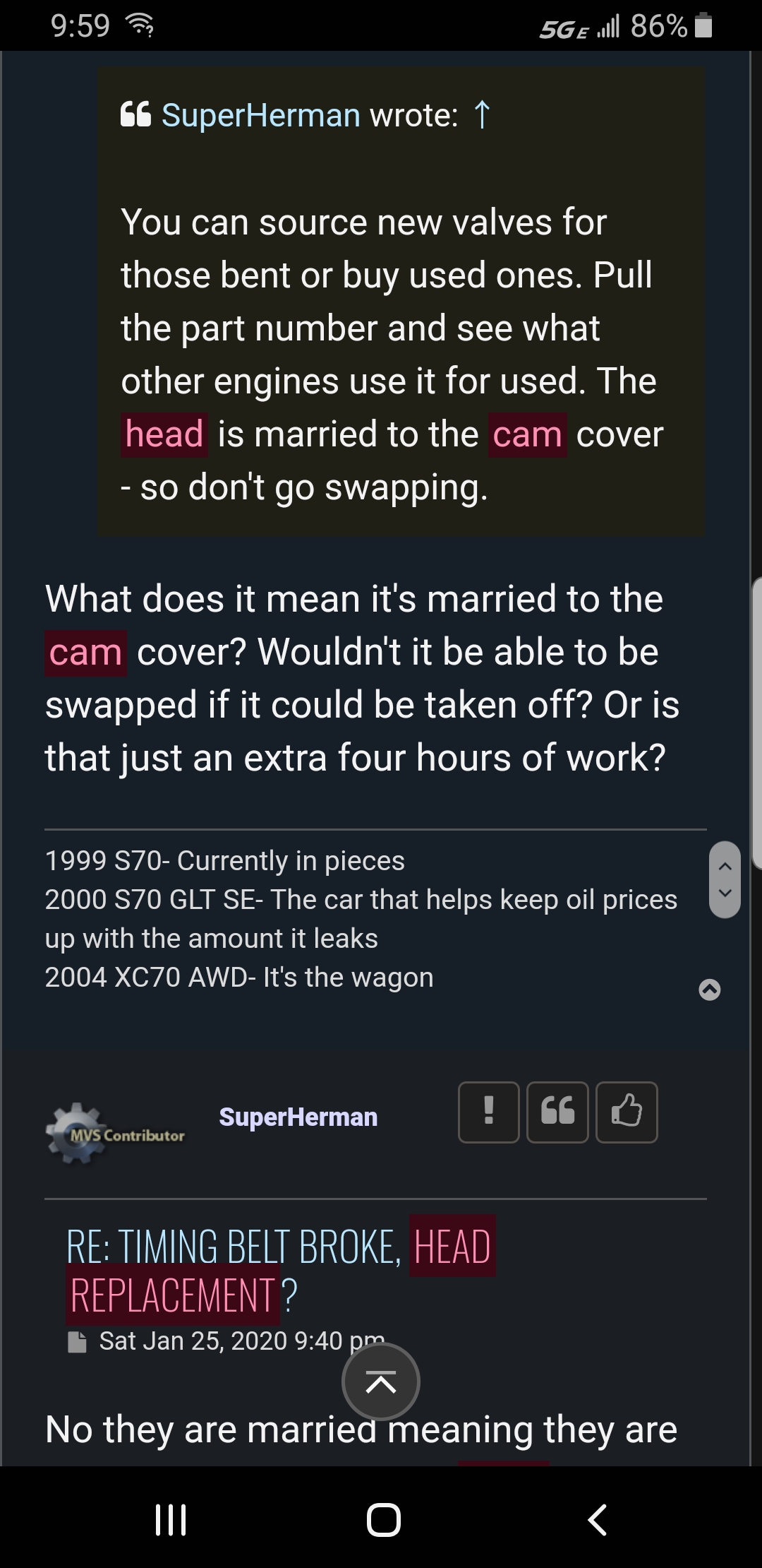

Here are some screenshots of another post talking about head/cam cover marriage. I have read plenty of posts on here over the years where mix matches didn't work. It took me about a minute to find the post I took the screenshots from. If I knew how to link posts, I would find a few for you where the cams were frozen due to different cam cover being used. Junebrushhippie wrote: 03 Jun 2020, 07:27 I will get some pics of them both..the only difference between the two was the cam sensor hole..went right together and no leaks. My daughter is coming over to help so it should go much faster..this will be our third pull...or drop I suppose.
