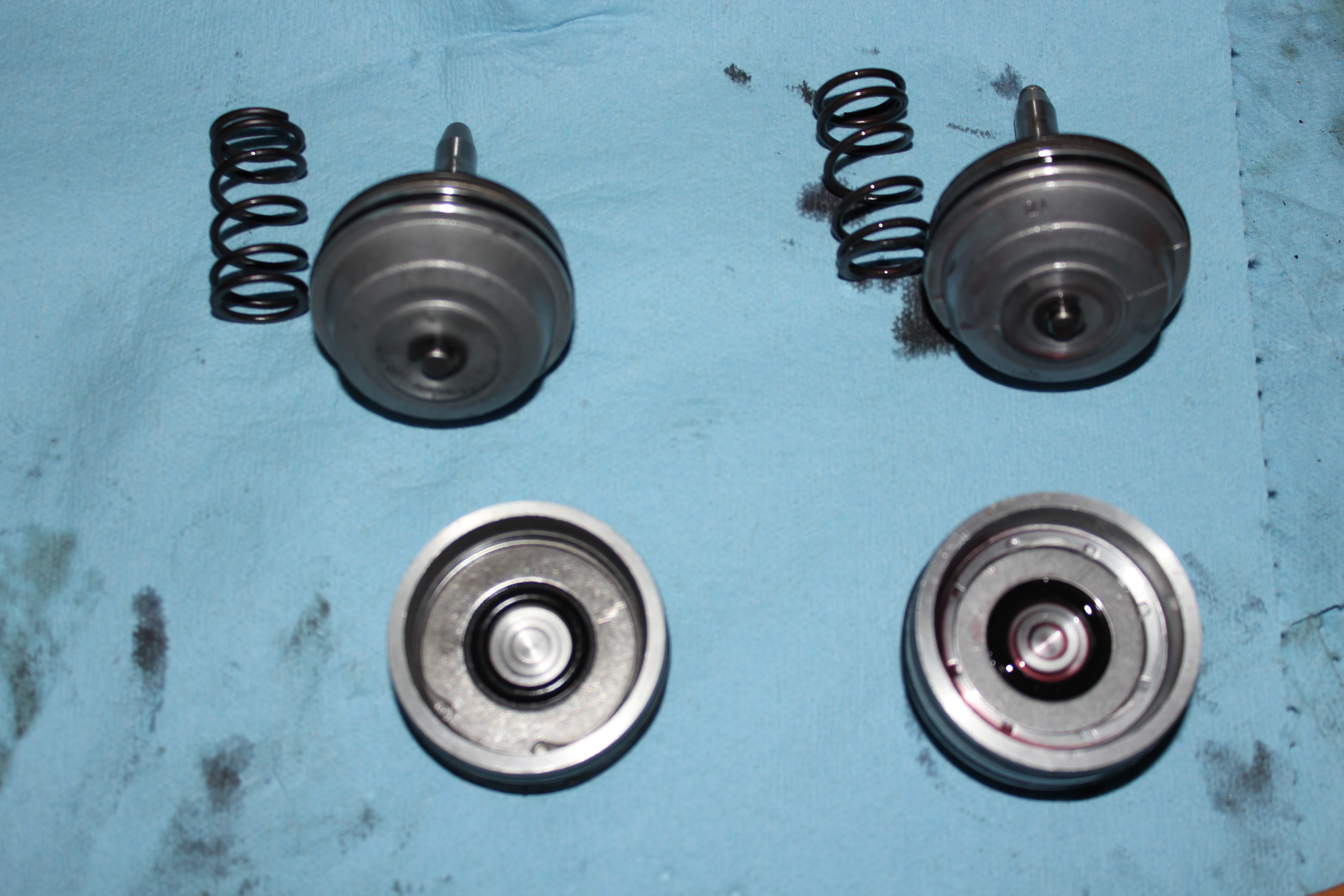

The only visible difference between original and replacement was a circlip holding the guts in as opposed to original covers pinch fit

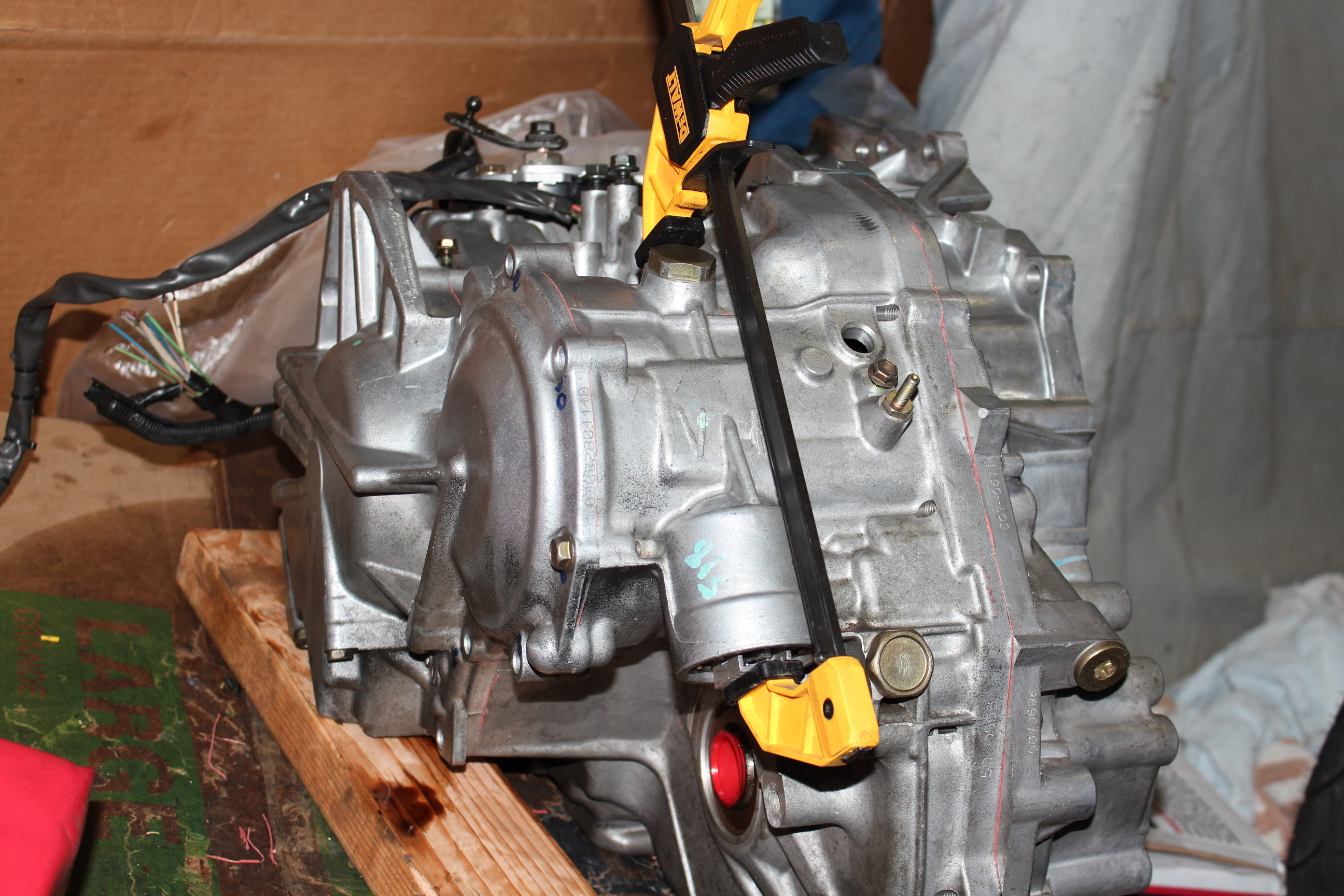

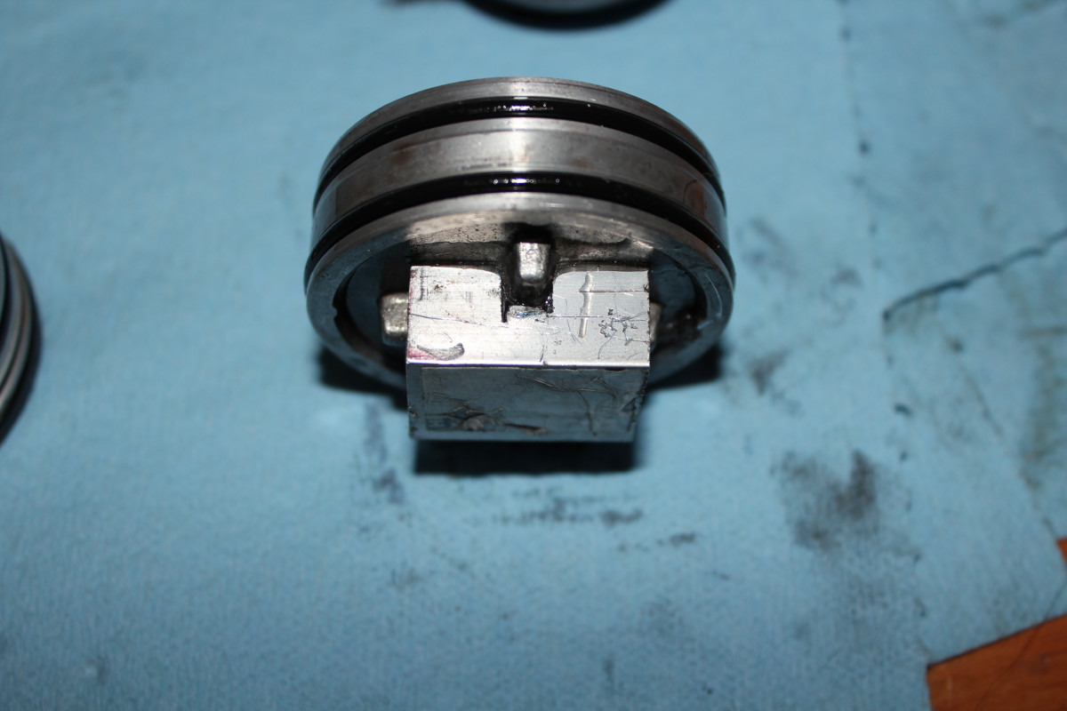

I recently completed changing the servo cover and after struggling for awhile I added a spacer to the cover, which helped out a great deal when using the 16 inch bar clamp. I epoxied an aluminum channel piece to the outside of the cover as a spacer and then just used the bar clamp to compress the cover, it worked well. Having the spacer attached eliminated having to hold something in place between the clamp and the cover.
To hold the cover in place while I positioned the clamp up top I cut a piece of wood (long dowel) to a length that wedged between the cover and just above the stabilizer bar. With the cover help in place below I positioned the clamp from above and compressed the cover. The photo I attached is with the transmission out of the car but I did the cover swap after the trans was installed and the bar clamp was in the same position as shown only this time trans in car and air filter box removed.

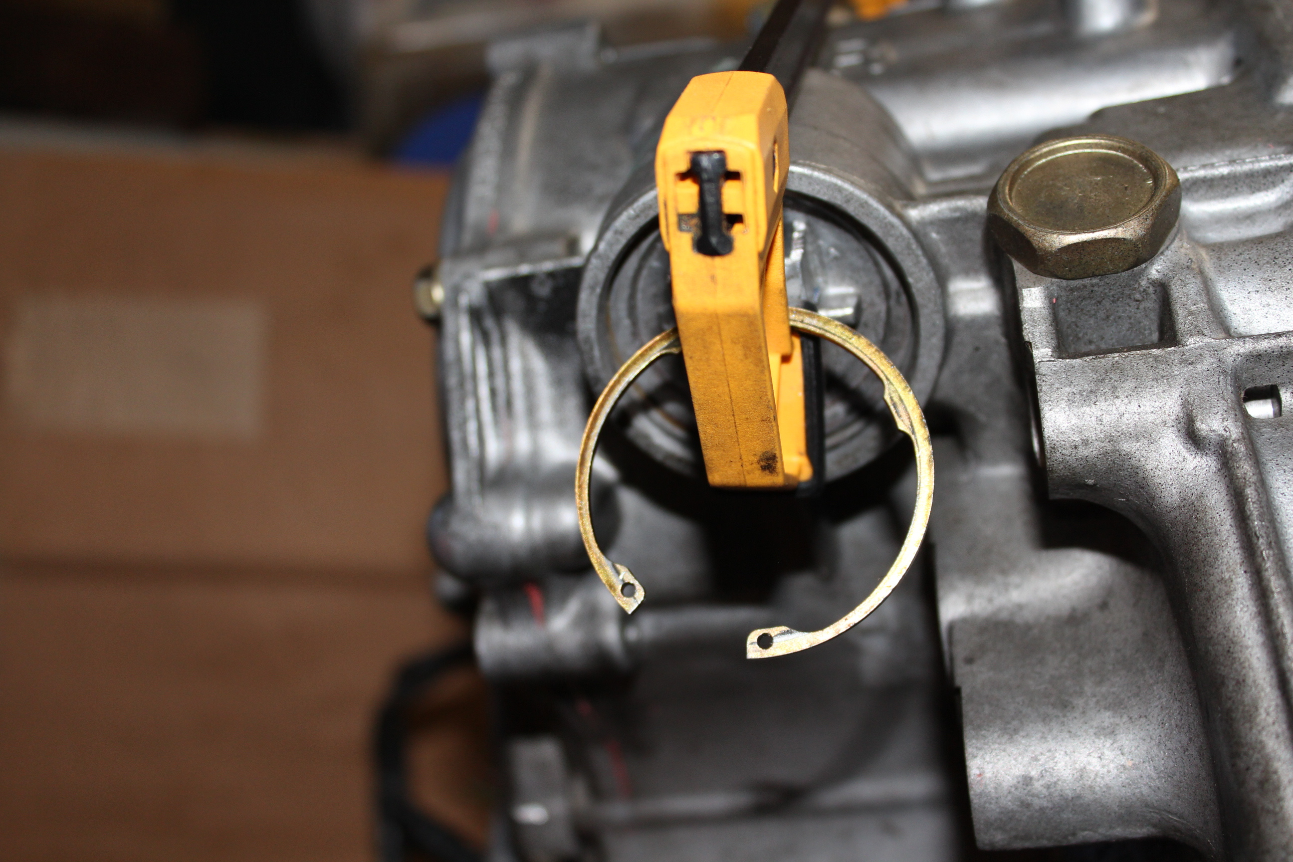

Using the bar clamp and spacer also provided a place to hang the snap ring, which freed up a hand for the final install.
