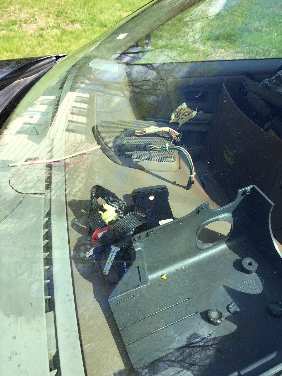

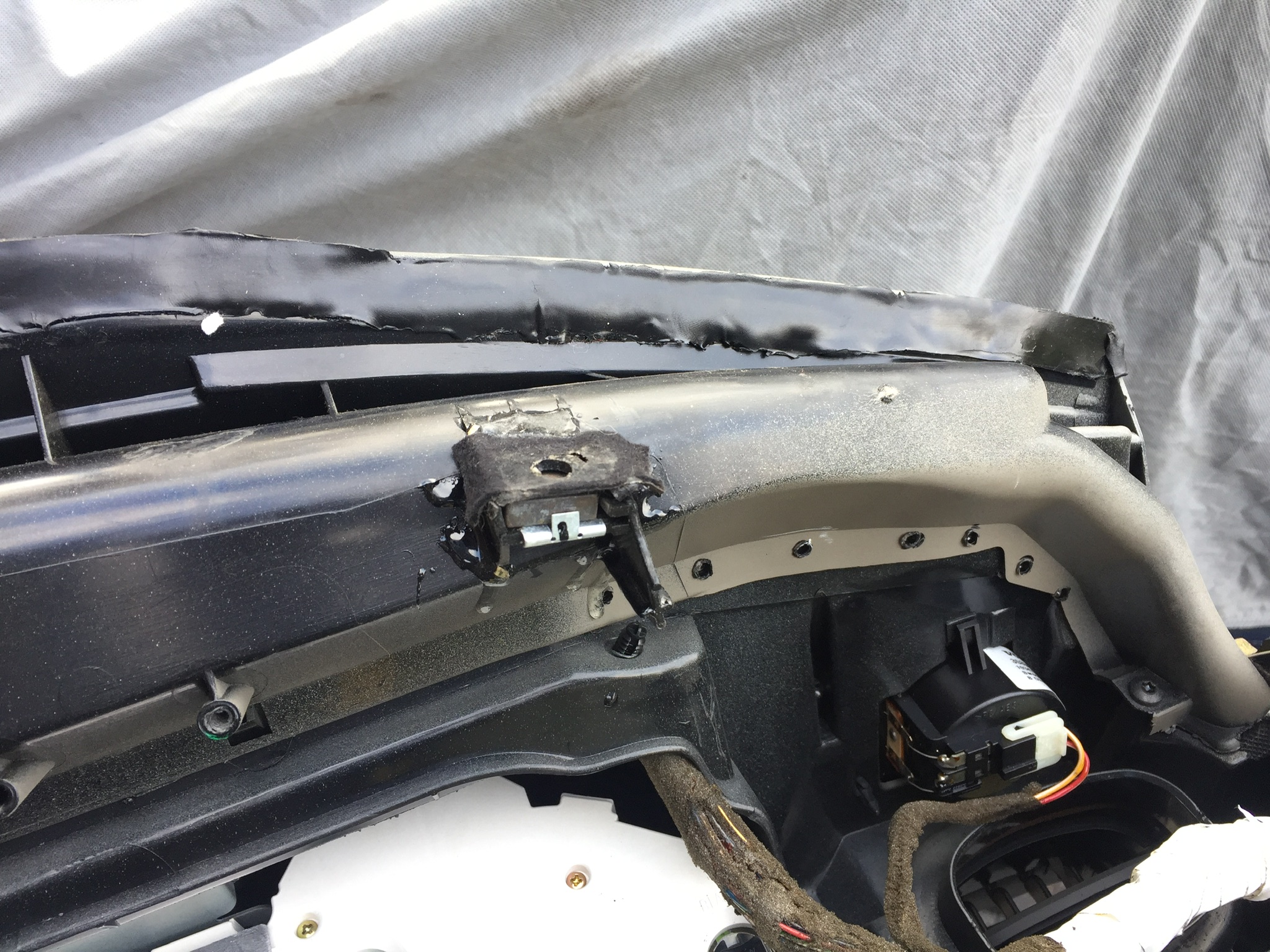

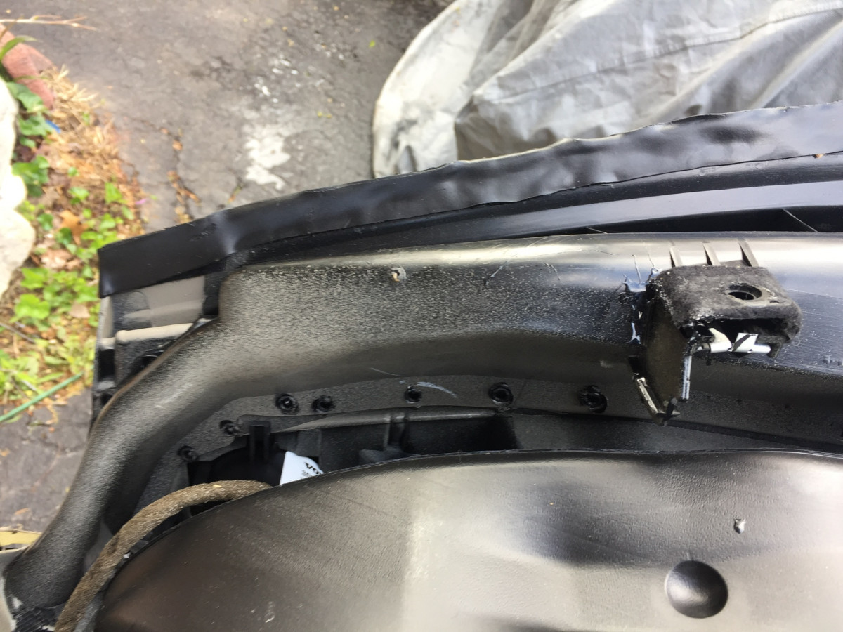

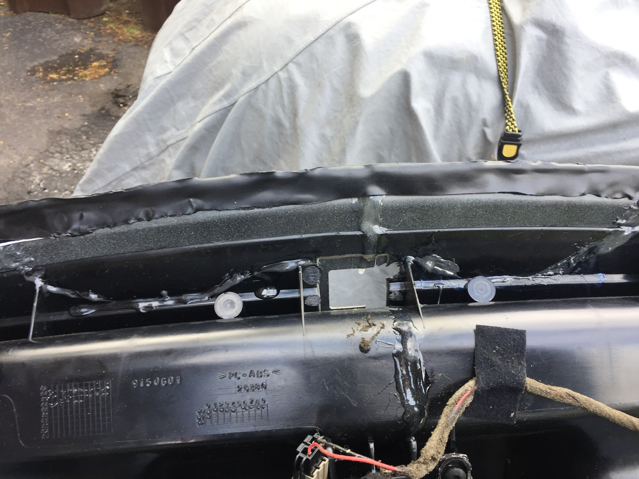

Abby and I pulled the dash from Evita and out the tape where it belongs, on the underside. This looks completely clean from the cabin and also works totally to elinate squeaks. I used clear liquid two part epoxy by JB Weld to rebuild mounts and strengthen cracks

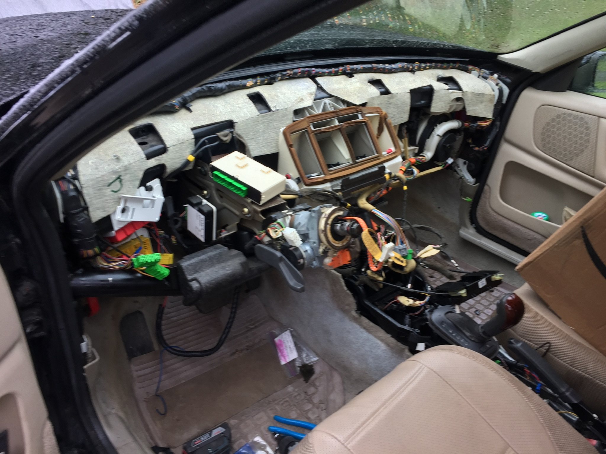

All th steering wheel trim, switches, air bag, steering wheel come off
Center console out
Foot kick panels off
Passenger glove box, then air bag connection
Electrical disconnects and plugs
Finally 4 m6 long bolts under hood cowl
Two people to lift out.
Plan on 3 hours first time

When your AC stops holding charge and you know your Evap is done that is the time to take out the dash and fix all that stuff. Find a DIY and bookmark in the VRD
Toughest part...finding a relativly shallow Torx bit to release the two captive screws holding the airbag to the steering wheel. A socket type won’t work as the holes are narrow. A screwdriver type works ok. Seat them well, clamp a vice grip (tm) on it to crack them loose.
Don’t strip them ... :twisted:
