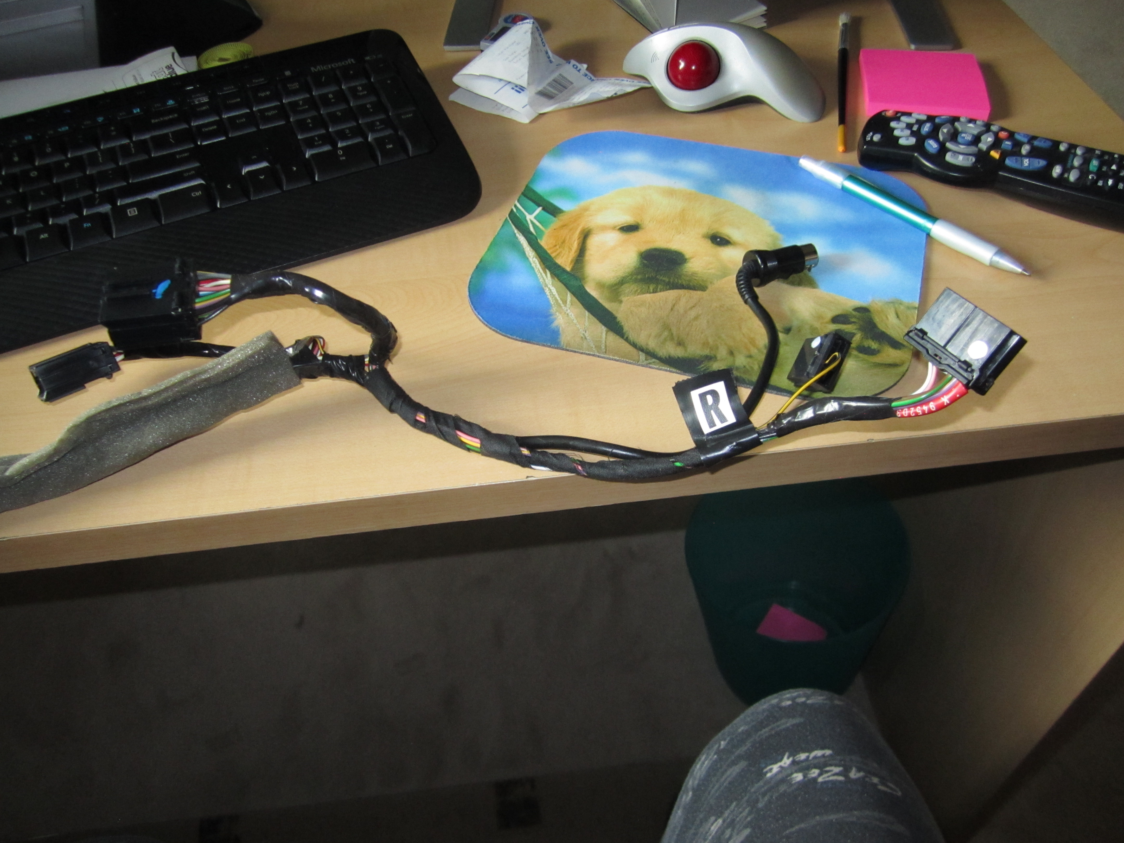

Here is a complete harness, without the Dolby option.
Basics are, the 2 cables that used to plug into the back of the standard radio/HU connect to the amp cable instead and basically run to the amp and then back to the HU (the SC-900/901 do not have internal amps).
Below is a complete AMP harness:
This end is all the connections at the amp. The black plastic rectangle on the harness (sitting on the keyboard) is the part that holds the cable on the passenger side of the center console.
This is the ''new' connections to the HU.
These connect to the original HU cable that went to the back of the HU.
Does this help?

Perfect, thank you. Thinking I didn't fish up the other 10 pin connector. The pictures are greatly appreciated.scot850 wrote: 22 Jun 2020, 12:38 Here is a complete harness, without the Dolby option.
