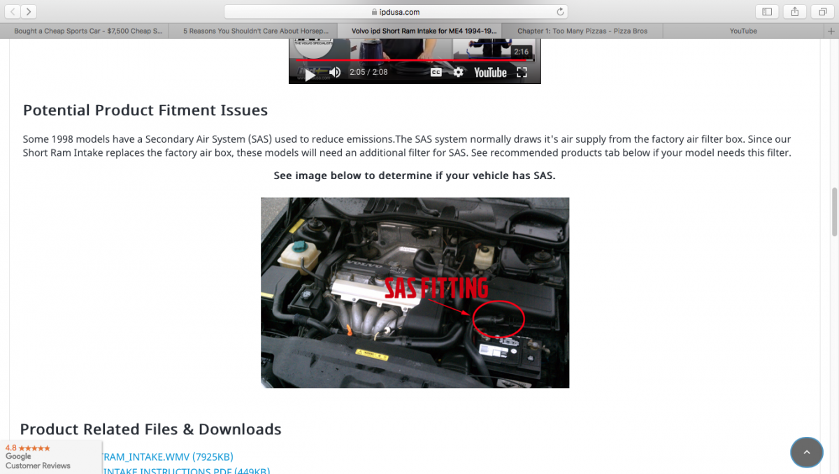

Yes we are referring to the SAS pump hose, located on the top of the air box cover. I think it was the way I explained it that was confusing.
I located a delete for the SAS here, what do you guys think? I don't see a good way to hook up this SAS pump hose anywhere before MAF so it is probably best to delete. viewtopic.php?f=1&t=31536

To the OP: this is what scot850(Neil) is referencing: https://www.ipdusa.com/products/4670/11 ... 5sEALw_wcB
The stock intake on an 850 IS a cold air intake system. What you've created is typically referred to as a short ram, sans the ram air effect. I know because I used to build Honda's, and Subarus in the mid 2000's. Those cone filters are neat bc they lower throttle response when you shorten the intake system. I'd just carry a can of MAF spray with you just in case. No starts from dirty MAF's are a pain in the bootay. Trust me I know.

From that link you posted I was able to locate a required SAS ram intake that solved my problem! https://www.ipdusa.com/products/4671/11 ... s=P0,P4670
