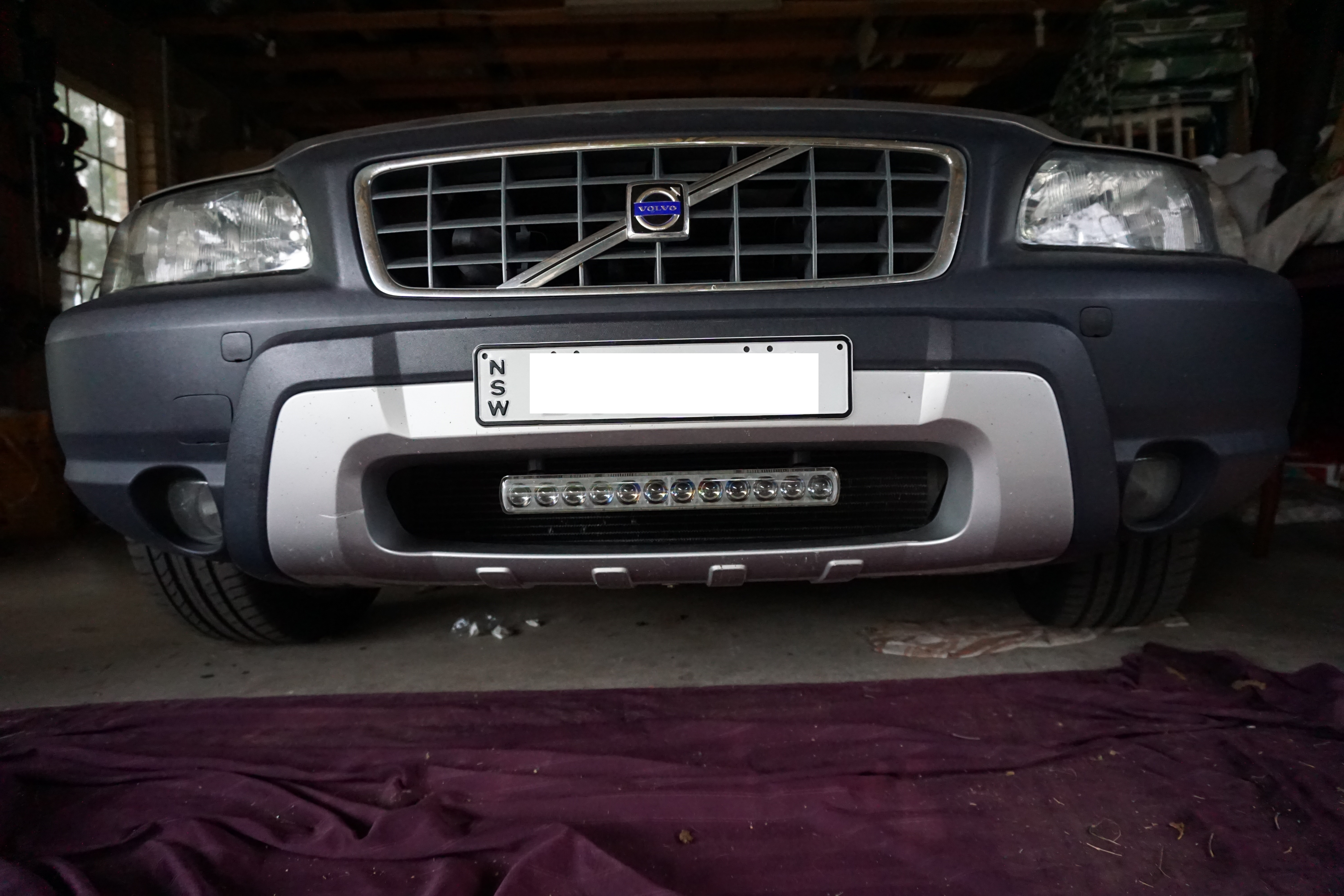

I was looking at the a/c radiator in the front of my 2001 xc70 and it seems the (mouth) air scoop has collected a few more rocks, I might put installing a mesh on the "urgent modification" list. This is the first place a technician will look at for damage/leaks.
The previous owner "updated" the front and rear bumpers, i have removed that lightbar, it looks stupid there.
