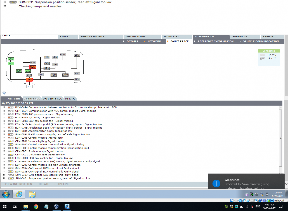

Got my codes here

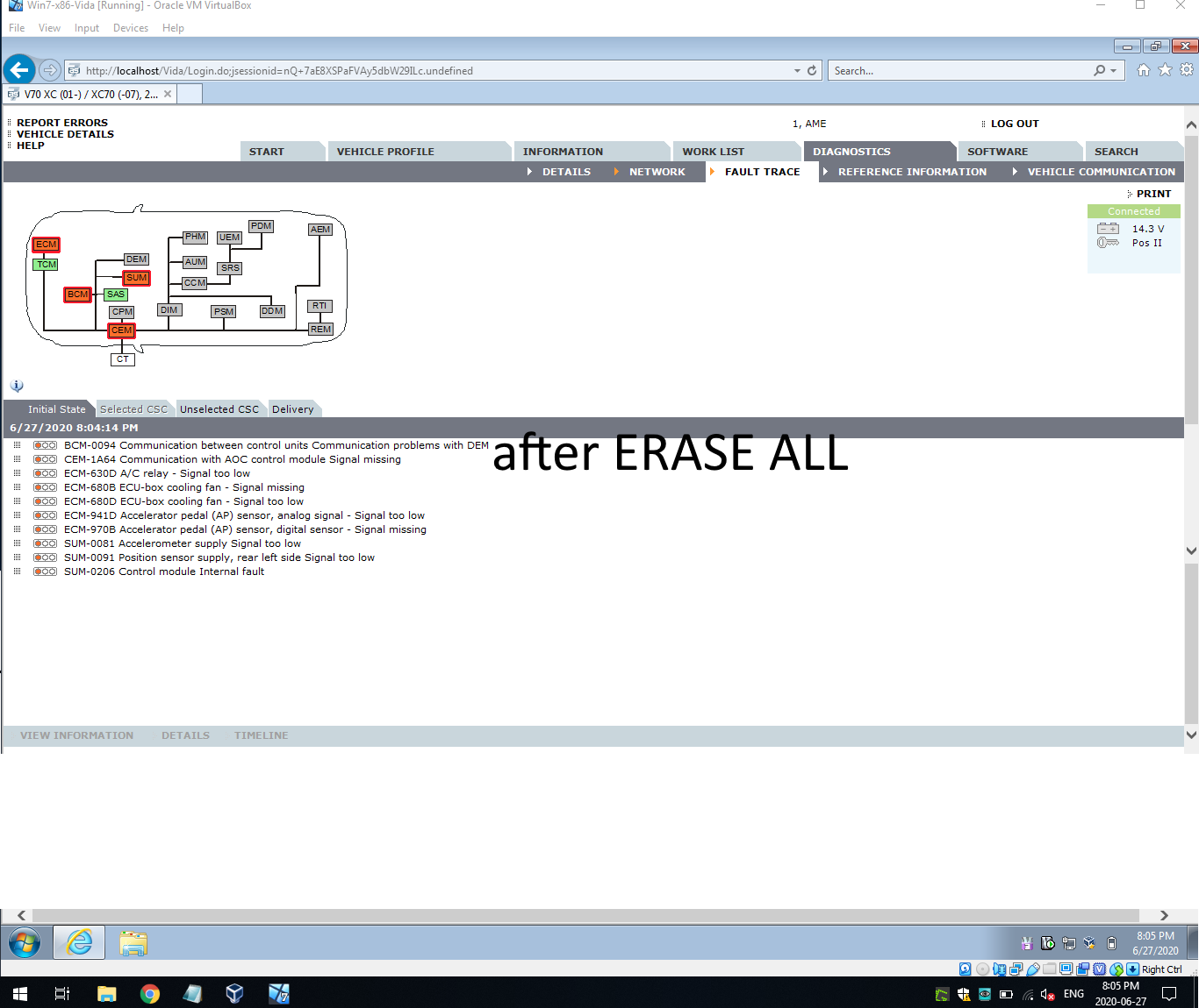

After ERASE ALL

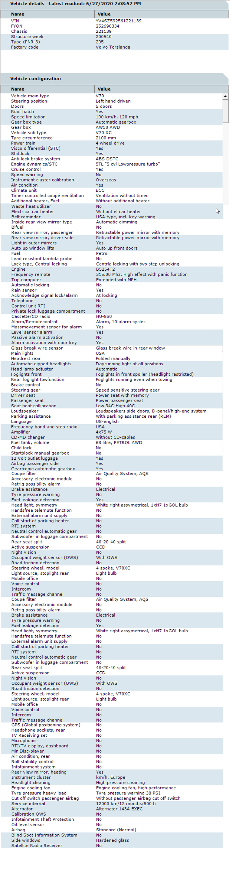

Car config

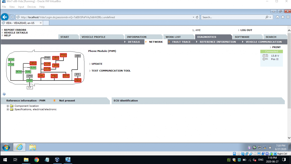

VIDA DIAGNOSTIC NETWORK TAB

My initial guess is that codes ECM-941D ECM-970B accelerator pedal AP sensor signal missing / too low are the cause of the reduced performance message and lack of power.

So much red on the NETWORK tab though, could there be a CANBUS problem ? Frayed wiring somewhere shorting out the bus maybe.
Has anyone ever tried running wireshack in CANBUS sniffing mode on these cars ?
From what I understand, there are only 1 high speed bus and one low speed bus ? Maybe I could sniff the buses and just clear the health of the bus ?

This one is easy,
the engine computer fan will cause all those codes and more as soon as the computer gets too hot.
the 5 amp fuse for the fan is in the power distribution box in the engine bay.
