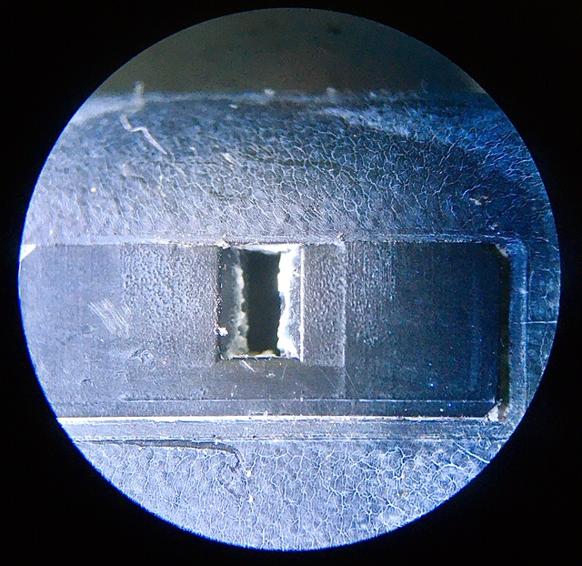

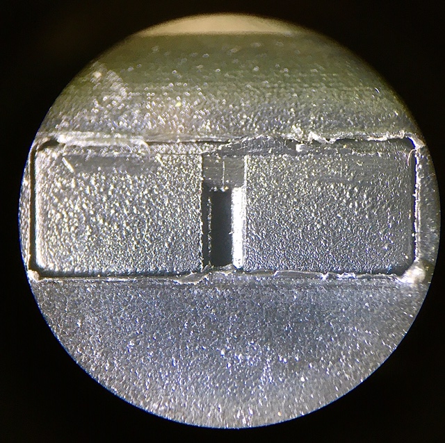

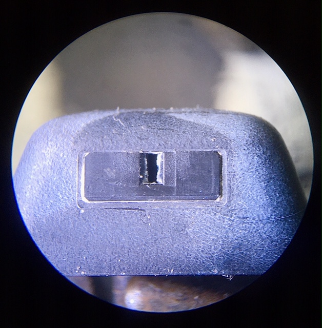

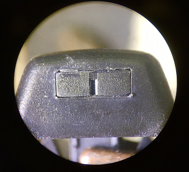

I had to replace a windshield washer nozzle on my '97 855 GLT (222k miles) because one of the locking tabs broke off, allowing the nozzle to pop out of the hole.
Can you guess which nozzle is OEM and which one is a $4 aftermarket part?
Low mag:
Nozzle A:
Nozzle B:
Higher mag:
Nozzle A:
Nozzle B:

They both look surprisingly crappy, but I'll go with B as the OEM.

I'll let others guess too for a short while. Nozzle B was the one that broke after having been on the car for about 10 years -- that's why it looks a little beat up.

Nozzle B is Genuine Volvo. Nozzle A is too narrow to provide the wide spray pattern original Volvo nozzles do. June

June, Sveedy, you are both correct.

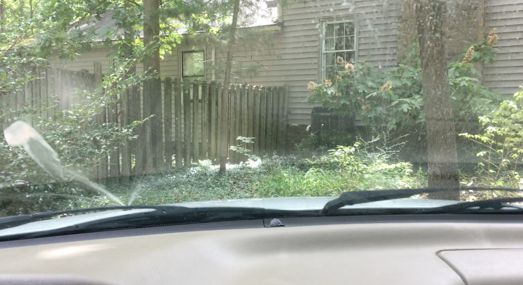

Here is what Nozzle A and B look like while spraying.
Nozzle A is on the left shooting out a fairly narrow stream, and Nozzle B is on the right spraying a wide pattern. I guess I'll give the new Pro Parts Sweden (Nozzle A, left) a try for a while to see if it's good enough, or if I have to spring for a new OEM Volvo nozzle. The part number on the Volvo nozzle is 30655605. It is marked POM. The new Pro Parts nozzle is marked PA-66.

If you use them as often as I do, i predict you will be buying Volvo replacements. June
