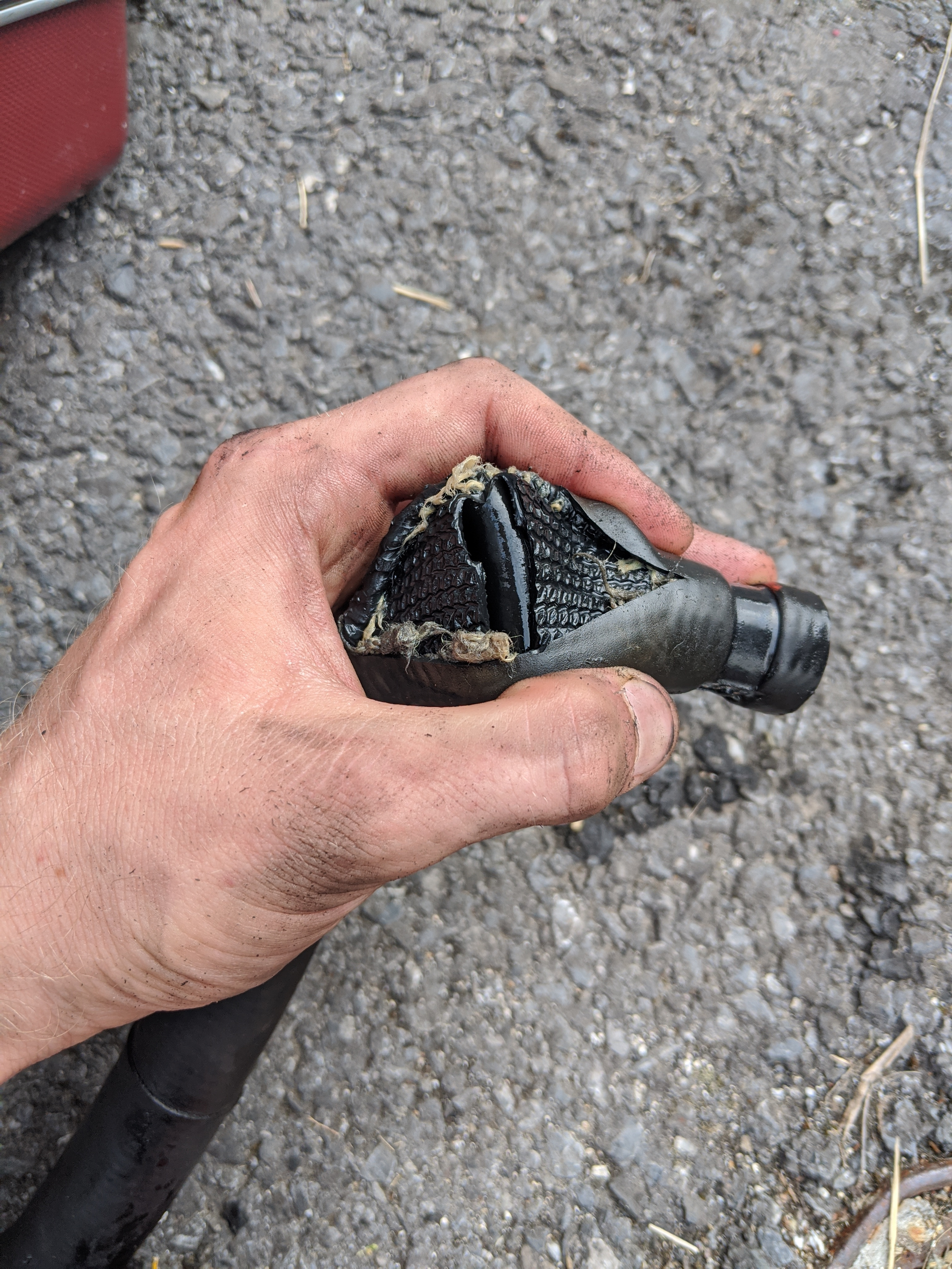

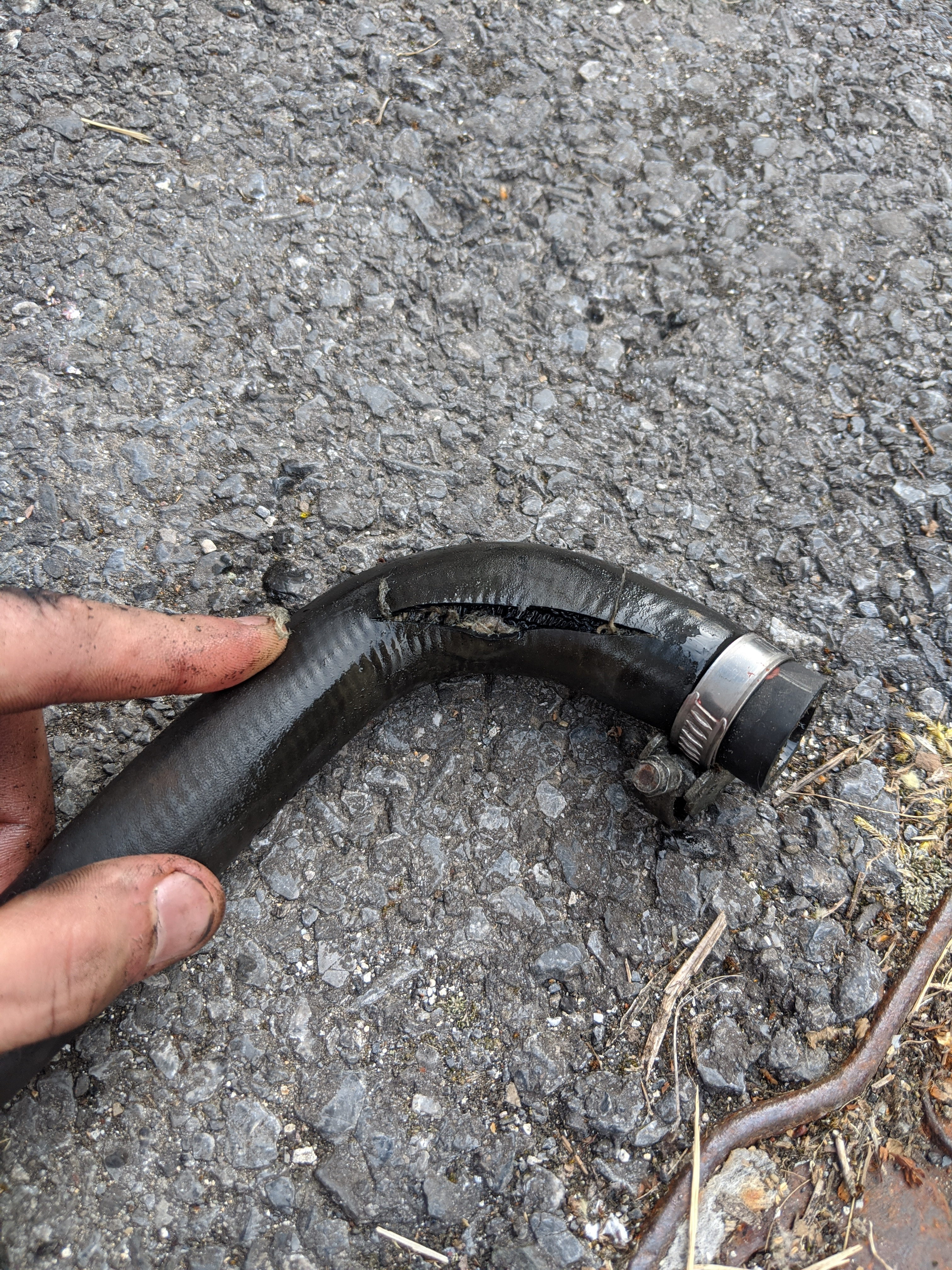

Fiodor
Posts: 141
Joined: 17 October 2017
Year and Model: 1997 V70 2.0 T5 AWD
Location: Reims
Has thanked: 13 times
Been thanked: 9 times
Post by Fiodor »
Found the culprit !
One of the heater core hoses. I'm going to replace both as they were original :mrgreen:

Funny thing is a catastrophic failure like this is really what you want with a coolant hose - the alternative being a pinhole leak you don't notice until you overheat and warp the head.

Like abscate says, at least it happened quickly and you were able to stop fast. Now check all the hoses! If you look at the outside of the hose and particularly where the split is you can see the pipe has gone dull and has a rough surface to it. The rubber is shot. Good rubber continues to harden for about 10 years (like in tires). After that you are running on borrowed time. The fat these have lasted so long is amazing.
Hopefully new hoses and new coolant and all is well! But especially check the turbo coolant rubber pipes (the short ones by the turbo). If these are original then change them at the same time. One may look not too bad but the other will be horribly swollen and deformed if they are also original.
