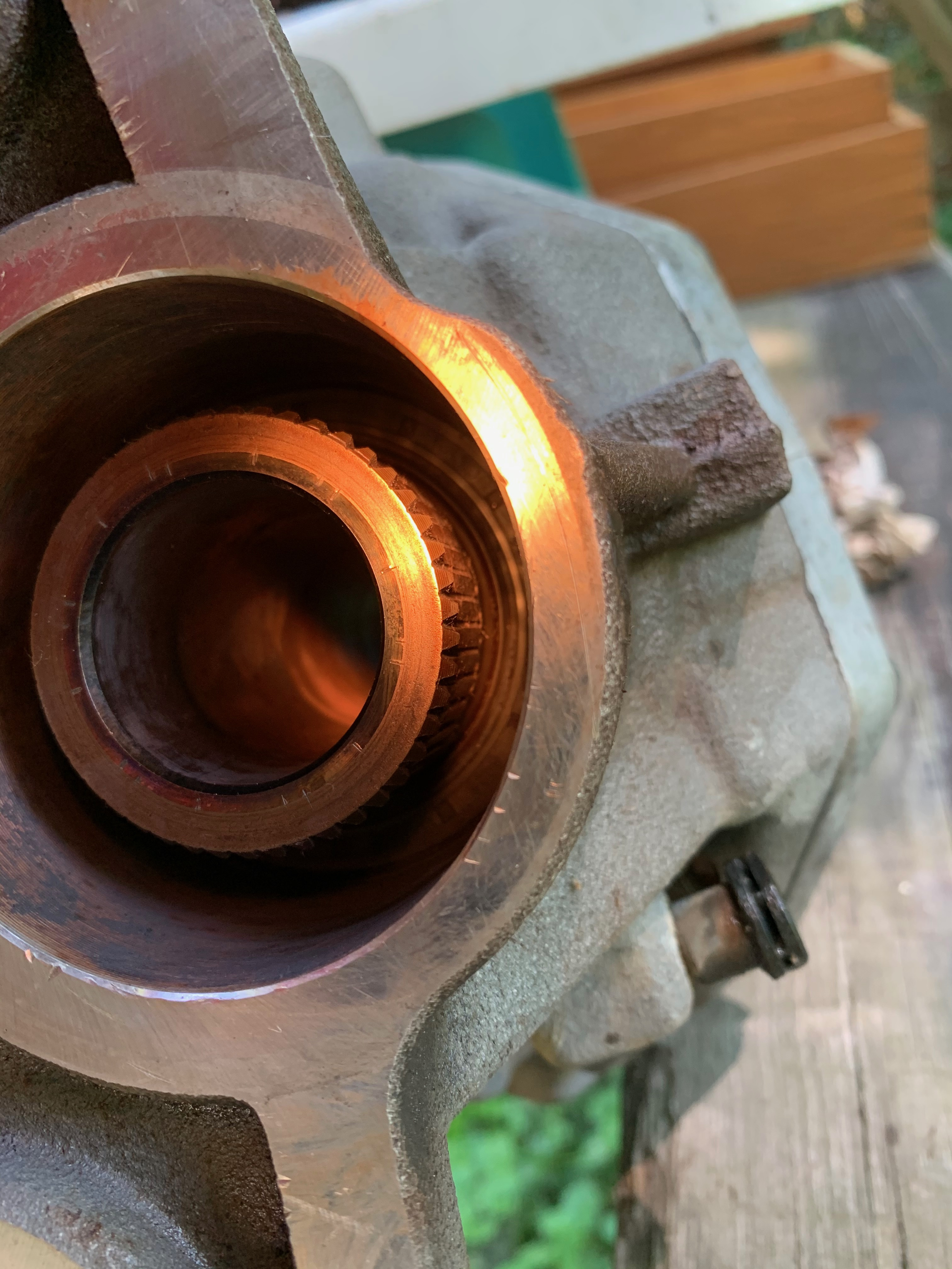

Everything is apart. Prop shaft only disconnected at the front so far, that thing was the tricky part.
Diagnosis is stripped angle gear input shaft, the collar finally worked loose after several years of FWD-only and started rattling on the surface of the AG input shaft. I can replicate the bad sound exactly by spinning the collar on the stripped out AG shaft.
Note: on disassembly, the collar sleeve came out with the angle gear. So not stuck in the transmission at all. Right now I can easily insert the collar in and out of the transmission. I checked carefully however and the trans output splines look good, the collar splines on the trans side look perfect can still see machine marks.
Here are some pictures, would appreciate any observations:
AG_input_shaft_splines
Collar_outside
Collar_outside
Collar_AG_side
Collar_AG_side
Collar_trans_side
Collar_trans_side
Trans_output1
Trans_output1
Trans_output2
Trans_output2
My current plan is to not replace the AG at this time, but reassemble as FWD.
If I go to FWD do I need a new collar sleeve at this time or not? The old one seems in excellent condition e.g. on sealing surfaces but I am puzzled that I can so easily insert/remove it to/from the trans. If I can use this collar the I would just replace all axle-related seals and put it back together.
Will fix a weepy biscuit cooler seal too while I'm down there. Turbo oil return line is bone dry so I'm leaving it alone. Will need to wrestle the °*##‡̂$@ prop shaft out of the rear.

I see no reason to replace the collar sleeve with a new one until you can mate up a bevel gear to receive power from it. I would definitely replace that trans/collar sleeve seal though.
One thing you can do very economically to regain RWD is to weld the collar sleeve to the BG input shaft. Just a suggestion. Cheap as in you wouldn’t need a new collar sleeve & you could continue use to use your old bevel gear, you’d just need to drill some holes and ensure the collar sleeve is concentrically welded.
Edit: front driveshaft CVJ is the easy one, so might need your Thomas the train books for the rear. For clarification, I’ve always used a bolt to “push” the CVJ out of the flanges. I’ve never threaded one into the existing threads to do this, however. By using a bolt in one of the 2 unthreaded holes I’ve always been able to pop the CVJ’s loose using a pry bar to exert force on this bolt.
What's a biscuit cooler?
Also, post the numbers in your BG extrusion and/or actual part number. I’ll keep my eye out for one if you go that route (used working BG).
2 edits total.
