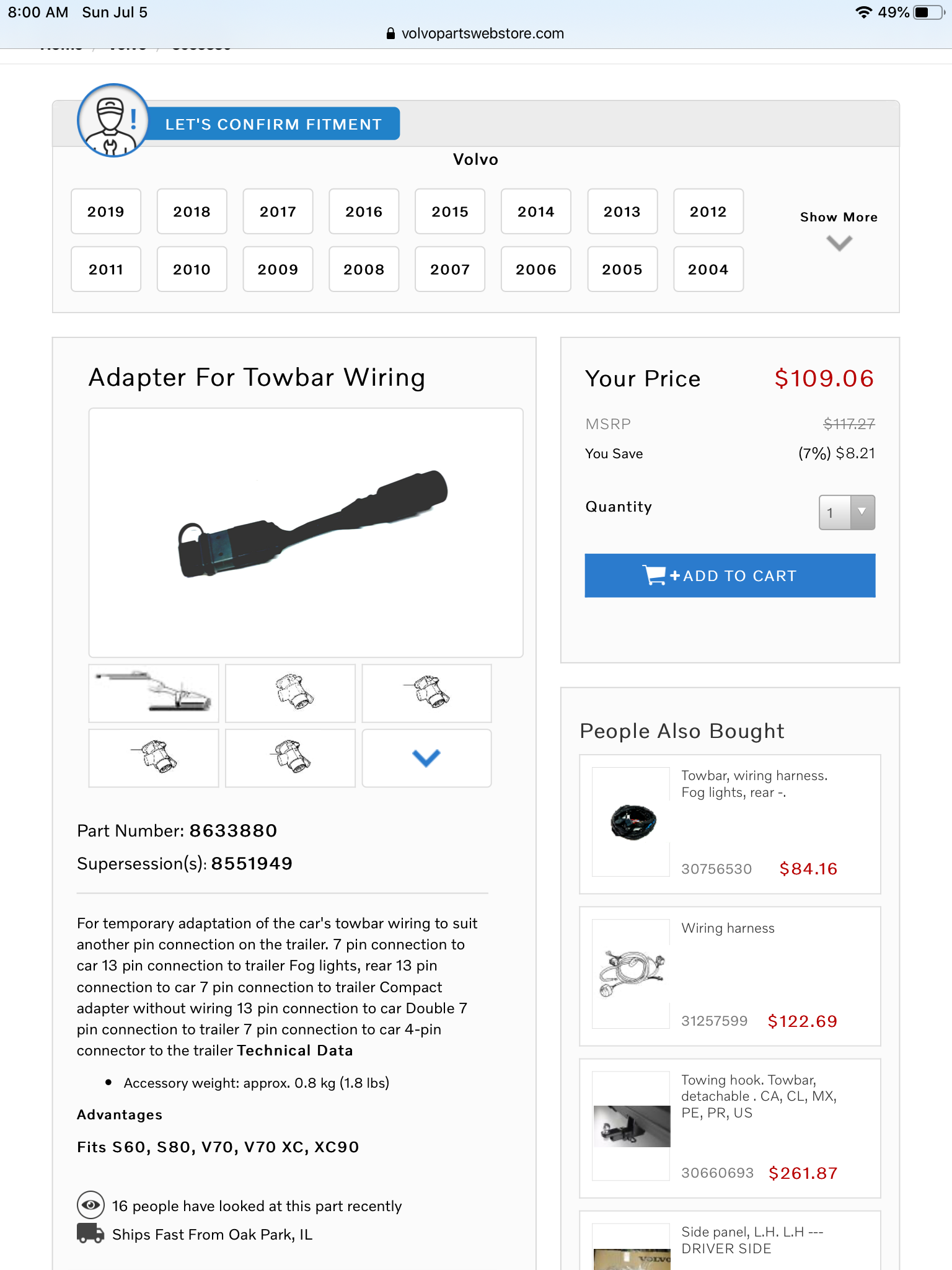

Looking for the pin outsonthe car side of this puppy
It looks like it might work on both of my V70s

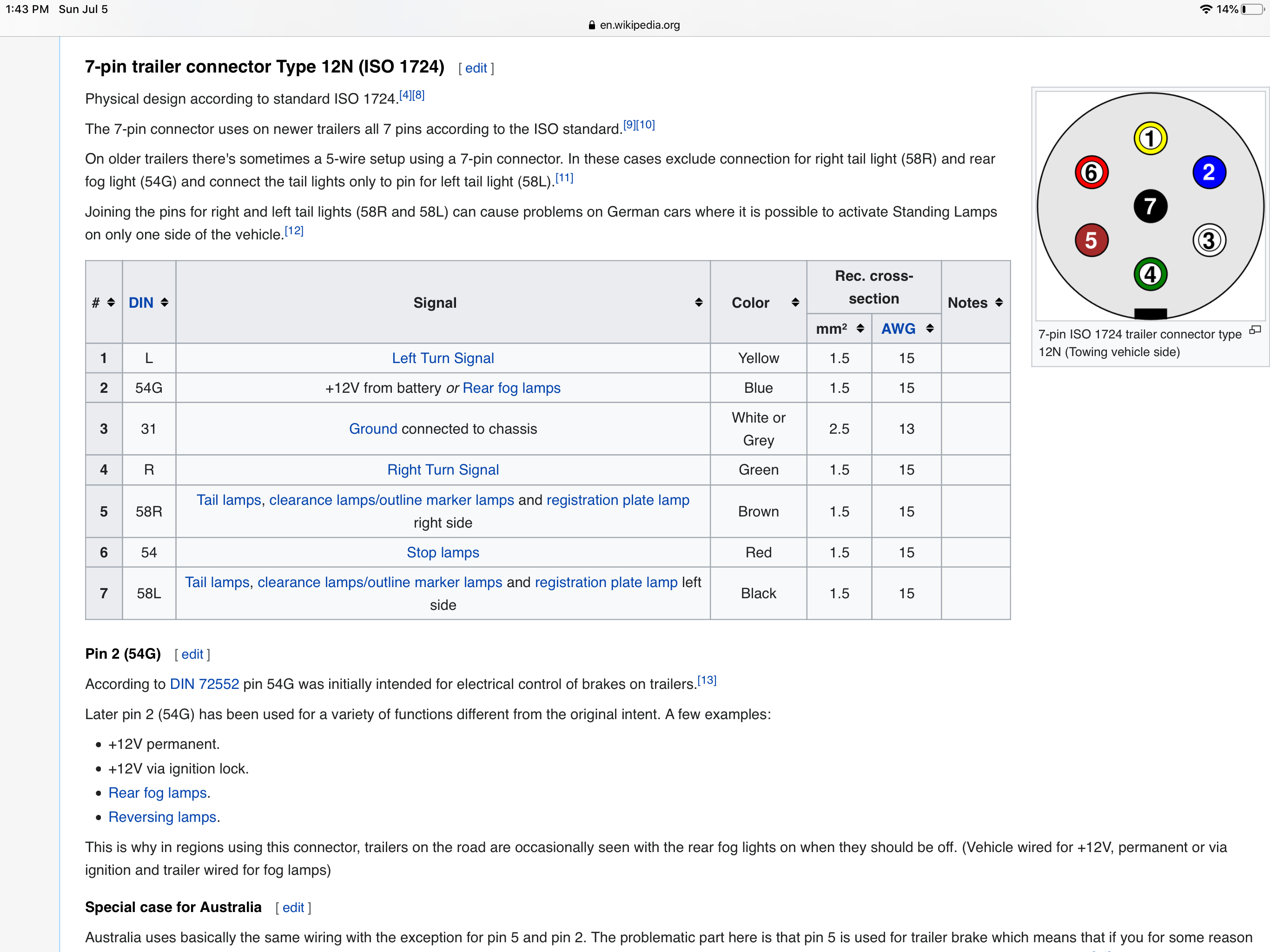

See attachment. It follows the attached ISO protocol
Make sure you get the correct diagram for the towing or towed vehicle to assign correctly
Link to part
https://www.fcpeuro.com/products/volvo- ... gKFmfD_BwE
P80 trailer light adapter pin out assignmentS Part Number: 8633880 Supersession(s): 8551949

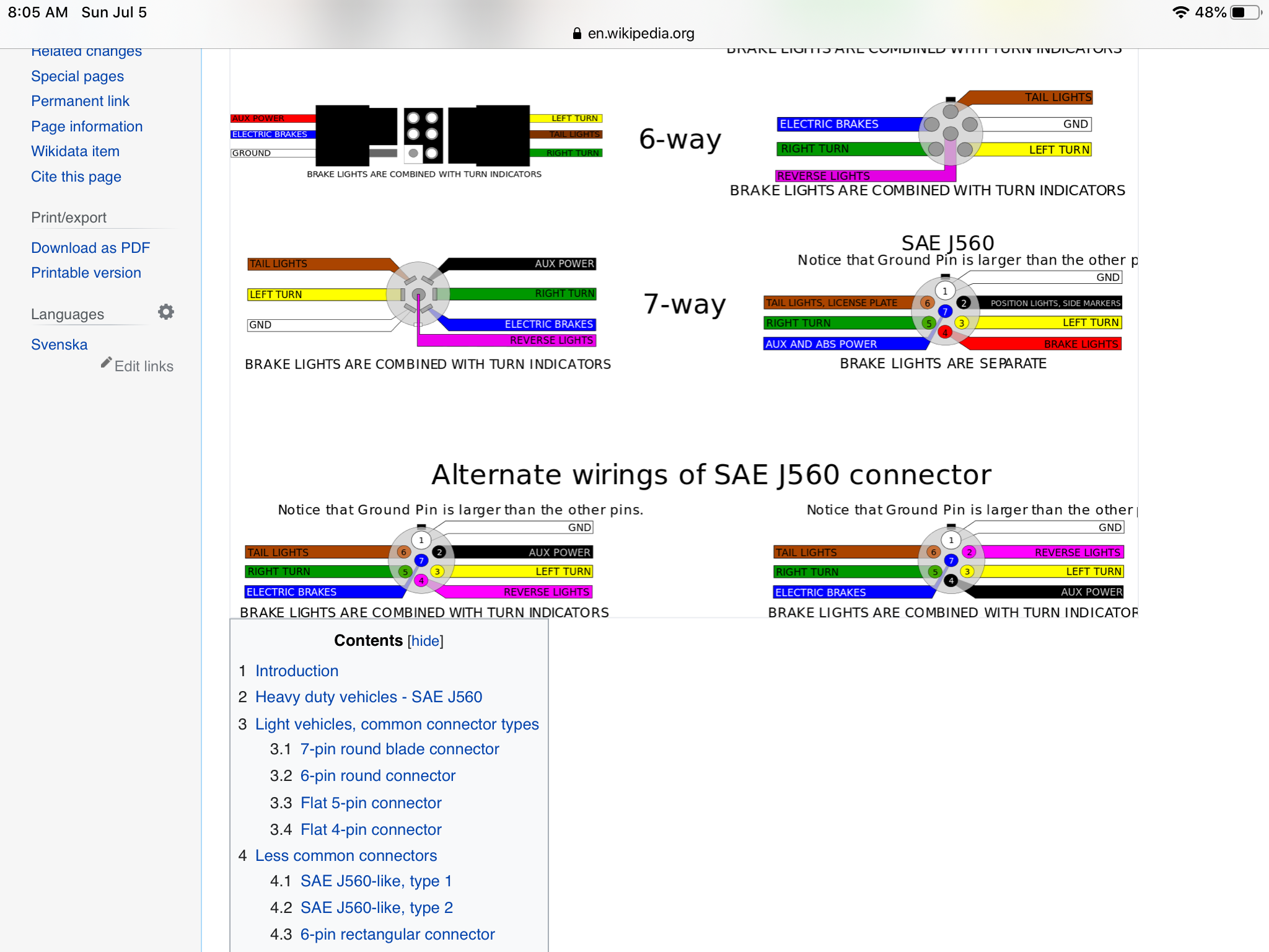

Would this be an SAE STANDARD 7 pin?
Answer: it is not
