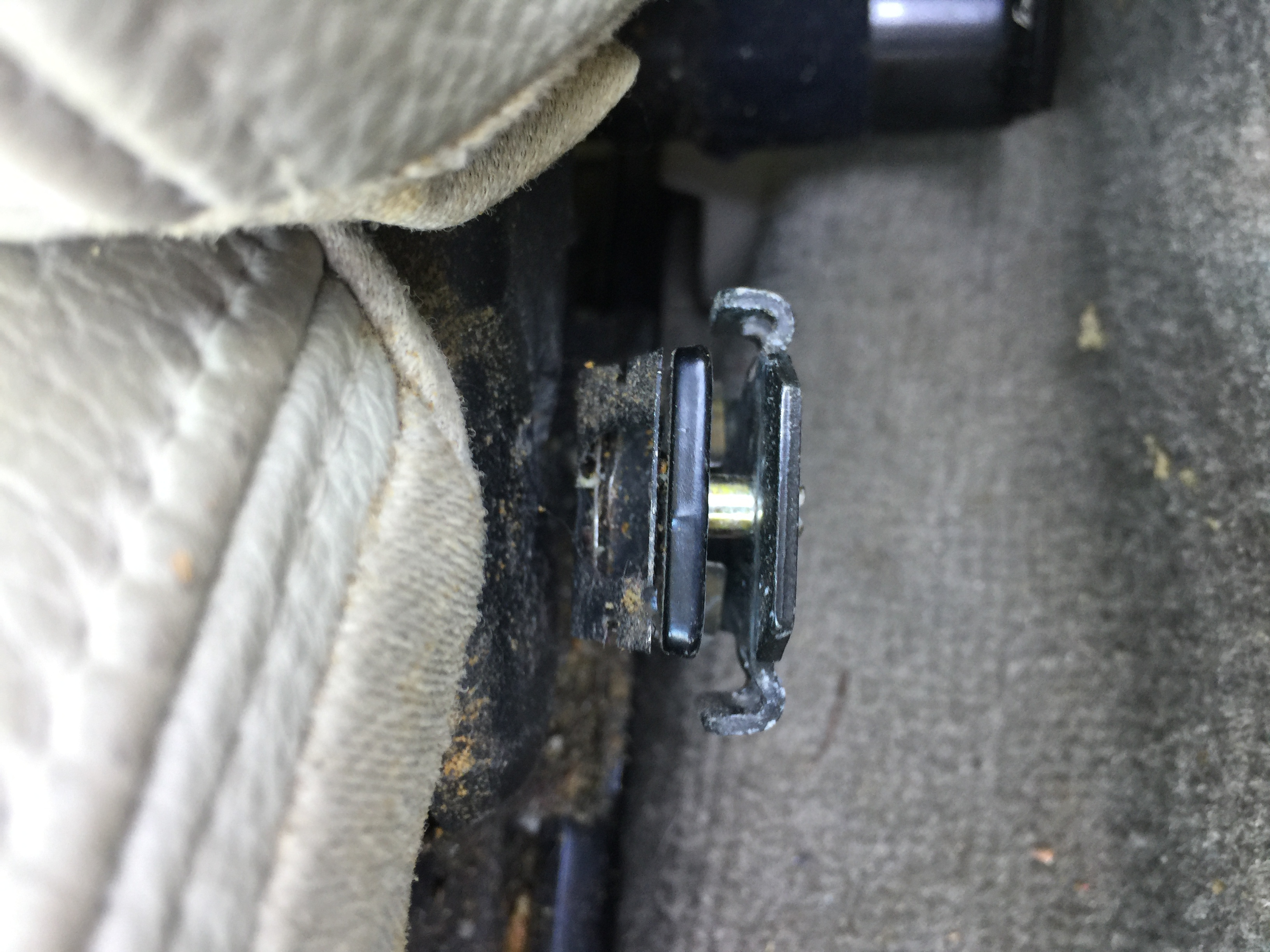

Watch out for this
My Showell clip hung up and didnโt engage the seat belt correctly, make sure the tab picks up the seat belt with a firm tug upwardsd
