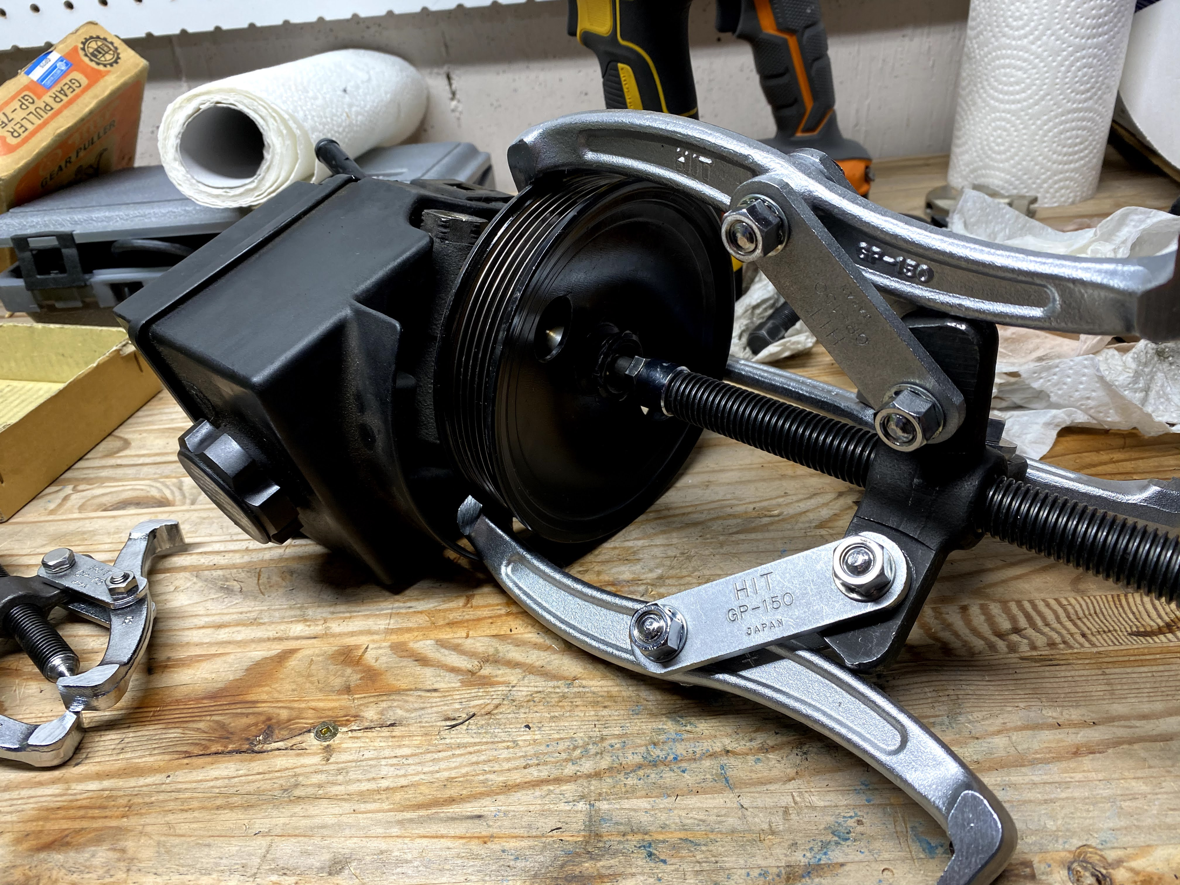

I'm wondering if this tool - https://www.partsource.ca/products/7703 ... -installer will work for removing my power steering pulley. I can rent it at a local store but I won't be able to check it out for another 5 hours until I'm off work. Just wondering if I should start looking elsewhere as I'm trying to get this job done by Thursday for a road trip.
I think it will be fine as long as the threads match up, but it's meant for Ford/GM so it's likely imperial. I'll bring the pump with me to the store to check the threads before renting.
I've seen the Lisle 39000 has been used with success, and it appears to be intended for domestic models as well, so I might be in luck?
https://www.lislecorp.com/specialty-too ... ley-puller
Will this tool work for removing power steering pulley?

I can now confirm that this tool does not work for removing the pulley... The collar for the puller is ever so slightly too large, it slipped and chewed up the lip on the pulley...
