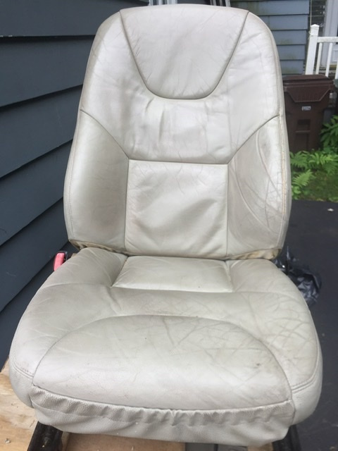

Deskinned the 2005 V70 driver seat , stitched the seam, and reinstalled. Rested with Connolly leather conditioner to get that Rolls Royce smell.
